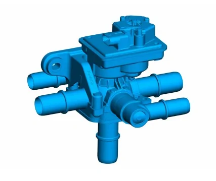

I had to go looking to find the other thread on this diverter valve - seemed that the Heat Pump equiped truck didn't use it.
here
The photos RL XXI posted at #50 indicated no diverter valve.
In the 22-23 trucks there are two valves, I think the 24+ trucks have only one, it's buried down deep near the AC compressor. The heat pump trucks still need to manage coolant flow going to the traction battery through the chiller or the heat exchanger or even the PTC which I think is still on HP trucks but it's only used in extreme cold conditions to boost heating to the battery pack when needed.

I've recently discovered there are 2 diverter valves on the 25. One behind an under shield the other under the frunk tub. Pictured is the one under the shield.
