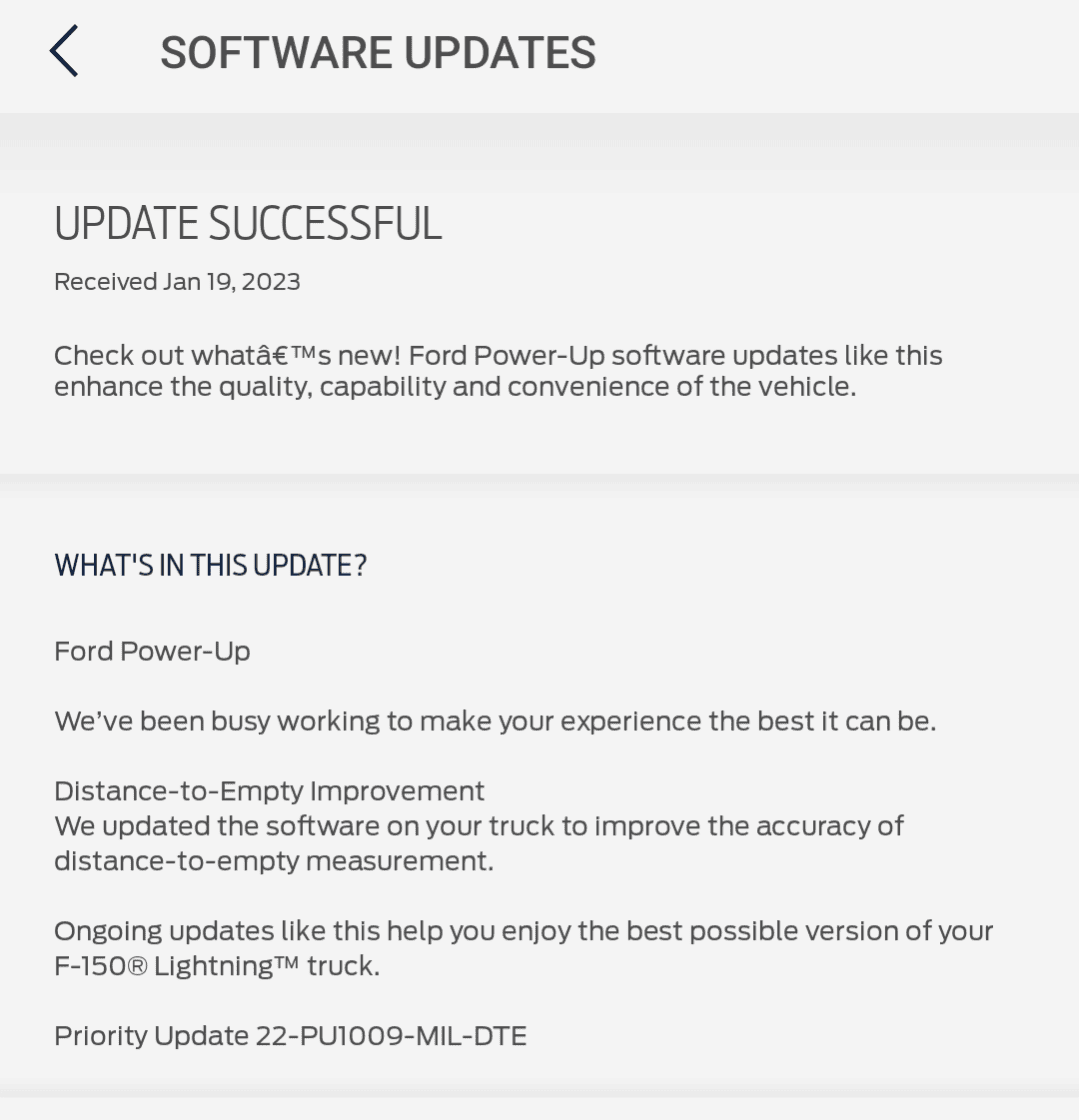

how do i know if my truck received this update, lack of information in the truck has me guessing and waiting for possibly nothing lol
Notification history on your Ford Pass, Account / Message Center / old updates noted there do not reference which update you had, but seeing it concurrent with Ford Pass / Vehicle /Vehicle Status Alerts (where the version will be listed for a few days at most a week).
I would love to see a function on the Sync screen under Updates that takes us to a log file of the trucks actual receipt and posting dates of updates.
