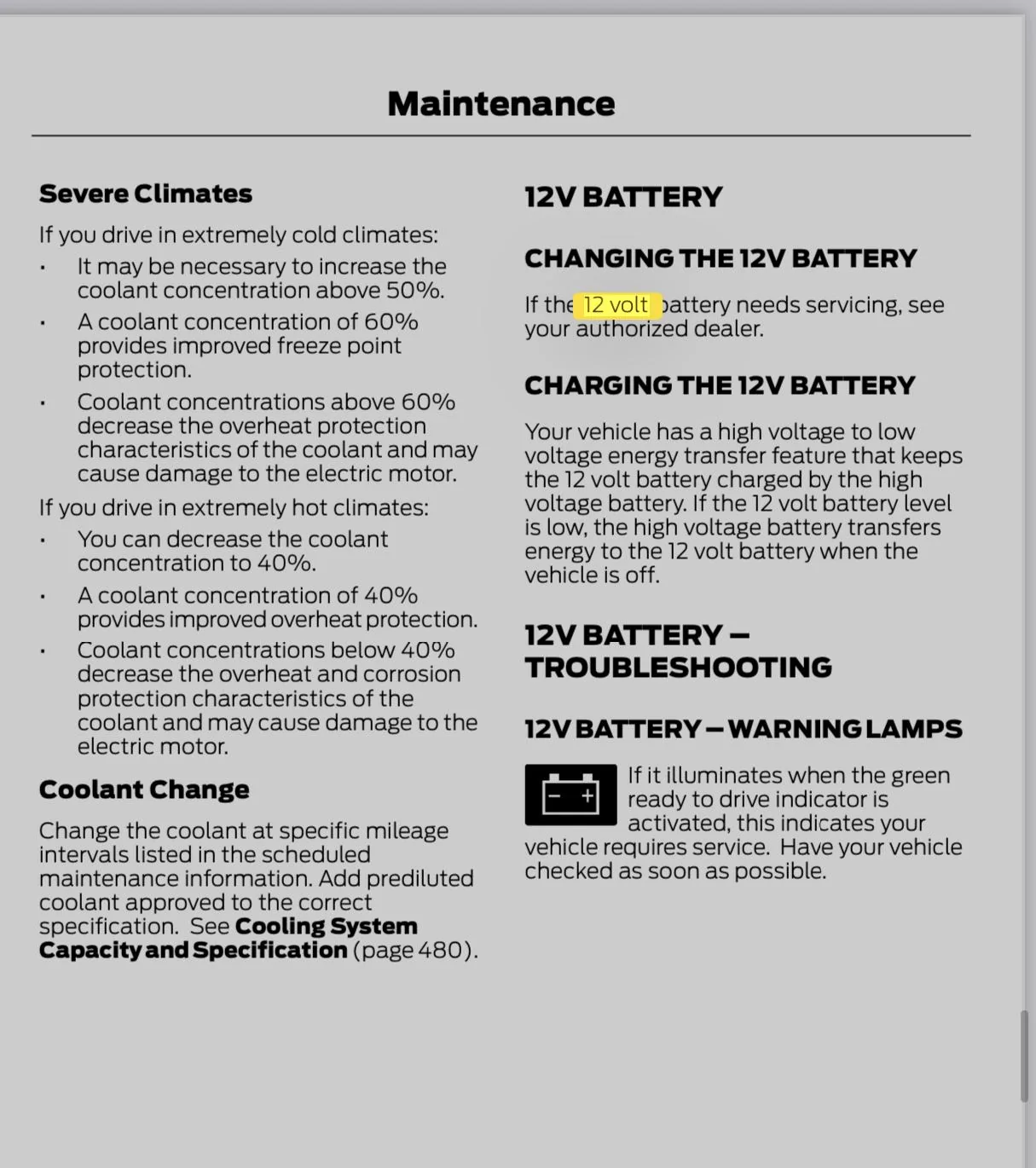

On a different note, if I left the accessory on or for some other reason 12V battery is low and I want to fill it up, is there a downside to disabling the timer and leaving the truck on so HV battery can charge it?
The truck manual says the high voltage battery will charge the 12 volt battery when the truck is off. I’m actually not sure it even charges the 12 volt when running because once the truck is on, the dc to dc converter uses the HVB power to power the 12 volt accessories.
The DC/DC converters capacity is more than sufficient to charge the battery and maintain 12v operations

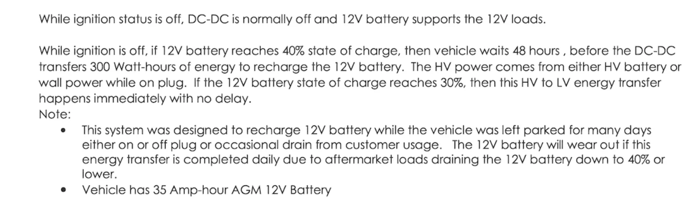

This is even more puzzling now. If 12V battery gets charged when the truck is awake as well as when it is sleep, then people fixing their update problems with charging the 12V battery must be just in their mind and a matter of coincidence. Or max limit of when charging stops does not match the min limit of what some of the updates need. Or parasitic power loss is higher than we thought and charging frequency lower than needed to top off for update to succeed.
has anyone hooked up anything to record when and how often power is flowing into their 12V and at what voltage/SOC it stops?

The 12v battery only gets charged by the HVB when it's very low, and very sparingly. Whereas the update process may require a higher voltage to proceed as a failsafe to not begin to apply an update when the 12v battery might run out very soon. That process is likely all based on the assumption in the code that there is no HVB and DC-DC automatic charging (i.e. ICE vehicle).
