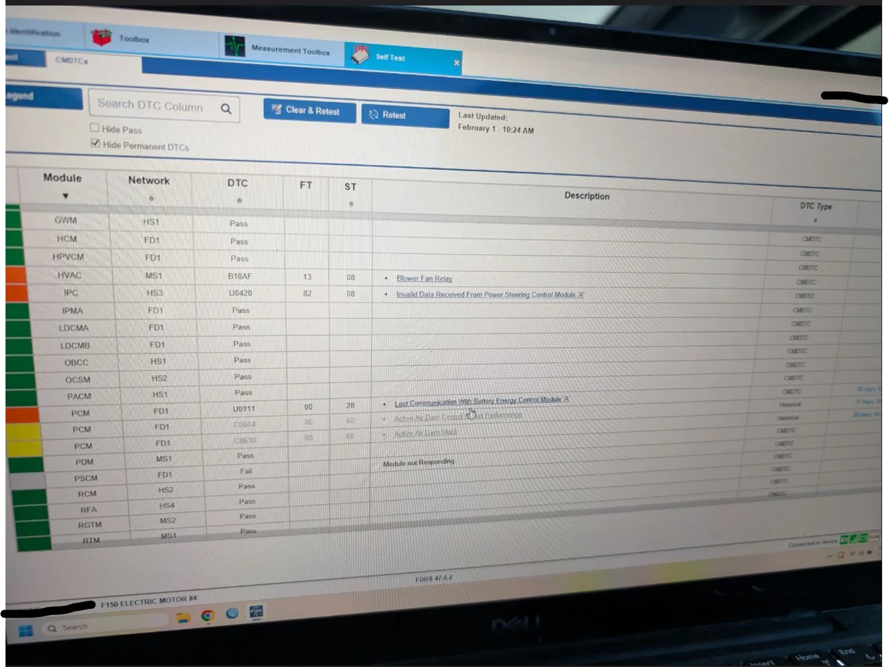

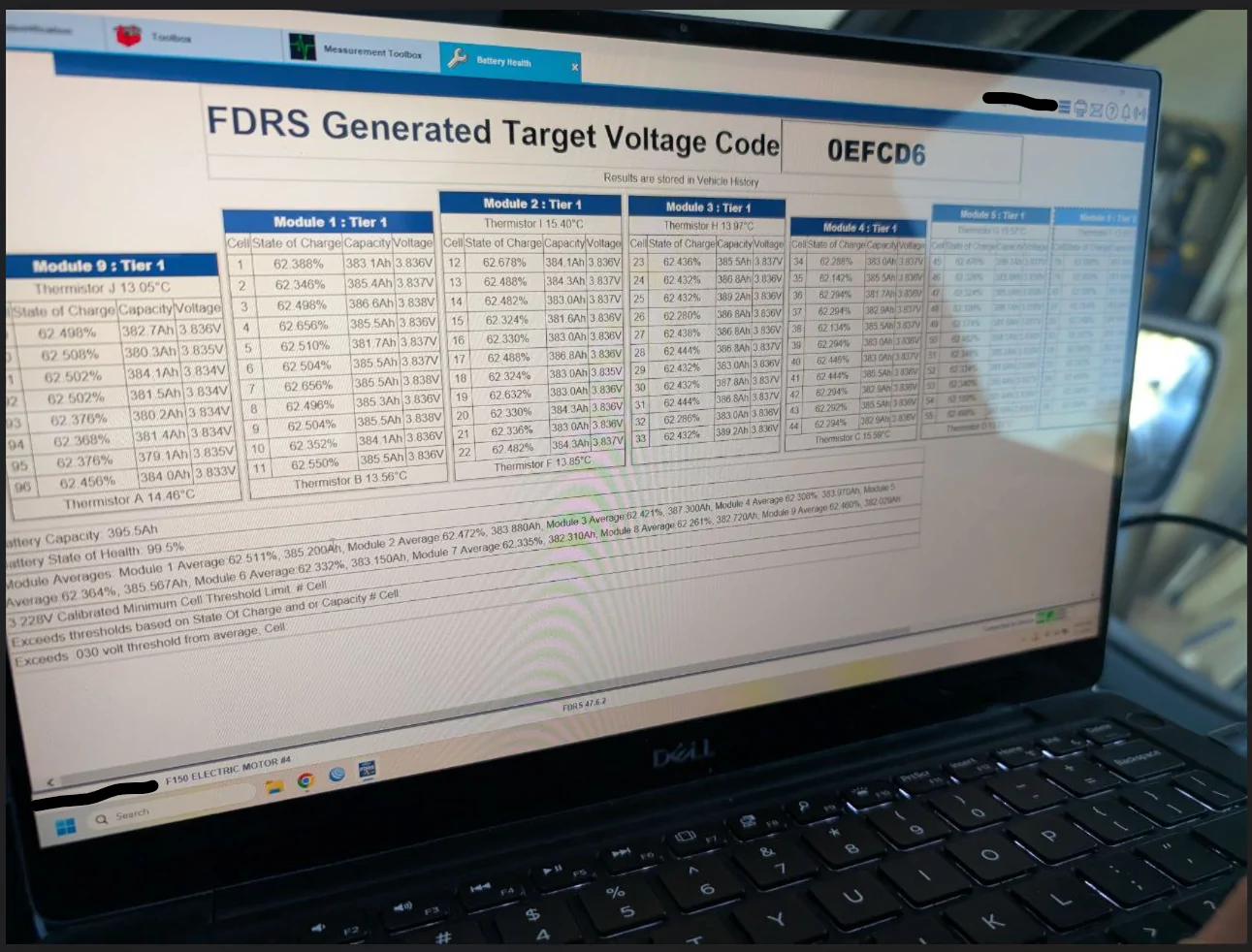

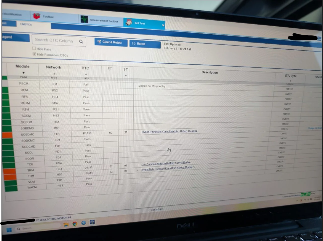

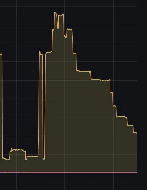

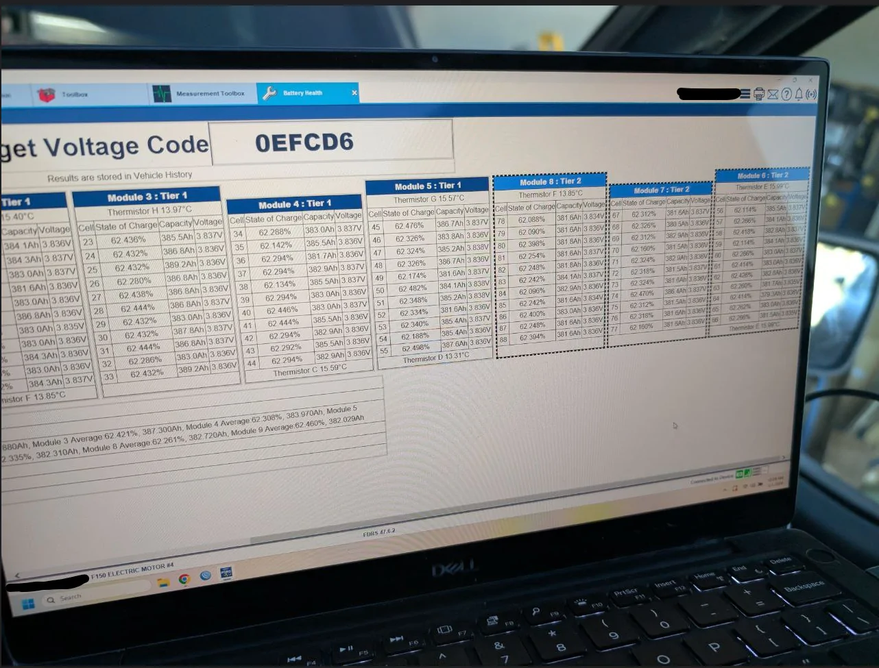

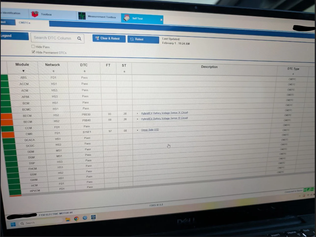

I've been scouring this forum looking for someone reporting this exact issue, but I've come up short so I decided I should post my experience in case others run into this problem. This started a few days ago, so hopefully I'm remembering all of these details correctly. I will preface this with the fact that I'm in Central Florida, and all of this started on the coldest weekend I have ever experienced here (mid 20's, Brr). That said, I do not think the cold prompted this since I know others are in much colder climates. The below timeline is from start to present, and I'll provide more updates as I get them. I have included photos as well of the DTC's that were present when we first hooked FDRS up, as well as the battery test, while the photo of the graph shows the charge rate decreasing steadily.

We tested every module with FDRS and everything came back clean. Ran a battery health check and everything seemed good. Battery health at 99.5% and all cells were balanced. No alerts and no indication that the battery has an issue. However during all of this the "Pull over safely" came up again, and never went away. After we completed all the updates and tests, I reset the 12V battery and the truck was happy again (besides the Low Washer Fluid warning, which was accurate).
At this point, I take the truck for a drive, not far, but just stretching it's legs. Drives fine, no problems. I took it home and put it back on the charger. At this point the battery is at like 60% SOC. The charge rate starts at ~9KW, and over the span of 30 minutes or so, went from 9 -> 7 -> 6 -> 4 -> 3 -> and eventually down to 1.2KW. I leave it to charge over night, not expecting any miracles.

After leaving, the service manager calls me and tells me that he talked to the tech, and that they're still working to recreate the issue. I sent him screen shots of the charge rate on the truck going down from 9KW -> 1KW and I tell him, again, that the issue is already duplicated and is visible right now. That the charge rate is not where it should be. I also offered advice on issues I had heard of, such as a bad thermistor making the truck thing the charger is getting hot and reducing power to avoid an issue. He tells me that he will get with all the team members involved in the morning and review.

Pretty confused cause your screenshot show the BECM codes that are causing your issue.
Those codes were present when first opened FDRS. Cleared the codes and they did not come back. All modules tested and passed.
