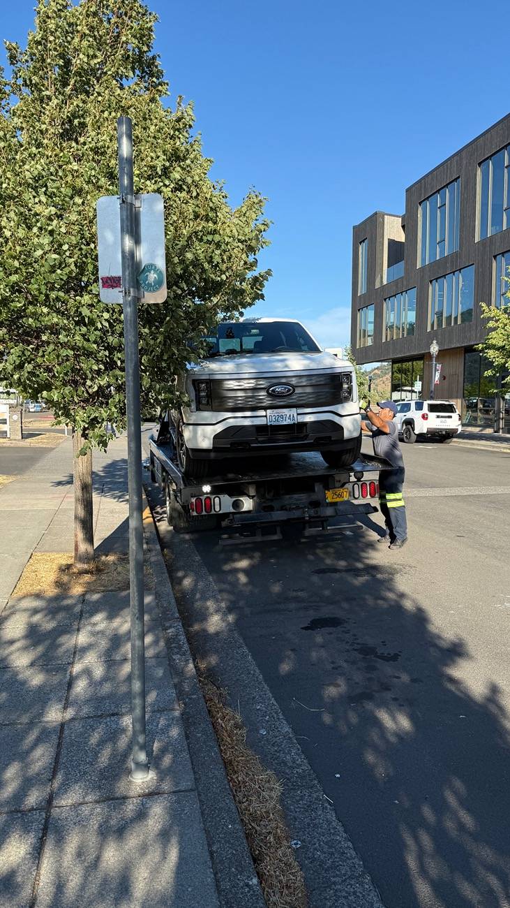

Mine just did the same thing, pull over safely but I wasn’t charging, had just parked it to go have dinner at a restaurant.
I had just gone thru the same issue three weeks earlier and was without my truck for two weeks. In that time the recall parts (which my truck was part of) came in and they replaced two modules. Less than a week after getting it back “fixed” it seems to have blown the main fuse again. Awaiting dealers diagnosis…

No. The 12v powered stuff came on fine. Was able to put in emergency tow mode and get towed to…..wait for it…. A shopping center lot because the towns 4th of July parade was blocking the entrance to the dealer…
Oh man. You and I have the same kind of luck.
