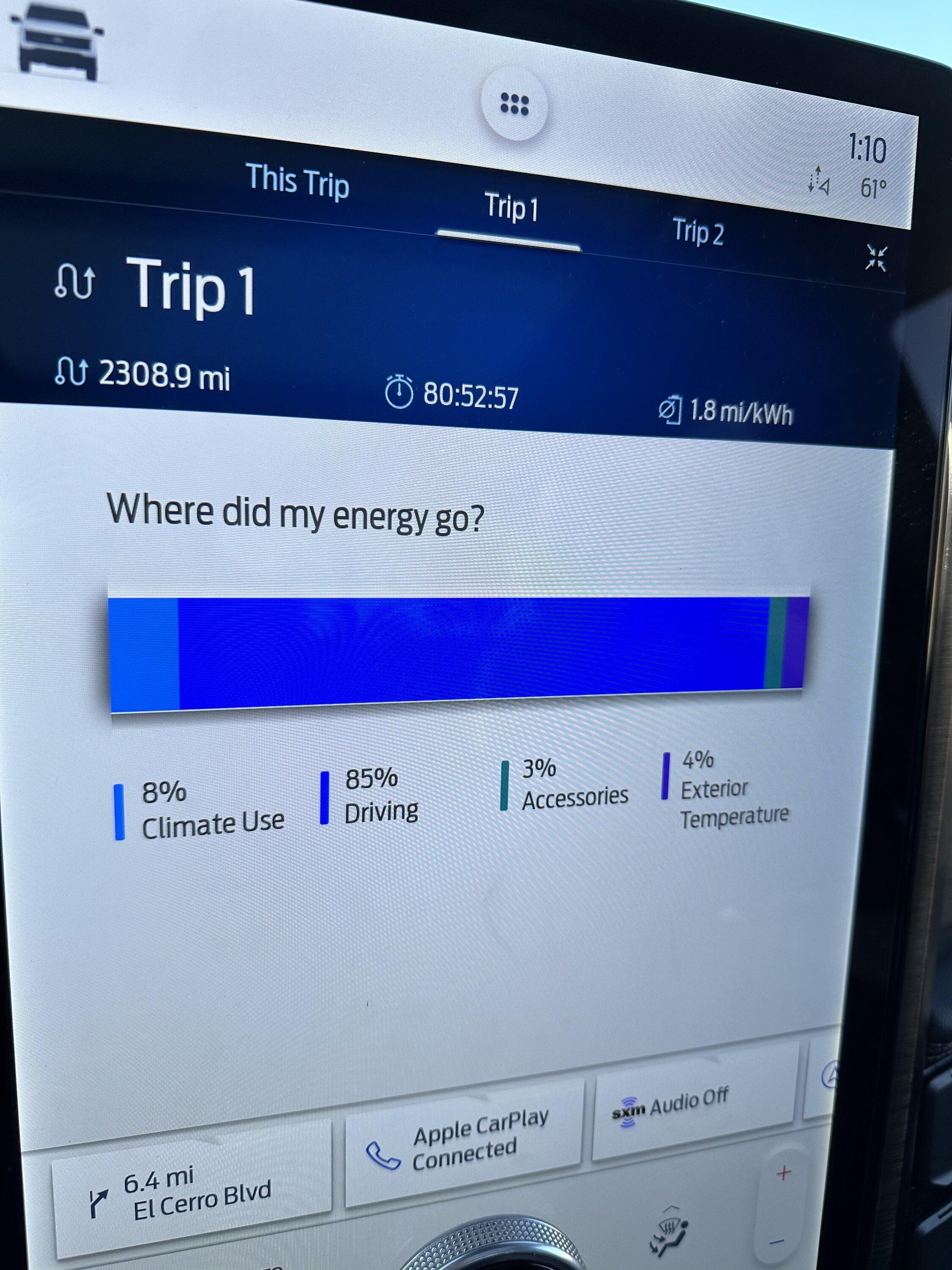

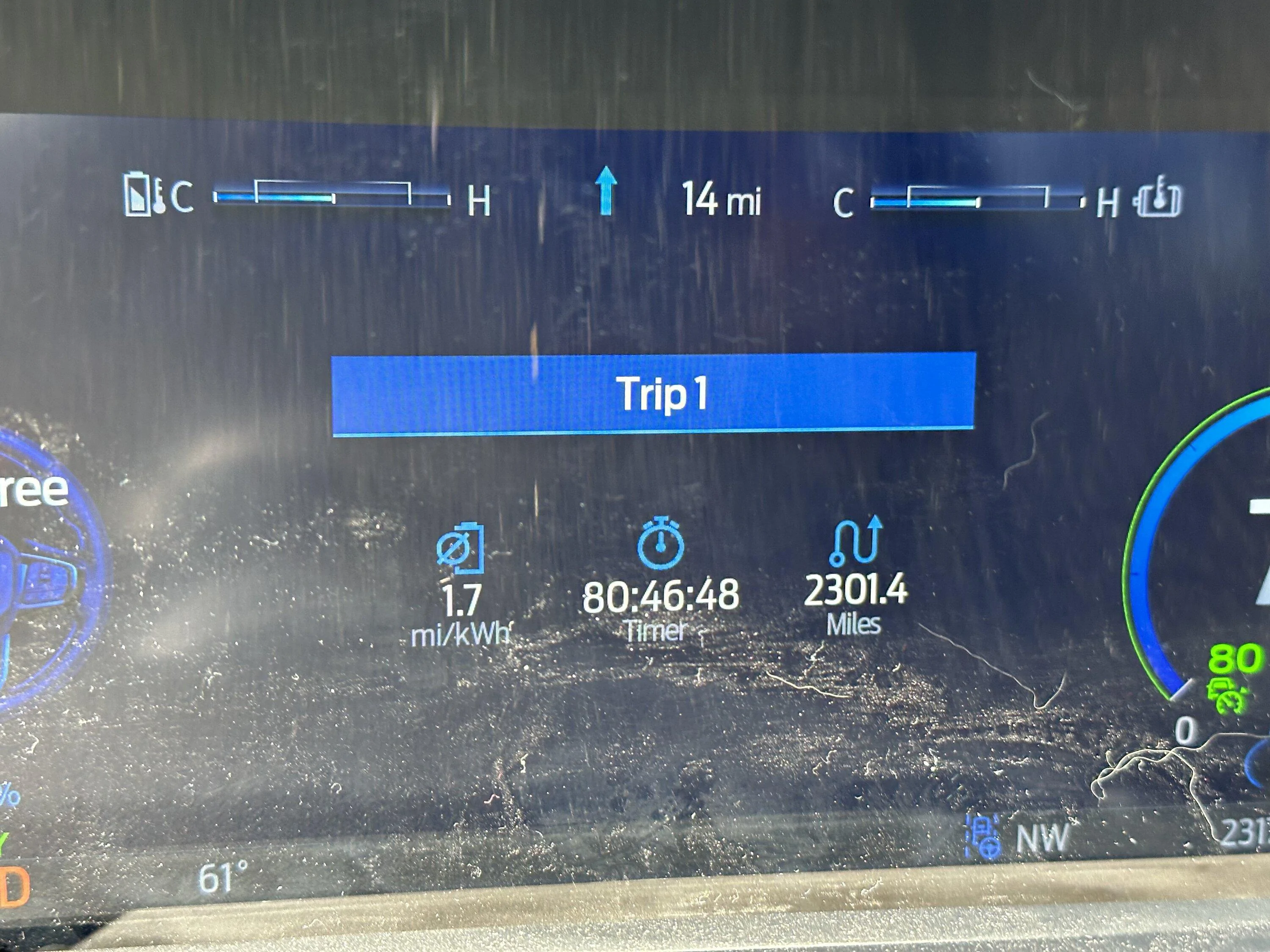

Ok. Phoning some friends here.
I have had my Lariat ER for 2 months and 2300 miles. I live in California where the temp has been 35 to 70 degrees out. I have the all terrain tire swap instead of all season. For about 400 of the miles I have had a lightweight paragon tonneau cover. I am not carryobg
I have been AVERAGING 1.7kwh per mile. When driving long distances down the 101 at 70 or 80mph I have been getting 1.4 to 1.5. I have tried pre heating and even turning the HVAC off. What is odd is that sometimes I will do highway driving 40 miles and get 2.0 kWh. Off highway I get a great 2.8+.
1.5 doesn’t even get me 200 miles of range at full charge (not including battery degradation over time).
anyone else seeing such horrible range? Any advice?
I have had 2 different Tesla X and have never seen this wide variation.

You're driving a brick, not a sedan.
You will see a range hit as the temps drop, noticeably around 50 degrees, more around 30, a lot around 20 or below.
If you drive 65 on the highway and note the miles per kilowatt hour you're getting, that will give you good info. Reset, and drive a mile and note the readout. Accelerate to 70, reset and drive a mile and note. Then 75, then 80. You'll see an enormous impact with the higer speeds.
You should also note that the This Trip, Trip 1, and Trip 2 MAY report inaccurate information at times, so make sure you're verifying the miles you drove. Sometimes the miles don't reset, but the energy does, so it's way out of wack.

Your efficiency numbers don't seem of concern to me. I drive slower, but in a colder climate, and my drives have most consistently been 1.3 or 1.4 in the dead of winter. I think the cold is worse on range than top speed, but I say this unscientifically.

IMO, your Tesla's weren't shaped like a brick and didn't have AT tires, and that is the difference on your highway mileage. Everything is a factor. Speed, temperature, elevation changes and wind.
