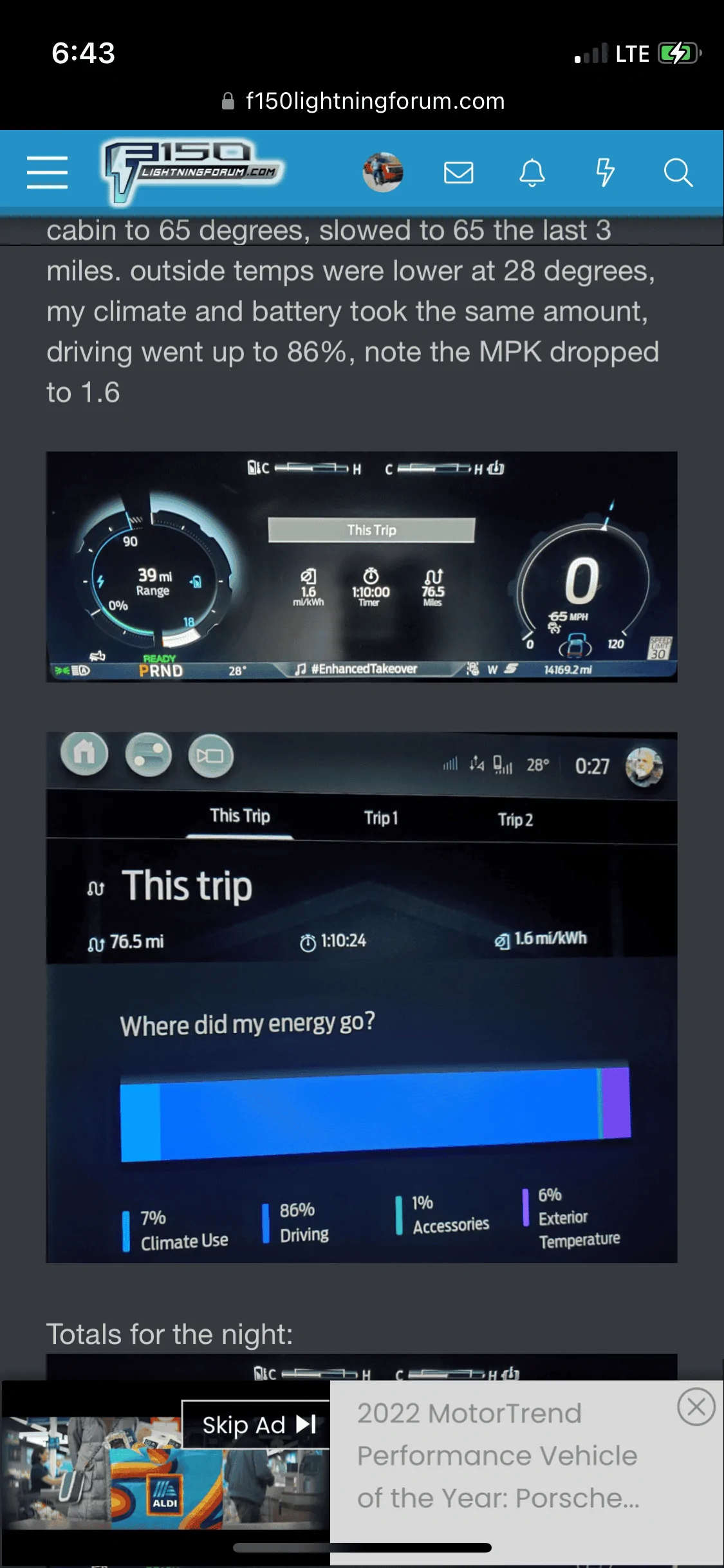

Based on the image in your original post, your guesstimated range is 192 miles. If it is cold weather and you leave some of your charging for right before departure, that heats up the battery and you can get more juice out of it.
