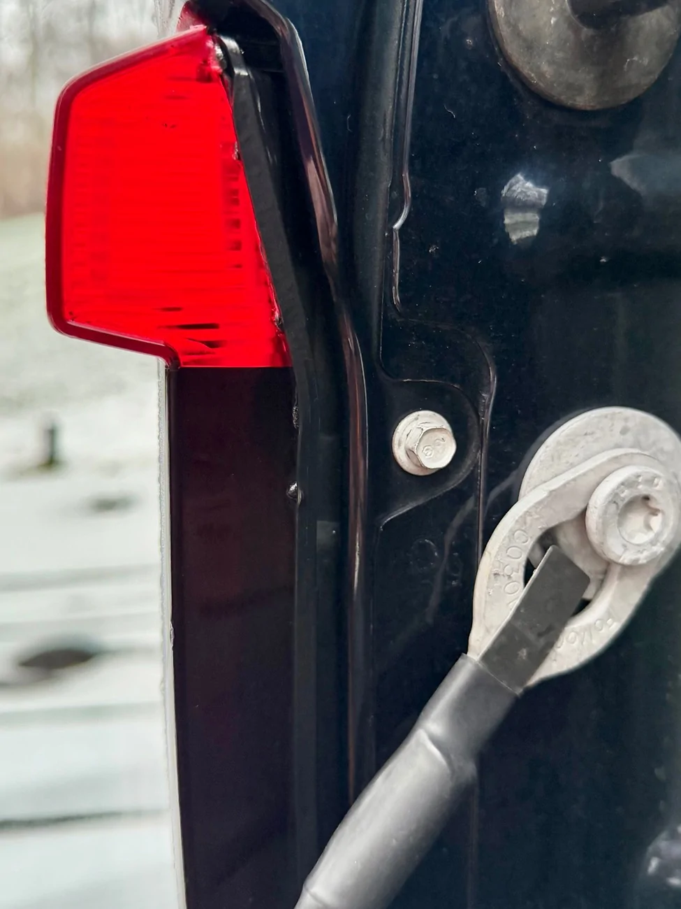

I am another victim of this atrocity… Trying to figure out which avenue to go. Looks like just the lens is available for ~$1500 on Ford parts for the lower tier Lightnings. Here is my crack. It also extends around the light housing. It was not my doing, there are no impact marks anywhere and of course Ford wouldn’t cover this under warranty… There is visible moisture inside the tail light but it’s not puddling or anything yet.

Yeah, this has been a tough one for me to deal with. It’s the only issue I’ve had with this truck since new. I love this Lightning dearly, which is why I will likely just buy a new lens and make it whole (self-install) before I lose the radar sensor too. Ebay doesn’t have anything right now with the left side low tail light.
There are no blunt force marks or anything to indicate it was my fault. Fords statement was simply, “we don’t cover scratches or cracks”.
It just gives me a serious bad taste in my mouth for Ford and I will not likely return as a buyer in the future over it.

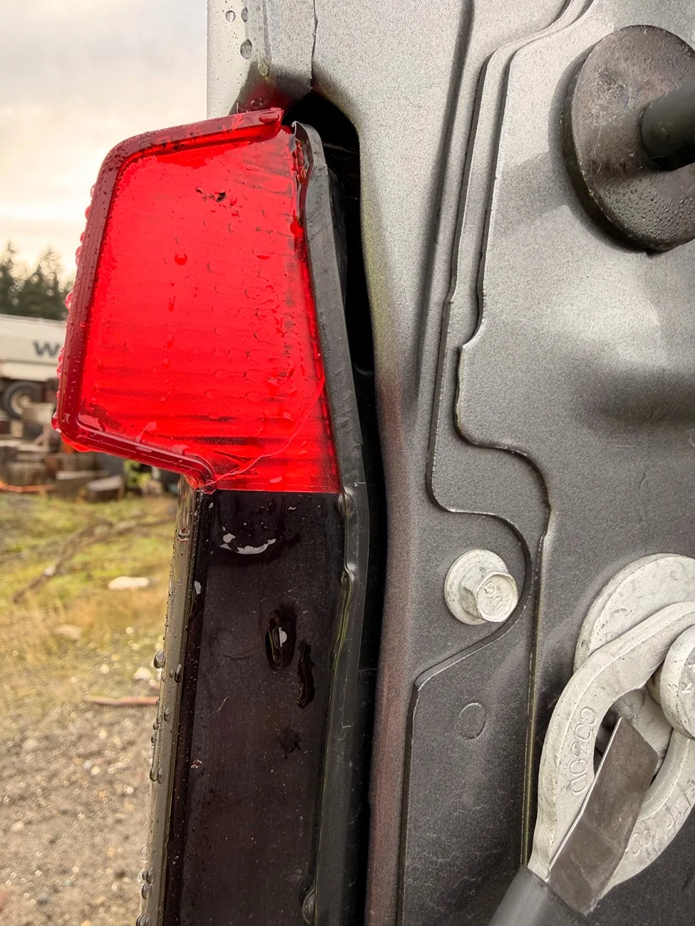

Maybe it’s just the pic, but the black paint below the red lens in first picture seems chipped like it had some type of impact. Took a picture of mine just now for comparison. Maybe it’s just water drops catching the light

Yeah those weren’t the best pics. I took them this morning when it was covered in dew. My dealer cleaned them up a few weeks ago when they sent the pics to Ford. The dealer even indicated they observe no exterior trauma to the lamp.
