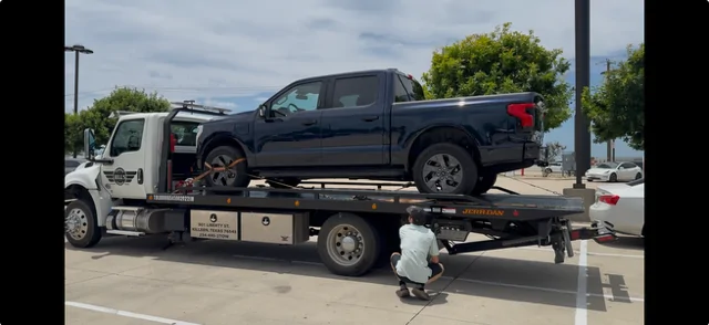

Last weekend, while driving my 2024 Flash from Dallas to Austin, I got the dreaded red ring while trying to DC fast charge at the Buc-ee’s in Temple, TX.
Before leaving Saturday around midday, I wasn’t able to fully charge to 100% because I was busy running around that morning but had about 85% when I departed from home in Austin. We got on the road and eventually stopped in Waco, where I DC fast charged at a Mercedes-Benz charger. After that, I made it to Dallas, spent the night, and got back on the road first thing Sunday morning to head home.
I stopped at an EVgo charger at a Target in Dallas with the plan to unplug once I had about a 50-mile buffer over what I needed to reach the Buc-ee’s in Temple. And that worked with no issue. As we were approaching Temple, I noticed I was cutting it much closer than expected. I had been going 80–85 mph the whole time, and the temperature was rising, but it still felt a little unusual. I moved to the right lane and slowed to 65 mph for the final stretch.
By the time I pulled in, I was at 3% battery. I plugged into one of the Mercedes-Benz chargers and got a solid red ring. I tried another charger—same result. Then I tried a Tesla charger, still the red ring. I let the truck sit for a bit and tried again: no luck. In total, I probably tried six different units over about 45 minutes, which was supposed to be a quick 20-minute stop.
Luckily, it was just my wife and me—my mom was taking care of the kids back home for the trip. I tried calling the Ford EV helpline, but it was closed since it was Sunday. Eventually, we decided she would Uber home, and I called AAA for a tow. It ended up being a 75-mile tow on a flatbed. The good news is I was able to drive it up onto the flatbed myself, so no concerns about damage pulling a nearly 7,000-pound truck up.
I finally got home after what turned into a pretty interesting road trip with the tow truck driver who used to ride bulls. I plugged into my Ford Charge Station Pro, and it started charging immediately. A few days later, I tried a Tesla DC charger again, and it worked with no issues.
So what should I chalk this up to? Should I avoid letting the battery drop below 10% on road trips? I’ve taken several trips between the major cities in Texas and never had this happen before—but I’ve also never let the battery get that low. Did I do anything else wrong? I just don’t want to feel hesitant about taking this truck on longer trips again.
