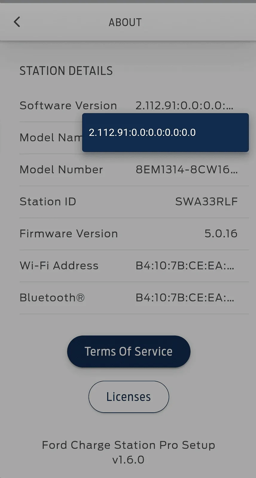

Your and several other members ~recent~ experiences concern me, my FCSP has been stuck at an incomplete firmware/software update for many months, I've considered doing a remote factory reset while I currently do have connectivity, thinking that would help force the update to finalize.
Reading what you folks are going through gives me pause to leave well enough alone, it's communicating with my network, it charges, it logs data to the Ford cloud, other than fixing the version number I have little to gain, aside from possibly getting a newer software version if/when that comes out.

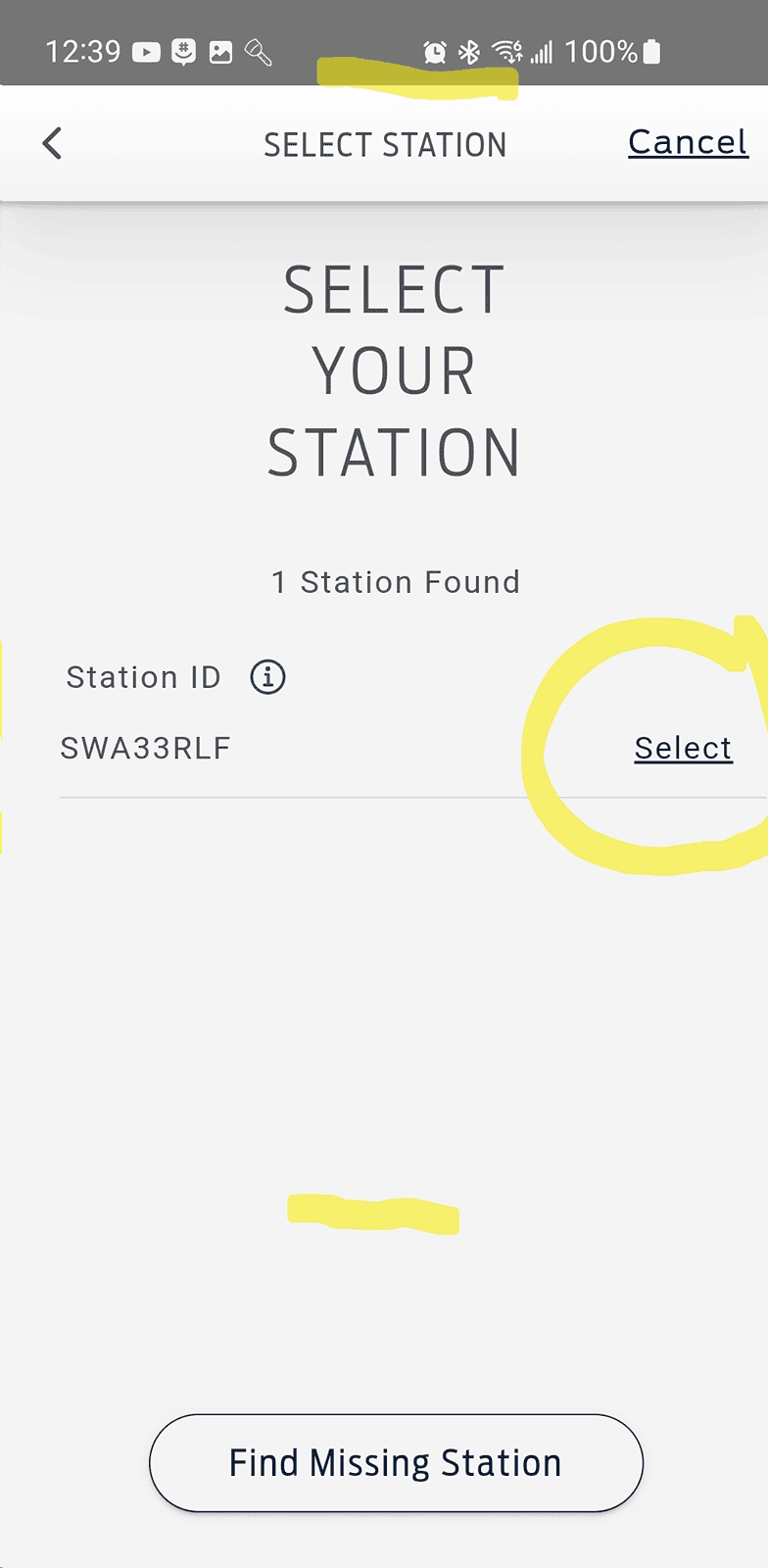

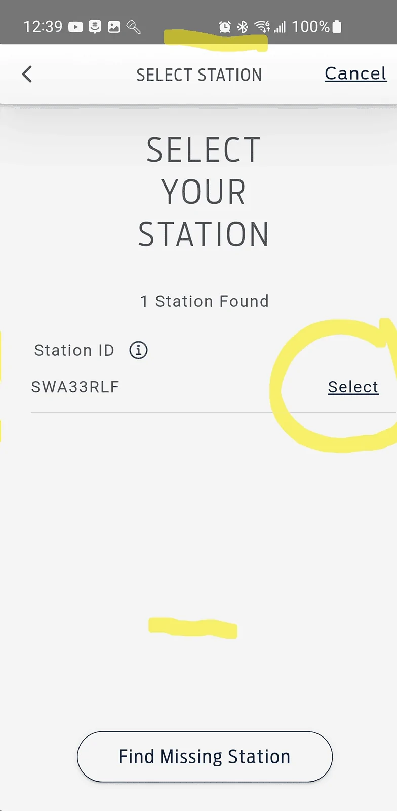

This is the best guidance I've been able to find on resetting the FCSP. It's relayed guidance from the OEM: Siemens.
Hi Mekuhl, thank you very much for the guidance. I saw the post before but unfortunately, it's not working. The station is not showing up under WiFi networks and the Factory Reset is not working as well.
216
15,884
17,807
Take note of the warning in the other guidance, the FCSP doesn't broadcast its SSID once configured, the only way to see it is using the FCSP configuration application, assuming it's actually broadcasting.
The mobile device must also be connected to the same network!!!
If you're not seeing it, then yours is likely broken.
I was able to manually type in the SSID and password when mine stopped showing up. That might be another option?

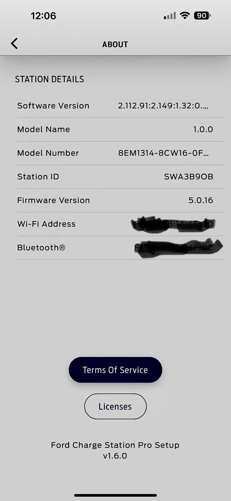

I read somewhere that power cycling and not plugging it in to the truck at night would get it to update the software. I just installed mine last week and after two days I did that and mine updated.
Yes, that is the correct procedure, trust me, I've done it many times, and it still won't display the full version code, luckily, your screen shot confirms my ~prior~ version was indeed the same value, before it mysteriously flagged a new update which has never posted correctly.
I'm guessing that update was pulled quickly from distribution, now we all wait for the next version if they plan to issue any in the future.
