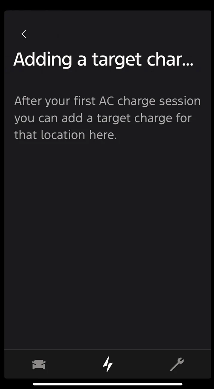

Back early December my 12volt Auxiliary battery failed and went dead flat on my 2023 Ford Lightning Lariat,I replaced it with a genuine ford replacement, I now have no access on the app or on the vehicle screen to set charging limits , I have deleted all locations and am now unable to add any new locations , the only other thing I have noticed is the vehicle location on the app shows 24 days ago as if it’s lost its location somehow, I can still use the app to lock unlock and set climate etc so the vehicle is receiving app requests and that all works, it’s just it will only charge to 100%, any help or advice will be greatly appreciated

You cannot add a location until you charge there, if only for a minute or two.

Rather than building the new charging scheme with Ford App, try doing it in the truck via the Sync screen.

Hi, I have tried that but it doesn’t recognise it has been charged
yes I have tried that but it won’t let you add a new location to set limits

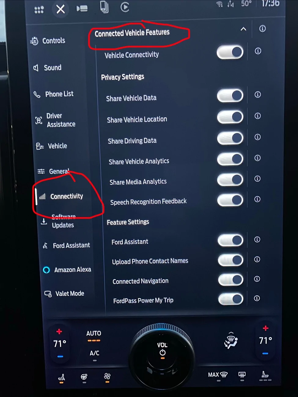

Could the location in the vehicle sync screen have turned off when I changed the 12v battery?
Yes this is possible, go into the settings and disable connected features, then reenable all of them to start with, then dial back any that your sensitive to disclosure, note that some need to be on!!!
I will try this tomorrow and report back 👍

Are the toggles on the actual sync screen under settings ?
If you mean the vehicle data toggles @TaxmanHog referred to, then yes. I'm not sure if the 2022 locations are different but in the upper left there is an icon that looks like a vehicle 🚘 , tap it, in there look for the data consents. Toggle them off, then back on.
Edit: If you are referring to the WAL toggles, they were also in there but in a different section.

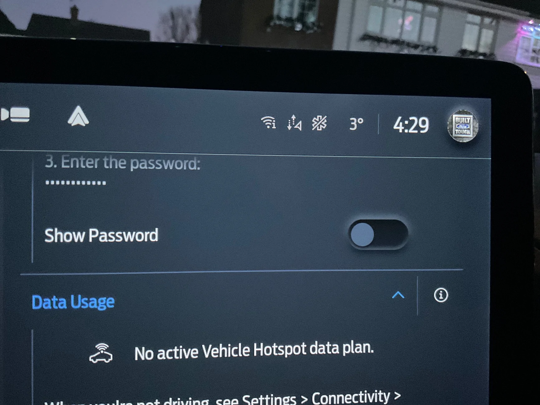

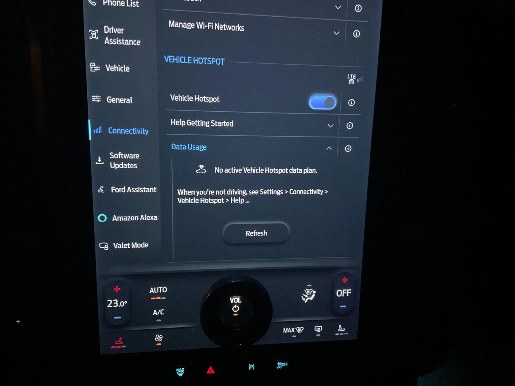

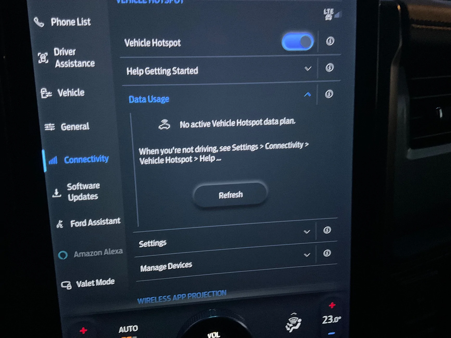

Hello, I have tried all the connection toggles , turned all off and all on not sure where the WAL settings are, I have taken some pictures today of my screen just in case something is obvious to someone to advise.
Alexa also isn’t working either , I have connected the truck to my home wifi but this isn’t making any difference either .
thanks
