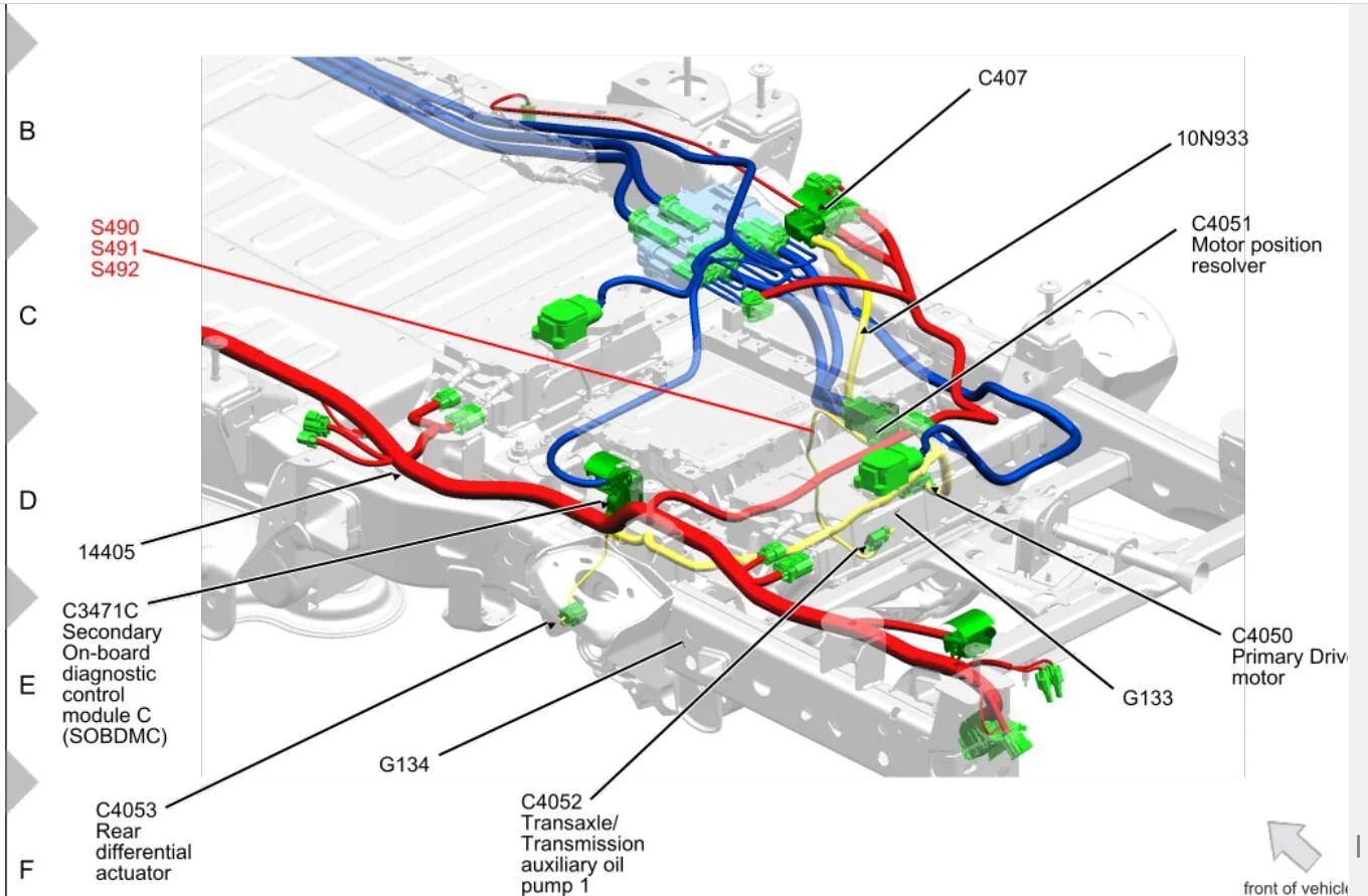

If anyone has a full parts schematic, can you pull a part number for this harness? Dealer said it was a few feet long and went from the rear motor to main wiring harness, so I take it there is a connector on each end.
Given that both trucks had the same problem on different wires, I may order a replacement cable to have on hand. Thanks
I might be able to find it, but the best bet is wait for them to finish the warranty work, the p/n will be listed in the work order, then order a backup if it's a simple PnP situation. Also the PN in my reference might be outdated.

Thanks. They repaired the existing wire and do not plan to replace the harness.

Get under there and look for the repaired wire, it's a rats nest of cabling, hard to say which is the item you're in need of.

BTW, my reference document does not have the component part numbers, maybe the dealership parts department can help.

Wow, I guess so! Thanks for forwarding diagram.
