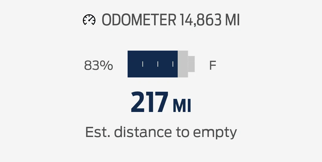

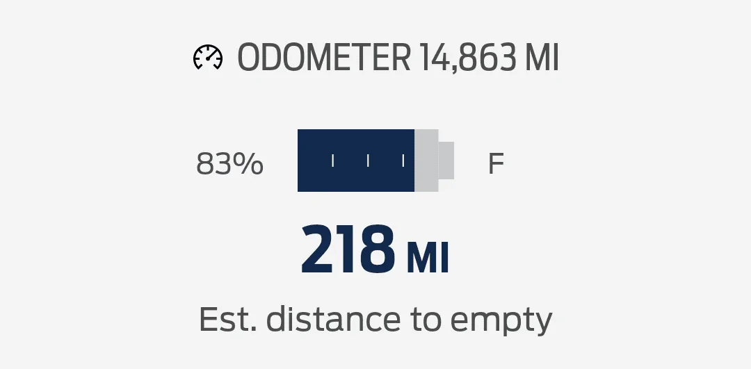

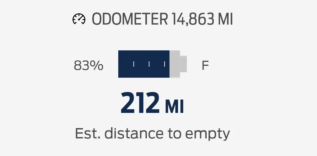

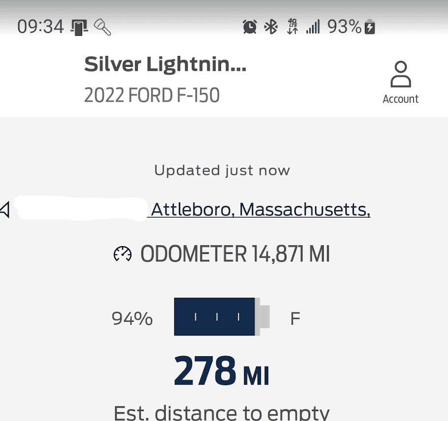

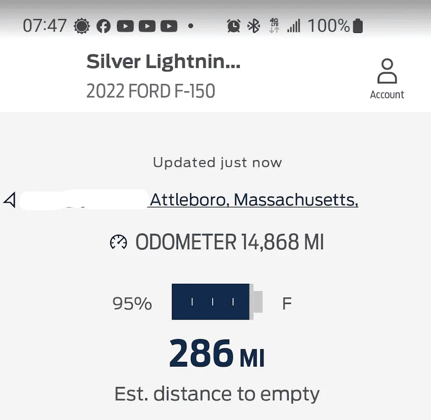

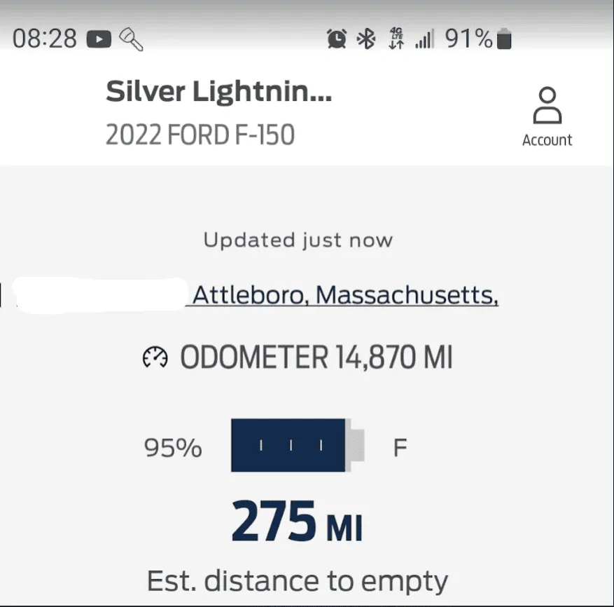

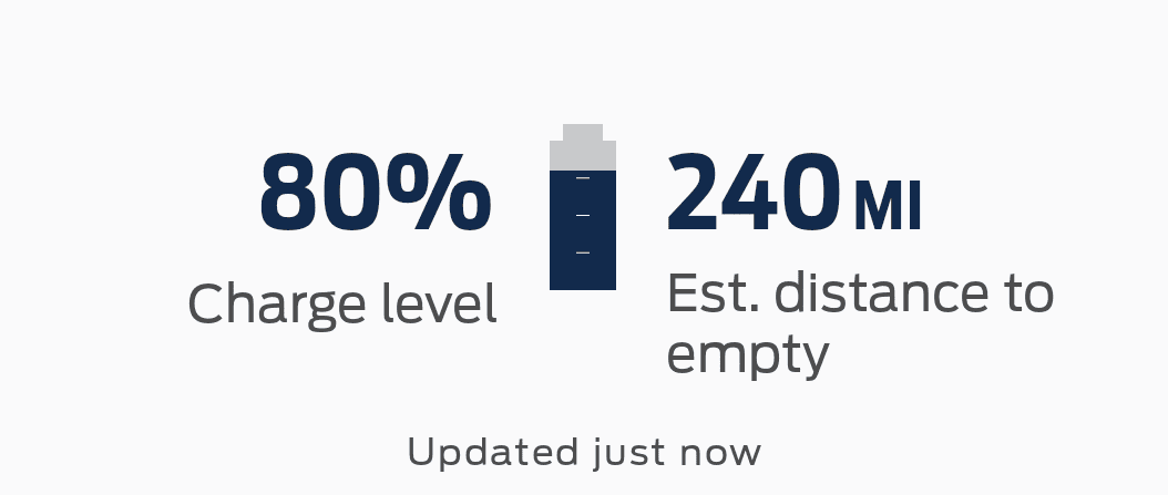

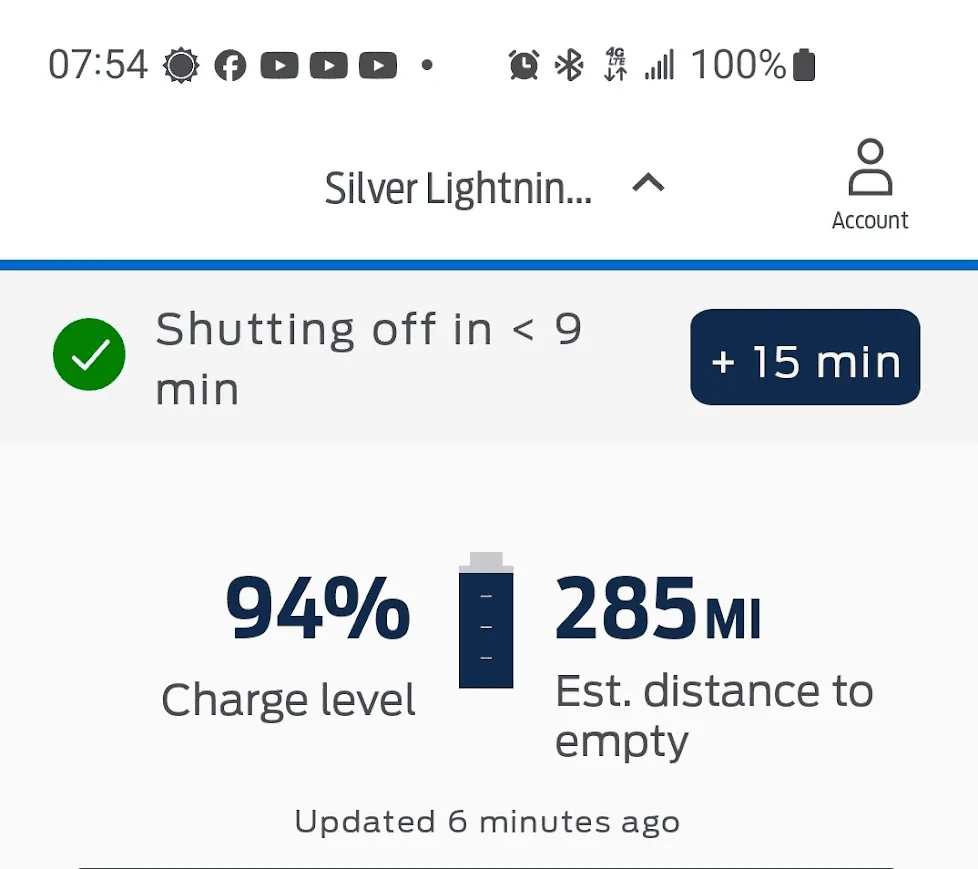

Similar experience, for the same reason I charged up to 95% as a precaution for emergency power needs should a storm related problem arise, I unplugged the truck after reaching my goal last evening. Temps were mild all night into Wednesday morning.
Ford F-150 Lightning SOC Percentage Fluctuation 1704897454367
This morning just before I clicked remote start while unplugged, then several minutes later.
Ford F-150 Lightning SOC Percentage Fluctuation 1704897641878
Ford F-150 Lightning SOC Percentage Fluctuation 1704897685080
A short trip to breakfast place with heat on 72 degrees in the cabin, warm wheel & seats
And then the return trip home, granted this is a very short excursion, but the SOC is hardly impacted by the drive and cabin heating demands, though the range adjusted for the energy consumption though at a greater rate than the actual mile(s) driven.

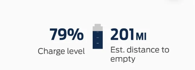

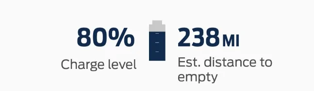

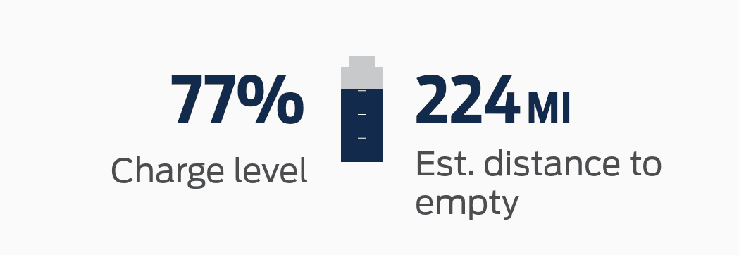

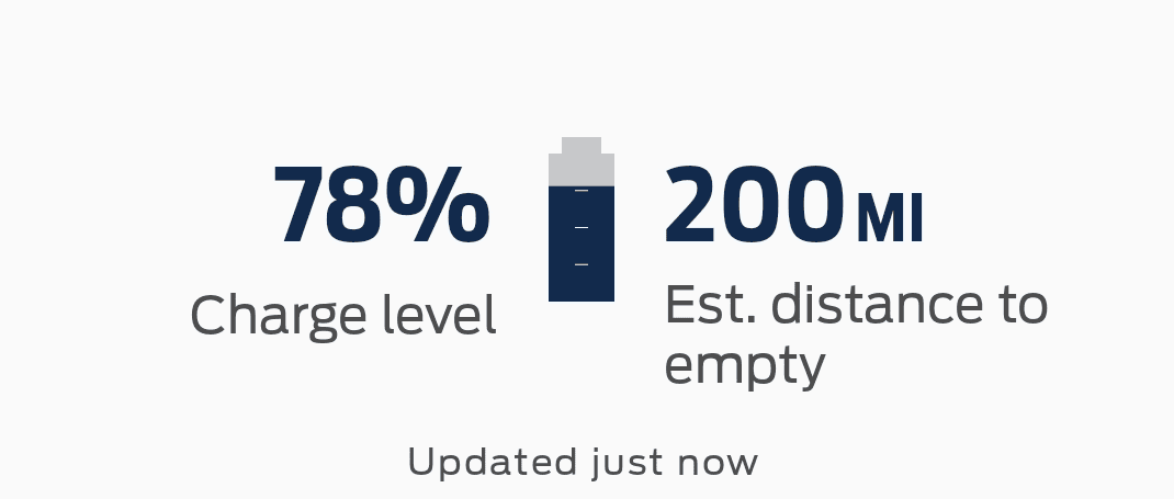

I think the issue is with Fordpass, while I'm plugged in waiting to charge or in the middle of charging I've seen the values swing by a few % and several miles of range when doing an APP refresh to check on truck status.
1/9 @11:30-----------------------------1/9 @12:46--------------------------1/9 @12:47

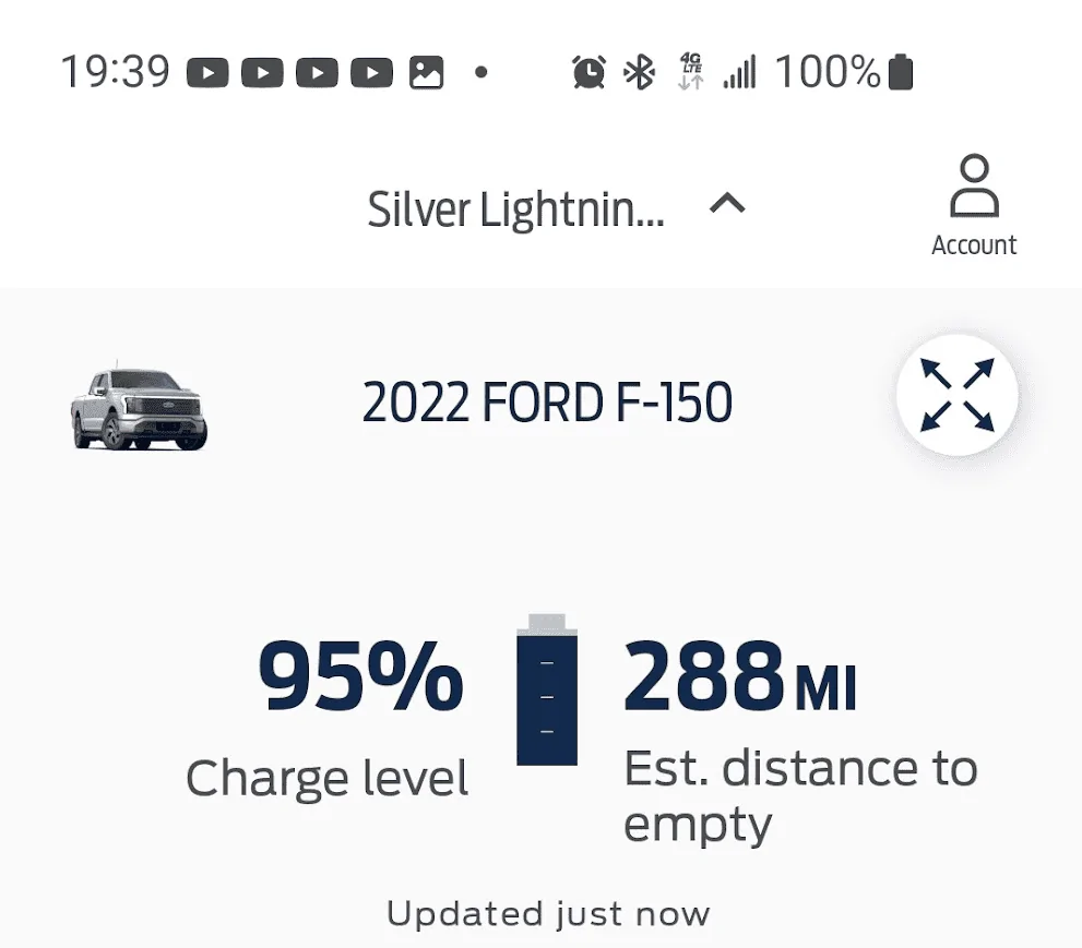

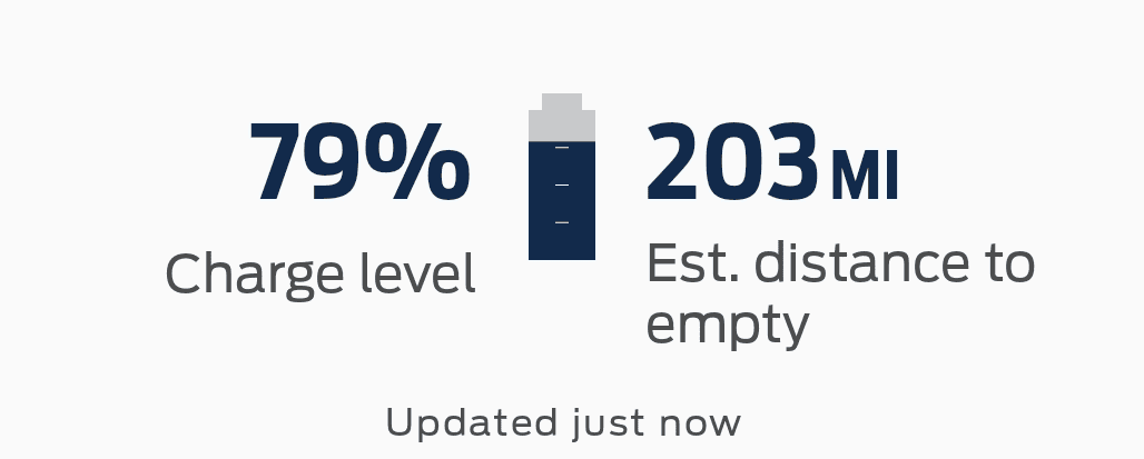

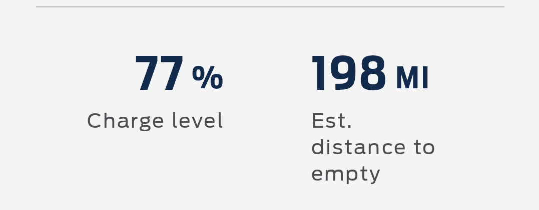

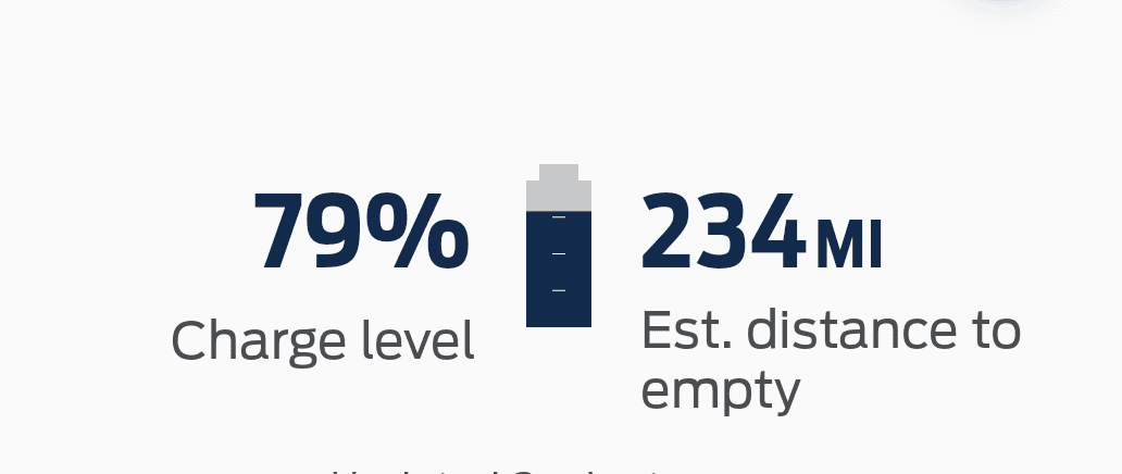

Figured I will add this additional point to the conversation about linearity of the GOM-DET.
We've mentioned the phenomena in various threads about how optimistic the reading is when you hit 80%, figured I would reiterate it with evidence.
After yesterday's' road trip of 148 miles round trip, I held off charging until this morning/early afternoon between trips to church, coffee and early dinner. It took about 4 hours 50 minutes to charge from 20% to 80%, if I waited for 85% I would have one hangry woman on my hands.
Note the range prediction before and at 80%
Ford F-150 Lightning SOC Percentage Fluctuation 1706473341084
Ford F-150 Lightning SOC Percentage Fluctuation 1706473354326
Ford F-150 Lightning SOC Percentage Fluctuation 1706473377573
37 magic miles
Ford F-150 Lightning SOC Percentage Fluctuation 1706473395808
Remote start for 15 minutes to warm up on the plug.
Drove to dinner 2.5 miles @ 30-40 MPH, lost 6 on the GOM
Ford F-150 Lightning SOC Percentage Fluctuation 1706473465488
Stand alone remote start, then drove home, return trip is 3.3 miles
Ford F-150 Lightning SOC Percentage Fluctuation 1706473735136
