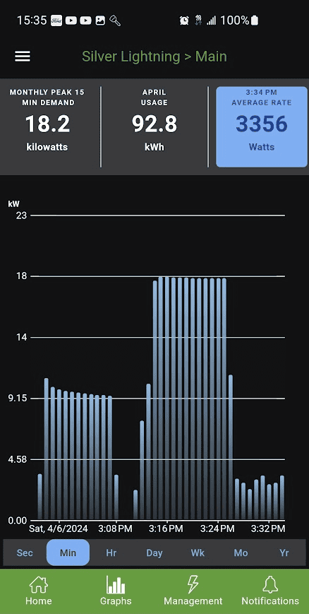

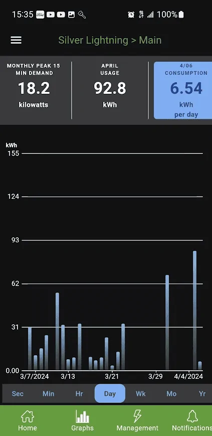

Plugged in departure timer used this afternoon for testing purposes, the seat and steering wheel were toasty warm.
Note, typically 1.5 KWH is dedicated to cabin/seat/wheel warming for a 15 minute period, the balance of 5 KWH was for battery warming and a token 1% bump in charge [90% to 91%] Battery warming started at 14:56, unplugged at 15:35
