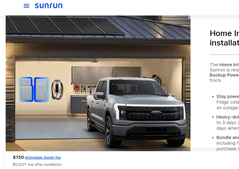

BzzzzztZapPow
Aug 7, 2021
143
196
21 Explorer Hybrid, 18 Fusion Hybrid, 22 Lightning
Well, now I know. Visited the Sun Run order site and the cost for installation of the charger is $1500 ($150 design fee); $7700 for the HIS....$9200 total, with the asterisk for potential extra costs. shop.sunrun.com/ford/order/
We just don't lose power enough to justify the cost for our home. Bummer.
Ford F-150 Lightning SunRun Price for Charger and Home Integration System Installation Sun Run Order
My brother is an electrician. He's going to install a manual interlock and power inlet at my house. For the 1-2 times/year I need it, I'll connect a 30A RV extension cord from the house's inlet to the 240v outlet in the truck bed then flip the interlock. For most homes, the equipment and install should cost less than $1,000.
