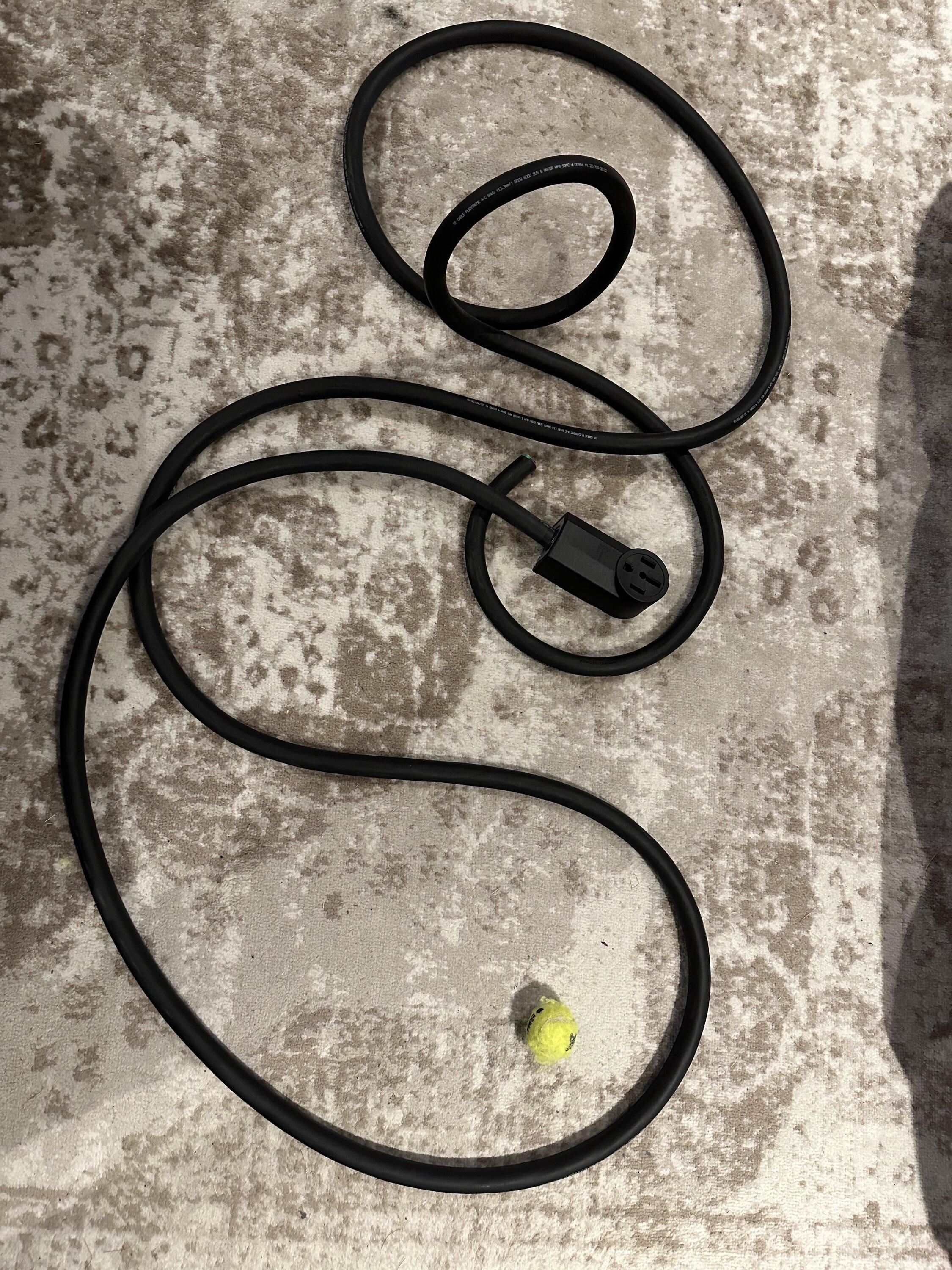

Not sure in my area. I ordered the SunRun HIS and Ford Pro Charger. I’ve had 4 electricians come by and gawk at it. 1 came by twice. Still looking…
Until then I’ll add a 50amp breaker and use the 240 mobile charger. Will add to panel this weekend. Afterwards, I just I’ll just add a plug and have a 20’ NEMA extension cable. 6awg, 6/4, SOOW. FYI: 400A to house, 300A load.
