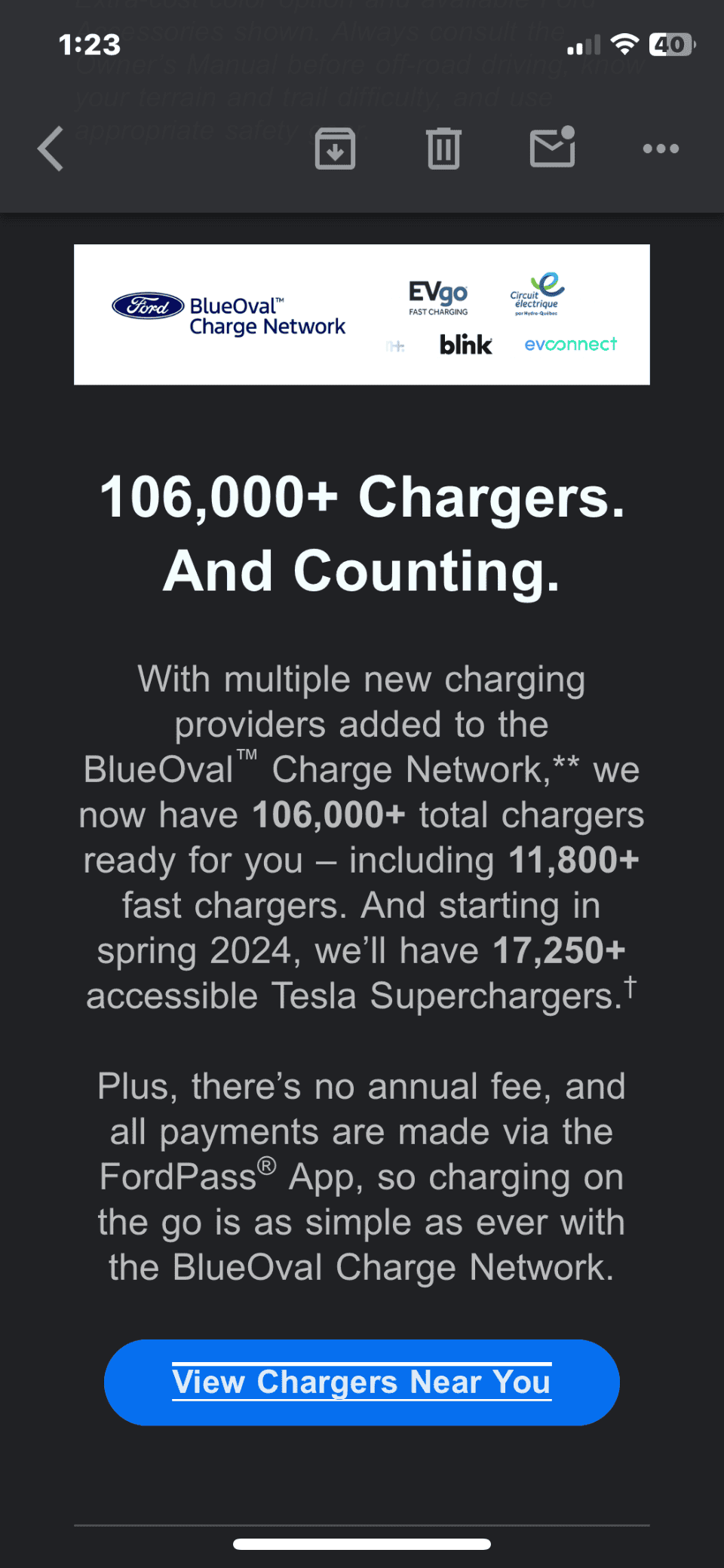

Ford will be producing new EVs with the NACS connector in the 2025 model year. The deal has always been access to much of the existing supercharger network for existing vehicles through an adapter (really old superchargers won't be supported). Payment processing will be done via FordPass as announced. It is unlikely that you will be able to activate or pay for the Supercharger use through the app -- that's only for the MagicDock locations. Tesla representatives, speaking on the public record, have stated that February will be the timing for Ford access.
Has Tesla blown deadlines? Sure, but this one is kind of a big deal, because they're projecting revenue from other automakers being able to use the supercharger network. As a publicly traded company being looked at under the microscope, they need this new source of revenue as much as we want the access.
The whole industry switched to NACS based upon the contractual commitments made by Tesla. It's in Tesla's direct financial interest to get this done. If they blow it, they face breach of contract litigation from other automakers. I would not be surprised if other automakers put penalties in place for Tesla if they do not meet certain date/milestone targets. Given the history of Tesla, it would be a prudent thing to do. Again, if Tesla blows this, nobody is going to do business with them.
