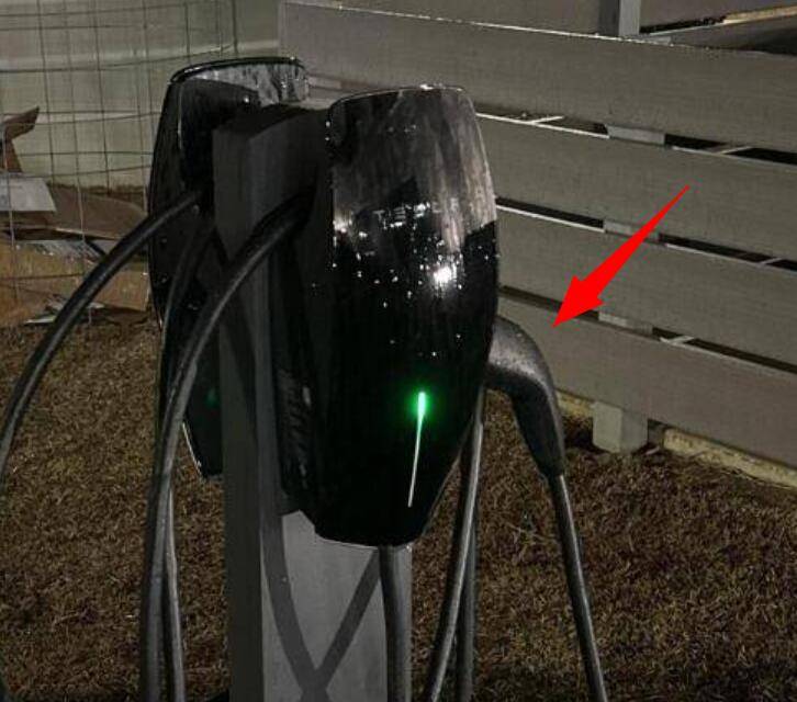

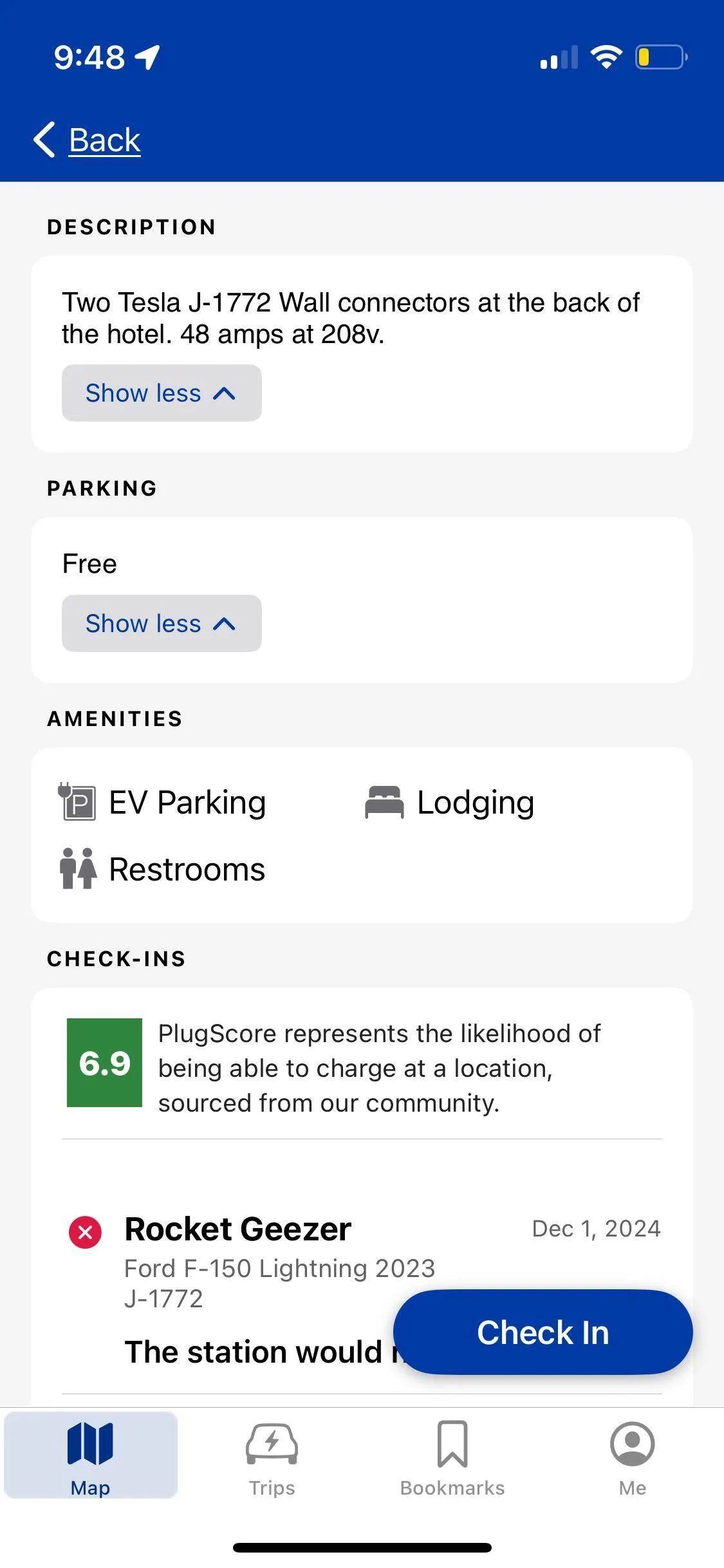

So (I think) I know that for a Tesla Supercharger, I will need the NACS adapter that Ford says they will eventually (one day) ship to us for use with our Lightnings.
However, from what I’ve read online, it’s not as clear to me what, if anything, I need to charge my Lightning at a Tesla Destination Charger.
For example, I’m planning a 600 mile trip in the next month. There is a perfect halfway point at a Hampton Inn that according to PlugShare, has 2 Tesla J1772 chargers. There are reviews for it suggesting other EV’s besides Teslas have been charged here. But of course the only Lightning that attempted it said it wouldn’t activate!
I’ve attached 2 screenshots. So, what would I need to charge here? Btw-Tesla’s website calls this a Destination Charger. And if I don’t need anything for this particular Desination Charger; what is an adapter I can use for other Destination Chargers, and how will I know when I need it?

Per the first screen shot you post, if the hotel knows what they truly have, you don't need anything. it lists the Tesla charger as a J-1772, which they have sold in the past and per the picture I would say the plug is much larger than their NACS plug, so I think you are good to go.
Tesla destination chargers are the very same charger they sell for home use - typically referred to as L2 and Superchargers being L3. They have been sold most typically with NACS, some with the J-1772 and most recently the one with the both NACS and J-1772 using the dock.

I concur with GDN – it appears that this Tesla charger has a J1772 connector. If it does, you are good to go without an adapter.
That said, I travel with both the NACS to CCS adapter, and the NACS to J1772 adapter. On my most recent road trip of 1500 miles, I used both multiple times.
Side note: At hotels in my experience, Tesla chargers are more likely to be 40 or 48 amp than the J1772 chargers, that are usually 32 amp. When I have a choice, I almost always use the Tesla charger with an adapter because it’s charging speed is about 30% faster.

Based on the description and the picture, this is a J-1772 connection and you need no adapter to charge here. That picture absolutely shows a J-1772 connector, not the NACS.
Here's the critical information I think you are seeking:
  • Destination chargers, regardless of connector, refers to AC charging equipment.
  • DCFC or Superchargers refer to DC charging equipment.
Due to the engineering differences between the NACS and CSS plugs, you must carry two different NACS adapters to use your Lightning at different NACS charging stations. One for AC and one for DC. If you're going to be doing a lot of traveling and don't know what equipment you will have access to at different locations, you need to buy both adapters as has been posted in this thread.
