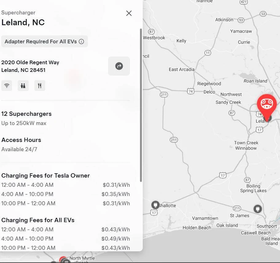

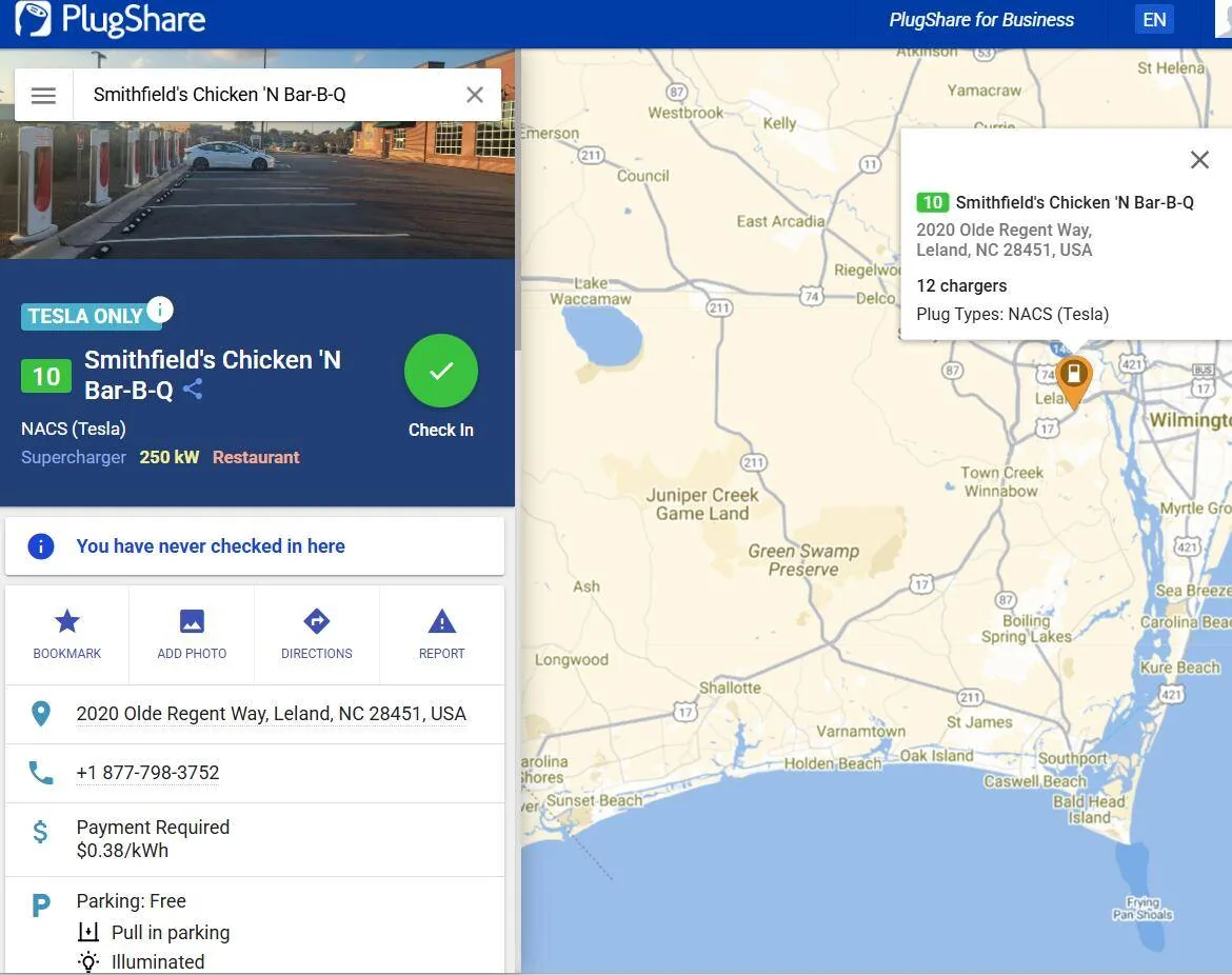

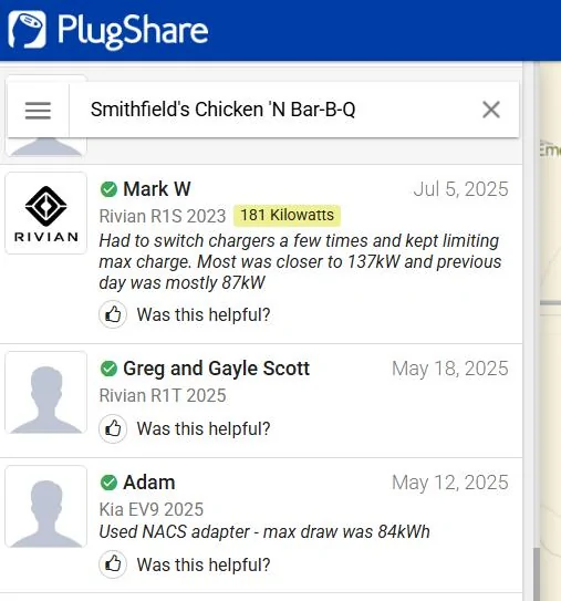

I wouldn't say zero reason. Plug share has had several here in NC that are marked Tesla only for a while now which is incorrect. What's interesting is that it did list at least this one as compatible but they changed it for some reason. Can pay to check the comments and/or the Tesla app itself. Below is just one instance

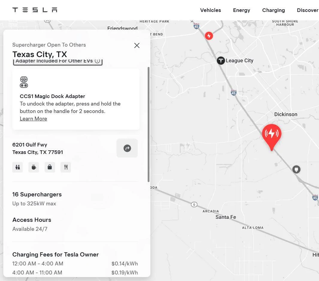

Do I need to have a specific update to be able to charge at new V4 tesla superchargers? Twice it didn't work for me at different locations.
- 1st one was in Austin TX
- 2nd one was today at the Buccees in Texas City south of Houston.
In both cases the error message i get is there is a station fault! No matter what i do, change station it does not work at all. When i use ford pass to activate the station the app shows that it is activated but the truck does not get charged. What am I missing here?
