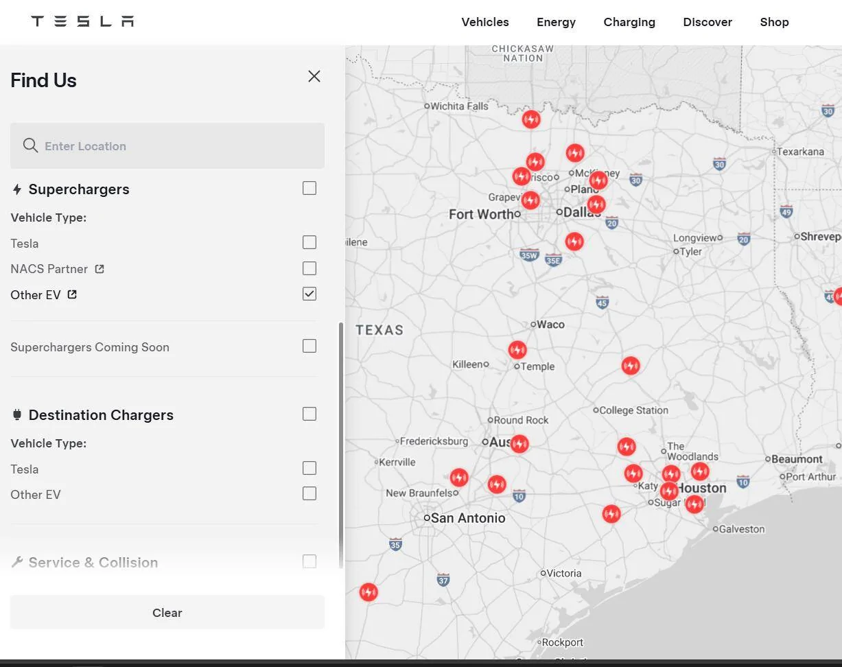

Correct. https://www.tesla.com/findus Just select Other EV and it will filter those that have a magic dock. Only a small percentage of the overall supercharger count actually has them enabled but looks like there are quite a few in Texas. This shows a v3 with the magic dock from a couple years ago so now you don't have to unlock the adapter in the app but gives you the idea of what it looks like. The only way I've found to determine locations with the v4 stalls and longer cords is supercharge.info and filtering by v4.
