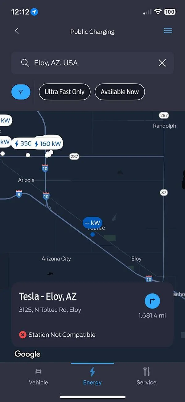

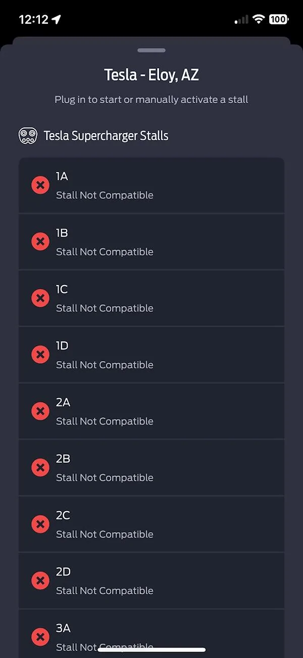

So coming home from Phoenix, I knew the Circle K at I-10 and Toltec in Eloy had 28 Tesla chargers. I needed a little boost to make it all the way and planned on adding. It did not work. Could not find it on the Tesla app or Ford app. Why do some Tesla charge stations work for us and others not? A Chevy was there also. He could not charge.
Hi @Crullbri
Not all Tesla Superchargers are open to Ford vehicles. When you check FordPass, note that the Eloy station is noted as not compatible.

This will also be reflected in the Public Charging app on the touchscreen.
For more on how to find compatible chargers, check out ford.com/fastchargingadapter or scan the QR code inside the box your Ford adapter came in, or on the pamphlet inside the box the Ford adapter came in.
