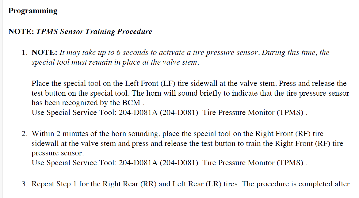

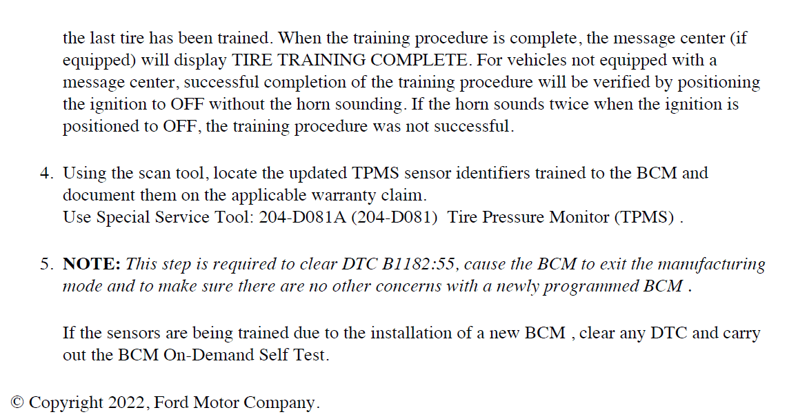

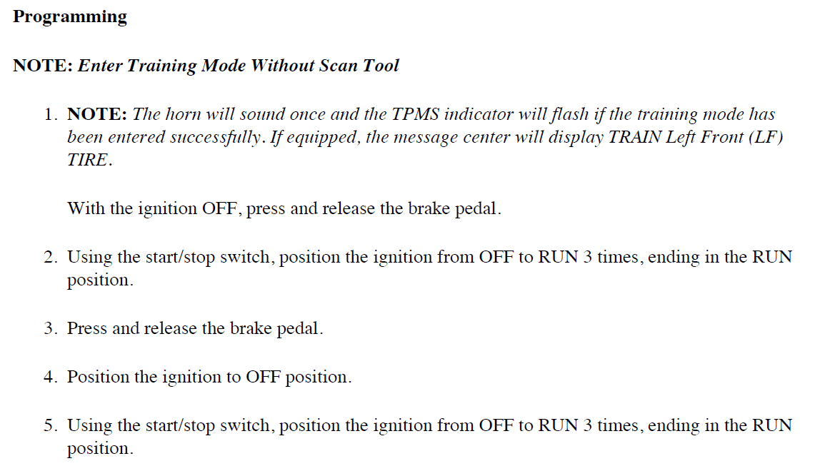

Manual Pages 469-472 [my23] overview of operation & troubleshooting.
Need the Service manual for calibration of new sensors. see next post
212
15,656
17,535
Service Manual
Ford F-150 Lightning TPMS for spare 1707145083870
