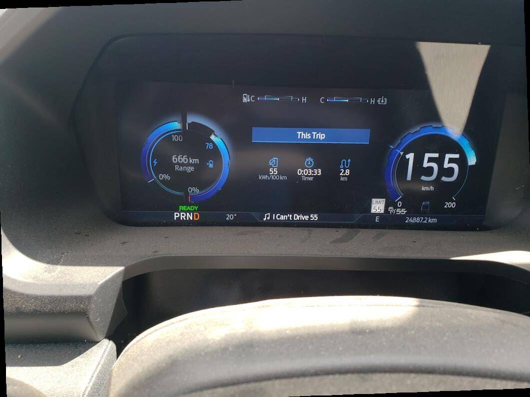

Uhhh, seems a bit fast for the neighborhood... (80 in a 35???)

Well, I had a fun song come on, and then photoshop fun ensued ...
Ford F-150 Lightning Uhhh, seems a bit fast for the neighborhood... (80 in a 35???) 1749222324869-8r
