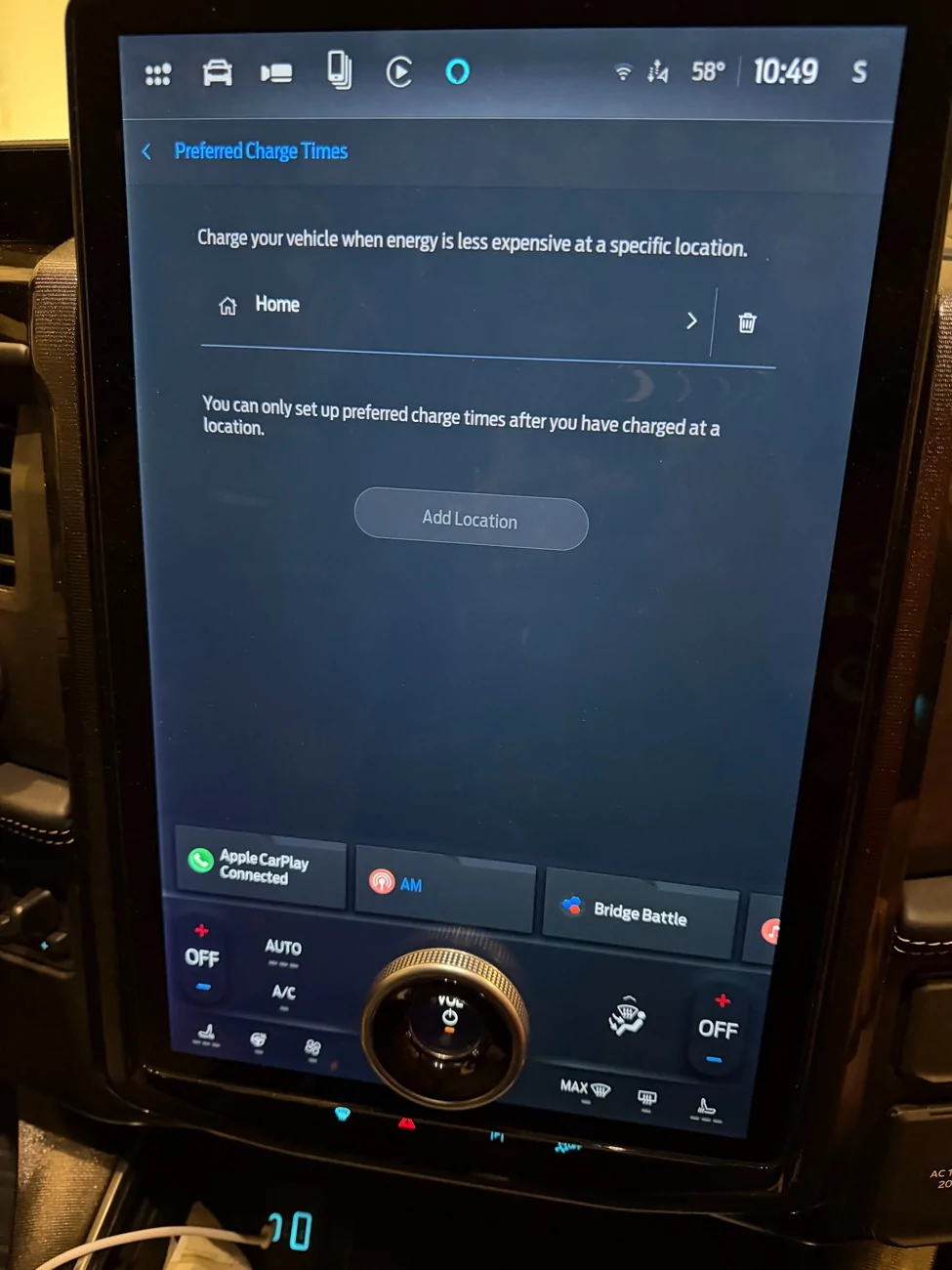

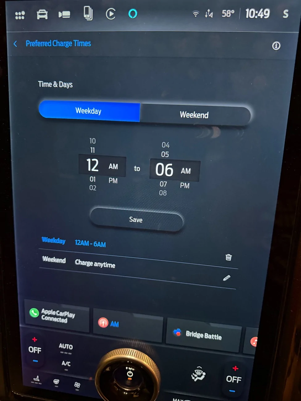

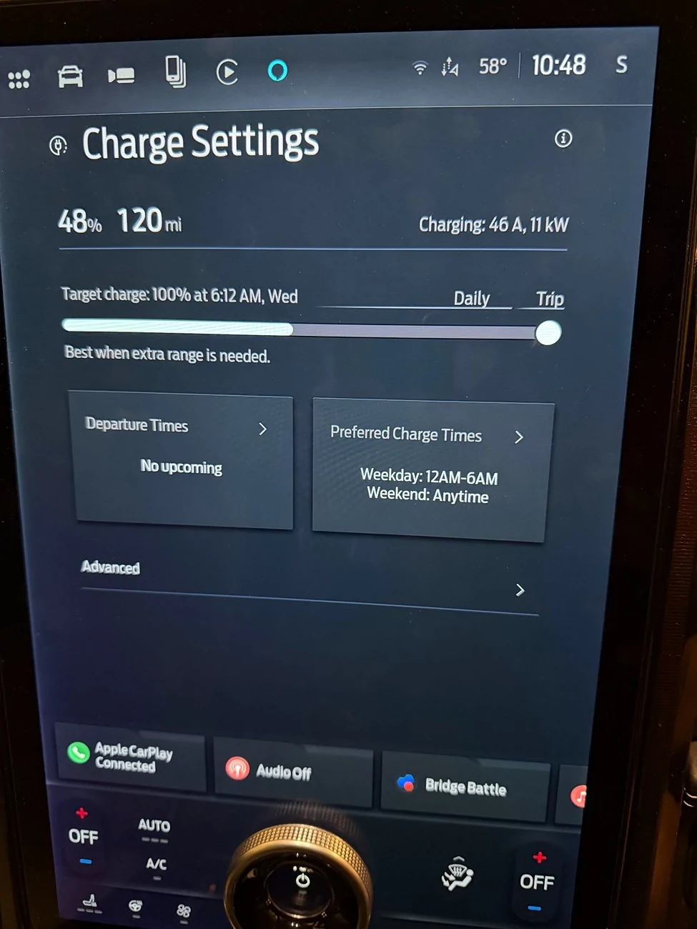

Here are a few screenshots, the first is of the charge settings, and the other two are the preferred charge times / location where the location does not have a slider to set the charge limit. I am not sure if that is normal or if this is how it is supposed to look like for everyone.

Here is a video of me changing the target charge to 80% while the truck is on a charger and charging, and you can see the slider just reset to 100% almost immediately.

Yes, I have plugged the truck in at home and charged multiple times. I used the in truck screen to set the location and named it home. All of that worked fine, but it does not allow me to set a charge limit either in the truck or in the app. When I try to set it in the app, I experience the same as what happens in the truck, the slider just moves back to 100% after a second or two. At that point the app will give me the following error message:

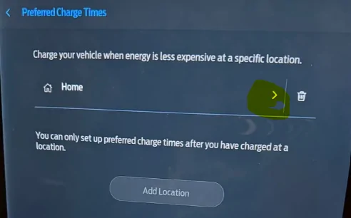

The model year 24 screen is different than my 22!!!
Something says to me this is a database issue with the trucks account, the phone, the cloud and truck Sync are conflicting each other.
Try leaving the truck unplugged.
Power off your mobile device (Phone), have your FOB in the truck to allow it to start.
Via the Sync screen in the truck, go to Charging app.
EDIT the established HOME scheme, by tapping the > symbol
Ford F-150 Lightning Unable to Set Charge Limit 1767796355723-1z
You should see the SOC setting screen, adjust to preference, see if it holds.
Then move to the time frame screen, set weekday & weekend start/stop values.
Save the configuration.
wait a few seconds, then review the edited values to confirm they've stored.

So currently when I press the arrow you highlighted to edit the home charge settings it takes me to this screen:
Ford F-150 Lightning Unable to Set Charge Limit IMG_1748
There is no state of charge settings in the home location. Only the ability to edit the time.
There is only a single place where I can attempt to change the target charge and that is the slider I show in the video above.
