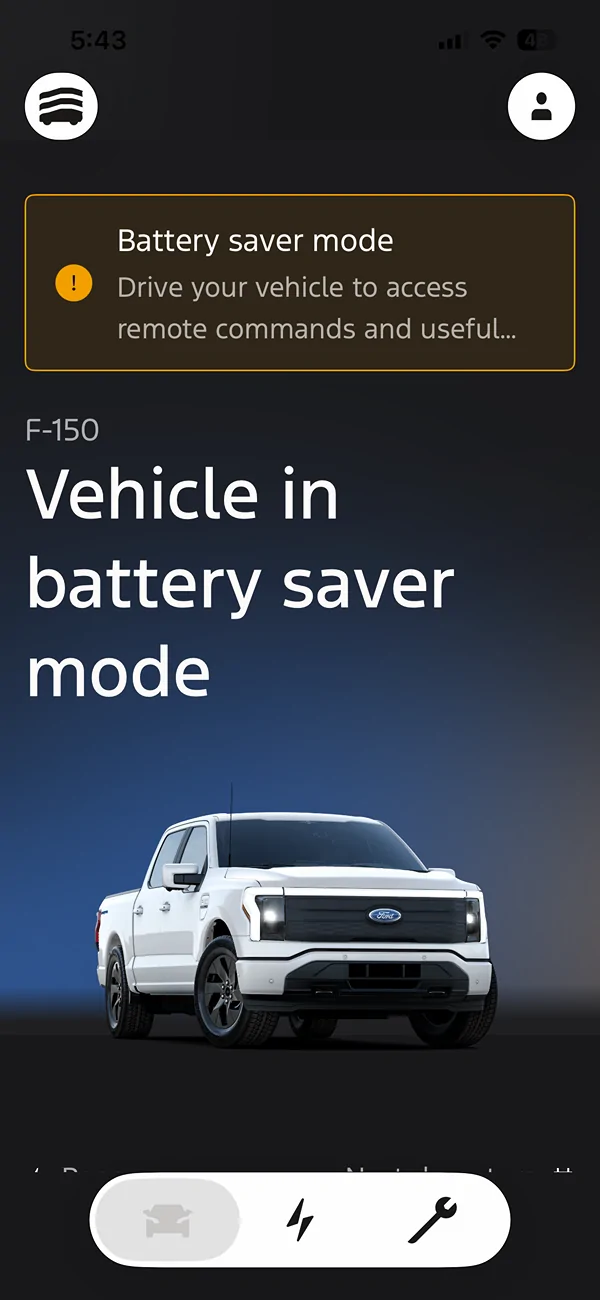

For what it’s worth, I’ve been repeatedly getting this message for the past few weeks. I posted it under another topic and got a variety of suggestions, none of which seemed to help. I brought it to the dealer yesterday. They said the battery was in good shape and they were unable to immediately determine the cause. I left the truck there and they said it would take a few days to work it out. Of course I will keep the forum posted.

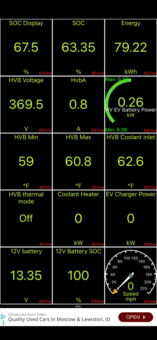

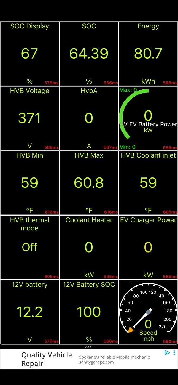

After sitting in my garage unplugged for 10+ hours while I was at work. It’s sitting on with shutdown timer disabled now.

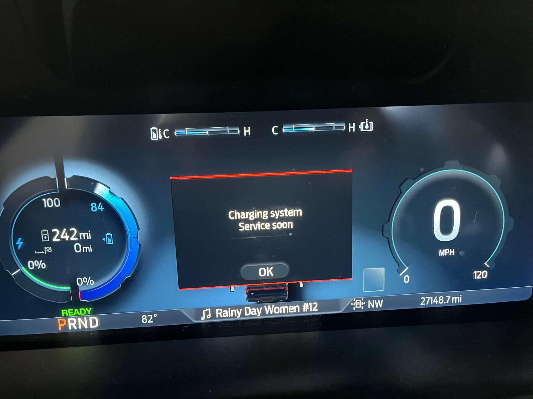

After 2+ hours on, we seem to come out of battery saver. I don’t see much difference from when I turned it on, but that seems to have fixed it at least for now. Just to be clear, the 12.2 V in my previous post was before turning on. The LVB battery voltage jumped to about 13.35 immediately after turning on, but we didn’t drop out of battery saver for at least an hour and a half. Thanks for the encouragement to leave it on for longer. Now, how can I get the dealer to replace this under warranty… (2023, 12000 miles)
