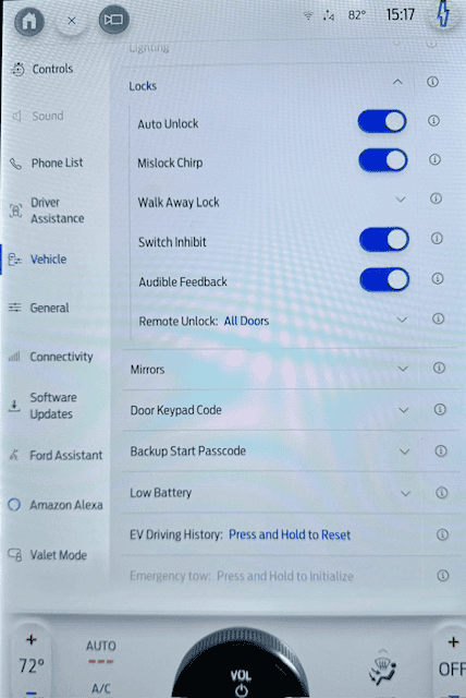

1) If you have gotten the BCM update;
2) and your FordPass is telling you that your vehicle was locked by Walk Away Lock when you walk away from it;
3) and you are familiar with FORSCAN;
You can enable the WAL menu in the Sync Vehicle Lock menus by selecting the APIM 'easy mode' in FORSCAN (not the asbuilt mode with the hex values) and then scrolling all the way down to Walk Away Lock and then just enable it.
Write the value, turn the truck off, and then back on when told to, and the menu will appear under the Vehicle menu in the Locks section:
Ford F-150 Lightning Walk away lock after update WAL_Menu
This function has nothing to do with PAAK. So jumping through hoops to delete and restore your profile etc. won't help.

Thanks for sharing this! I was using the as-built and managed to erase my 1-pedal drive toggle while trying to enable the WAL toggle. I have them both on the menu now thanks to your post! (y)
That’s awesome, thanks! I just enabled it. Walk away lock is awesome almost everywhere but it’s a huge pain at home. I wish it had the feature to designate locations where it’s inactive. Still I think I’ll probably leave it enabled for now. Nice to have the option!
