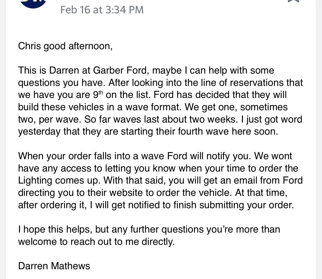

Ford F-150 Lightning Wave 4 invitation - did you get one?? 6653A843-A55C-482D-B6CF-F411FFAE1334
Finally got some response from the dealer. Although I was an early reservation- don’t hold out hopes for a 2022 model.
not sure if I was 9th overall or 9th remaining that have not ordered
To give u some (possibly false)hope, by him saying sometimes 2, I'm figuring they had 1 invite for 3 waves and 2 for one of the waves =5 orders. So if they get 2 invites/wave for final two waves, or get one more 2-invite wave, and have a final "filler" wave, or you might squeeze one in. That's assuming you're gonna want a platinum which will probably gonna be all that's left. Or at least you may get to be higher up on the deferred list for 23MY.

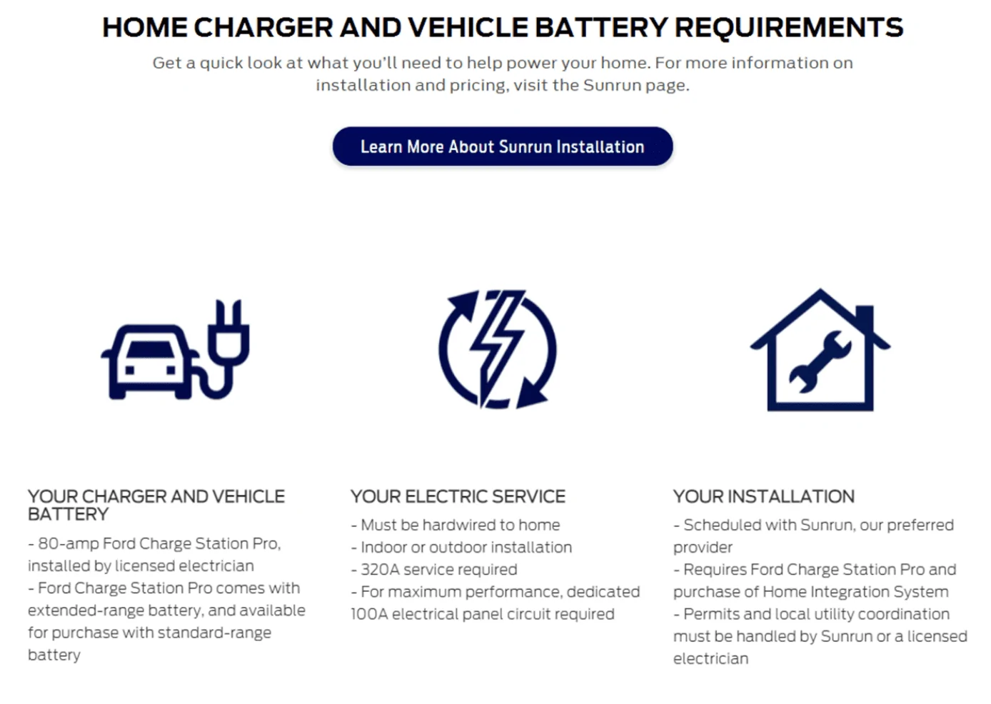

You don't need 400A. I'm installing it in a 200A panel.
hmmm no thanks! you should REALLY check with your insurance company...Ford requirements for installation of the 80A charger are clear and that's what insurance companies / local by laws will likely require.
For sure you can derate it, but I would not put my money on doing that without the proper set up, clearance from insurance company, local bylaw, etc...- if a fire were to happen, your insurance company will be looking at your house with a microscope and they could easily deny payment sole on the basis that you installed a 80A charger on a 200A when that specific charger had a clear outlined requirement for 400A....too much risk to lose my $1.1M house to something as small as that LOL...
I feel like a lot of people do work without thinking about the potential consequences to insurance, future sale, etc.
And where is this “clear outlined requirement for 400A” you speak of?
right from the Ford's website....320A service required....but it's clear, it requires a 100A breaker, so when you apply the 80% rule it might just not be enough to power to rest of your house.
Yeah I planned on Lariat SR but was debating the Lariat ER. So I suppose if I got an order option and only platinum was available I would probably pull the trigger on it.
Keep playing the waiting game until then
The 320A service requirement was originally stated for powering the house off the truck, not for charging it. And that requirement was removed.
https://www.f150gen14.com/forum/thr...longer-details-320-amp-home-service-o_o.7956/
They removed that piece of info from their website over a month ago after realizing it was mistakenly put there, and Tom Moloughney and others have clarified with Ford that it is not necessary or required.
Ford pulled down that requirement because it was wrong. It is also based on the backup power usage and not the charging side of things. For charging, it all depends on the other electrical loads in your house. I have a 150A panel, but very few other loads (everything is natural gas). We had an electrician come out and verify that we won't have any issues. We put in the 100A circuit already (wiring anyways), but only have a 40A EVSE on it right now for my Wife's Mach-e. I didn't want to pay to have wire pulled twice!
