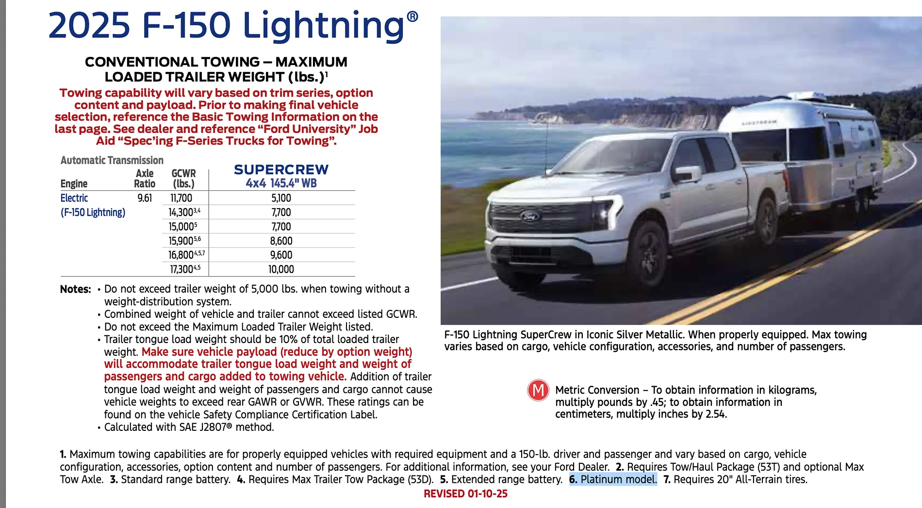

WOW! You make some pretty bold claims here and try to pass them off as if they were facts. Let me help you by providing some actual facts.
Yes Ford uses the SAE J2807 standard that most manufactures use to determine tow ratings. Do you even know what those test consists of? Its just a bunch of basic test such as climbing a mountain in a certain time, Braking in so much distance, accelerating in so much distance, etc…. They do this in normal weather conditions and try to max out the best rating they can get. When I drive, sometimes I leave in nice weather and a half hour later, I’m in a storm with 60mph wind gusts, Sometimes I go camping in the mountains and it happens to be in extreme heat, hotter then their testing. TFL does torture truck tests and most of them fail climbing a single mountain in extreme heat.
Second. You claim that ALL lightnings are rated at 10000 lbs. Below is from Fords website saying you are wrong. Or do the SAE J2807 ratings no longer apply because it doesn’t fit your voodoo narrative? (look at footnote #6 for what applies here)
Ford F-150 Lightning Would you tow this? Screenshot 2025-09-19 at 9.43.53 AM

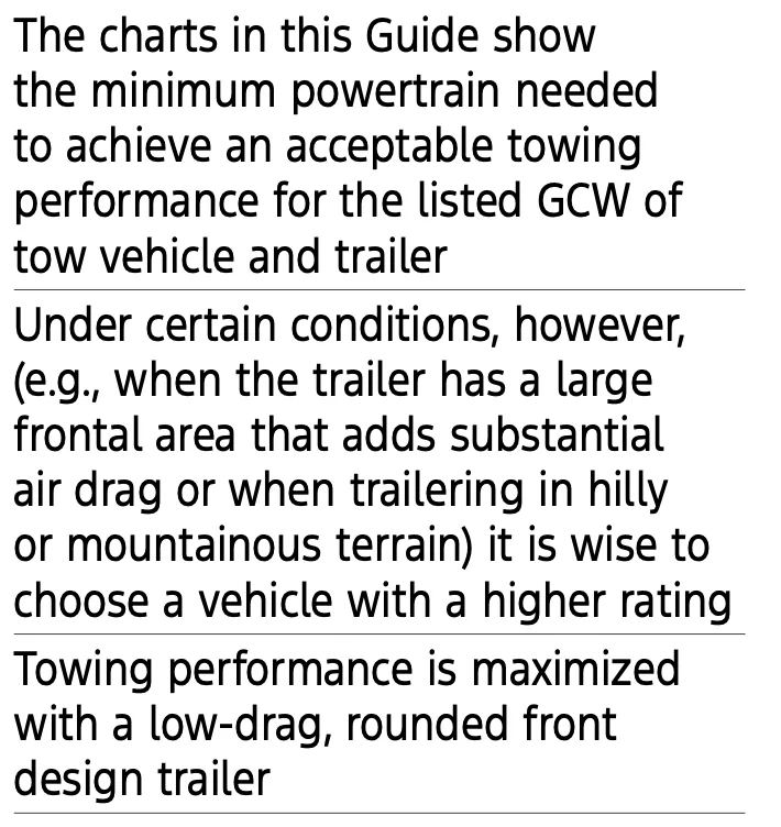

Do you think they reduced the platinum rating because they love having different numbers and lower marketing numbers or because it failed the test at 10k lbs? These ratings also come with the following conditions, which further reduce them based on the elevation you are driving.
Ford F-150 Lightning Would you tow this? Screenshot 2025-09-19 at 9.45.28 AM
Then you go on claiming a super duty, well under its tow ratings, is less safe to drive than a maxed out lightning. Based on the laws of physics…. What happened to the SAE J2807 standard you were so fond of. All things being equal, you would be right. The laws of physics would dictate it’s safer based on mass differential. But Tow ratings are based on much more than just mass otherwise a super duty would not be rated for 40k lbs. For example, If the lightning brakes were replaced with tiny ones that are normally found in a compact car, would it still be equally safer than a superduty? The laws of physics when it comes to mass did not change. In other words. There are many factors other than mass. that determines a tow rating. (Which technically means safe to tow this weight). Ignoring them because you know best about the laws of physics and won’t let the voodoo zapper take away tow weight, is the exact reason I see trucks and trailers flipped over on the side of the road.

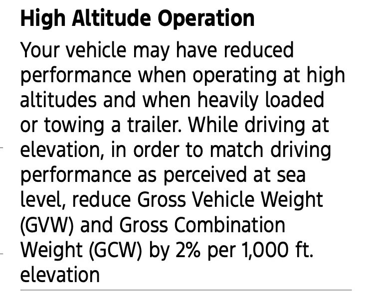

His platinum is rated to tow 8600lbs at sea level. SAE J2807 uses low utility trailers for their tests. There is also another warning that states if a trailer has a large frontal area, you should choose a truck with a higher rating. Meaning, take these ratings as a low ball max and get something better if you are towing near the max.
Ford F-150 Lightning Would you tow this? Screenshot 2025-09-19 at 9.47.50 AM
Again people are free to do what they want. 999 times out of a thousand everything will go fine. You just don’t know when that one time is, but if it gets you, you can do all the should of could of dances you want. Also know, if you exceed your ratings and get into an accident, you can be charged with gross negligence and your insurance will not cover you.
