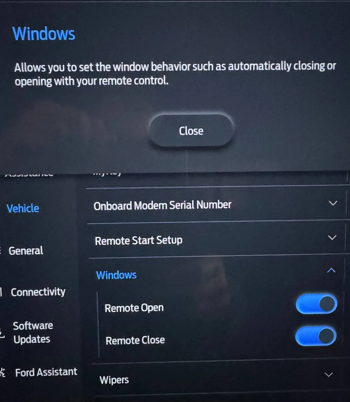

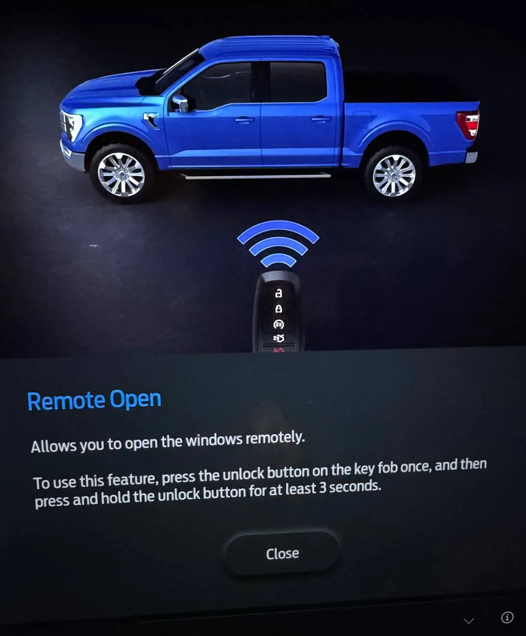

If you have the Global Windows activated it will also have settings in the truck's menu.
Ford F-150 Lightning Zero window up controls via app or fob ? IMG_3042
Ford F-150 Lightning Zero window up controls via app or fob ? IMG_3039
