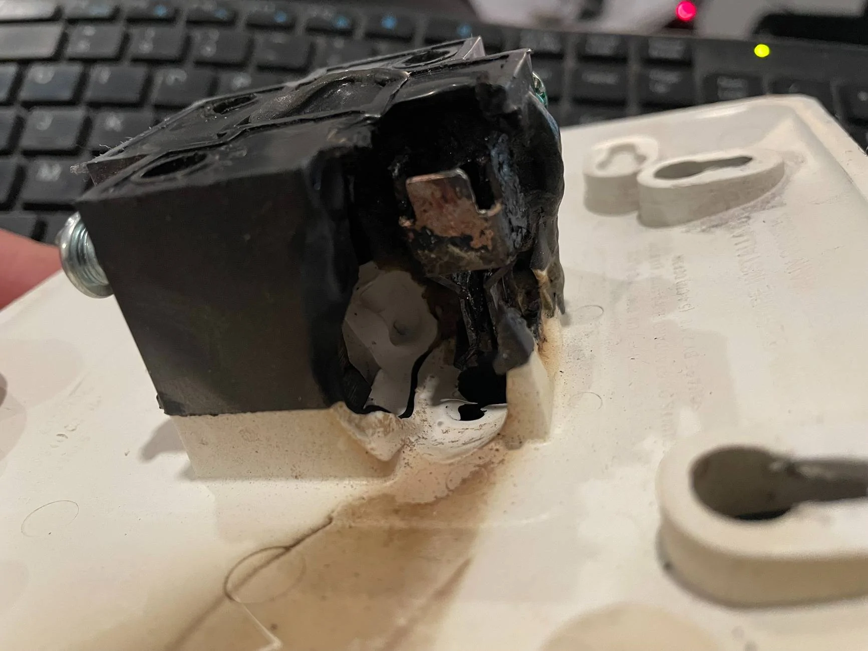

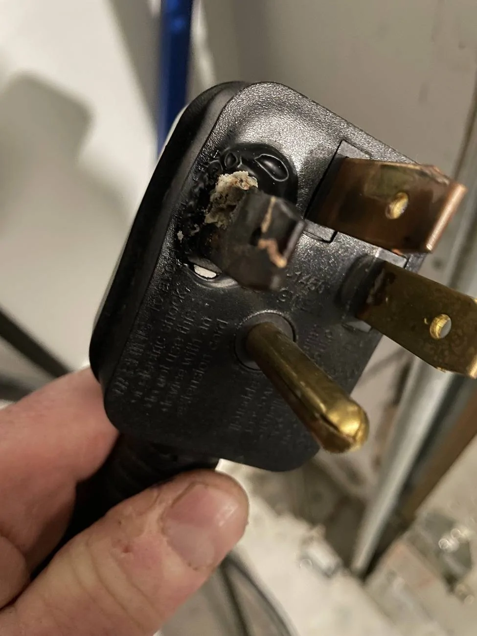

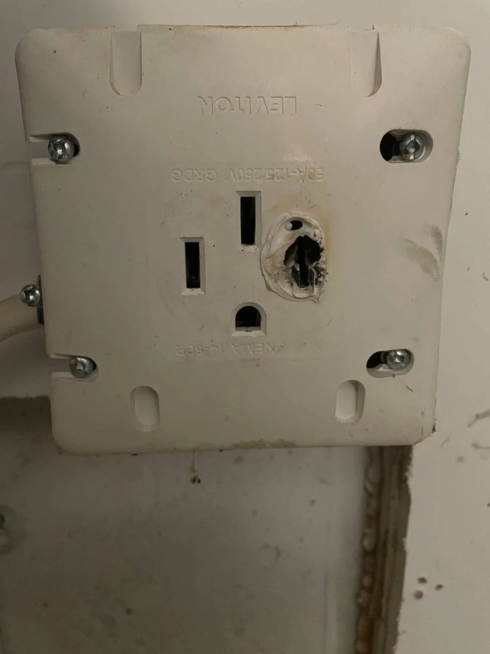

I had a chargepoint charger fail yesterday and it has left me confused about some things, hoping electricians or anyone that knows how this could happen help me understand.

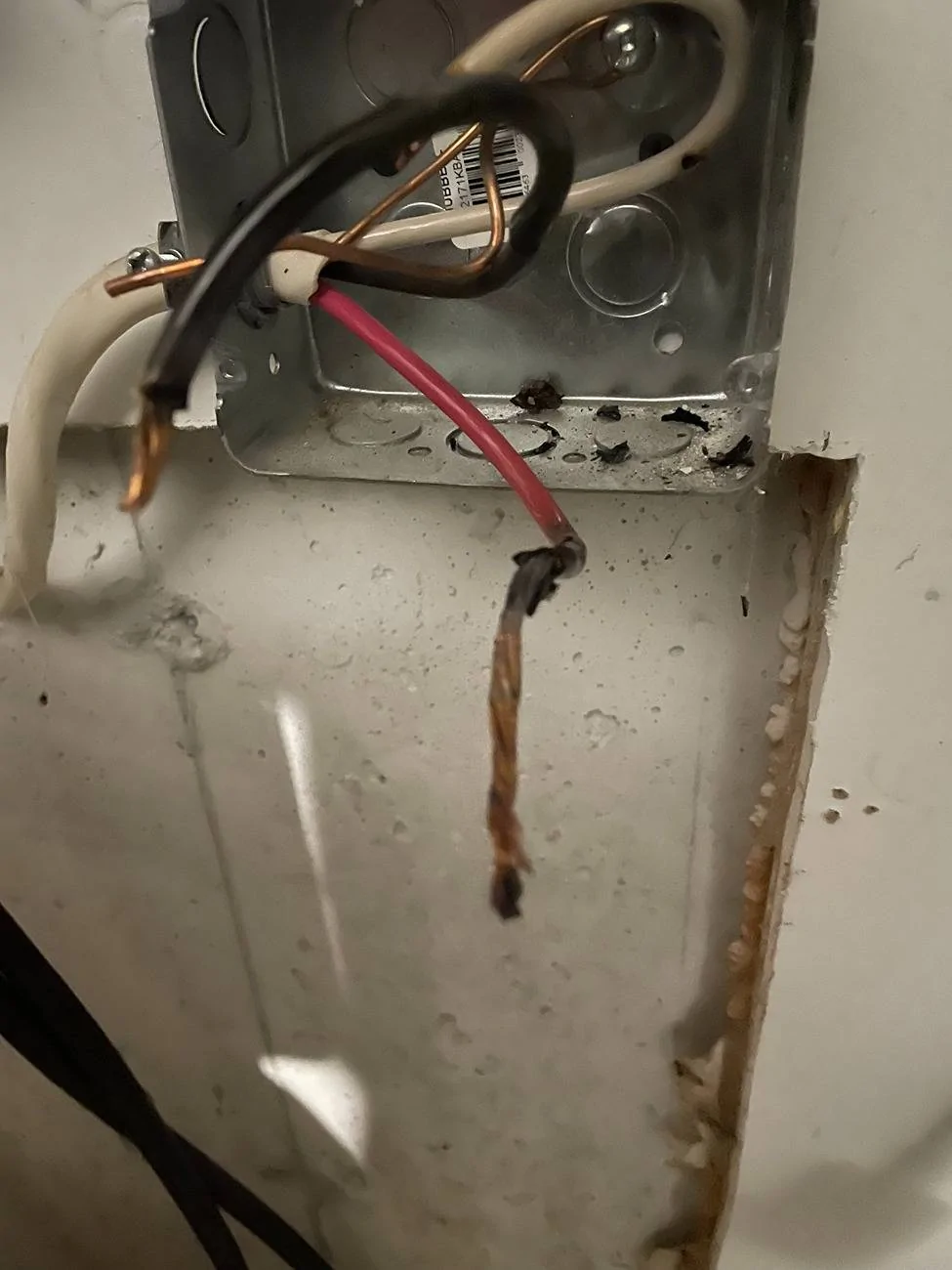

I went to my garage in the morning and could smell that burning electrical smell and discovered my charger plug was damaged and burnt. Thank god the truck managed to fully reach 80 percent charge and must have stopped charging before this went to an all out fire. When I opened this receptacle up both the hot lines were burnt with no insulation for about 3-4 inches from the end of the wires, ground was fine.
I have had my lightning since Oct 2022 and have 97,000 km on it and almost 100 percent charged at home on this chargepoint charger. Last night was -15 C (5F) so i know it harder on the charger at cold temps. I have run this charger 5 times a week all night until 80 percent charge never an issue.
if you know the chargepoint chargers, they are remotely set for maximum charger amperage via Wi-Fi and chargepopint, you cannot set the max rate like you can on the ford charger they do it for you.
I called chargepoint today and they seemed to have some concern over this and are quietly asking for pics and when reviewd decided to replace my charger at no cost to me and want this one returned.
I think my real concern here is, ok the charger failed in some way but why did my 40 amp breaker not fault/trip?

That receptacle is not one of the few available industrial-grade devices. When used continuously, they will all melt at some point. Your breaker didn’t trip because the charge current never exceeded the breaker rating. Once the connection points in the receptacle start to fail, the resistance increases and it overheats without any abnormal increase in current flow.
The best solution is to hard-wire the EVSE and eliminate the receptacle as a point of failure.

Thank you for that but... the receptacle is 50 amp, ok it is not designed for continuous load (i didn't know that they were not) but why the wire melted like that, it seems as if one leg was pulling a lot of current.
I will get an continuous use receptacle and replace this stove one.
Thermal cycling of the connections or the tension of receptacle blade receivers weakened overtime, leading to increased resistance and heat.

The torque on the connection needs to be set so that it doesn't loosen off.
Many heat cycles can on a loose connection can lead to what you see here.
The problem with those cheap outlets isn't duty cycle, it's plug cycles. Every time you unplug and plug it in the connections get weaker, your stove is rarely if ever unplugged so you are unlikely to see a problem there. That's why a commercial version is better. They now sell one marketed to ev's but it's a scam, the commercial one will do just fine.
Also, exposed nomex wire is unlikely to meet code.
Torque the terminals to the recommended value and you shouldn't have this problem again.

I am pretty sure the chargepoint charger is a plug option only and cannot be hardwired. My ford charger at another location is hardwired.
I never unplug this so it was not caused by unplugging the unit but I do understand the lug likely was not tight after 2.5 years of hot and cold, also you cannot tighten these lugs well as it is a robby screw and i know the ev receptacle will likely have allen head screws to torque
In any event I did purchase Leviton EV receptacle to replace this one.

I see two possible issues. The outlet is not rated for ev use. I had the same issue years ago with my first ev a leaf. I had a 30 amp circuit and I changed the outlet to match my charger with a Leviton from Home Depot. Needless to say it didn’t last the outlet fried after a few years. I ended up rewiring the entire circuit with 50 amp and added a Hubble outlet. Also make sure your charger is set to 80% the limit of your circuit so a 30 amp circuit should have a charger pushing no more than 24 amps.

Hubbell and Bryant should be on your short list, but direct wiring is best!
