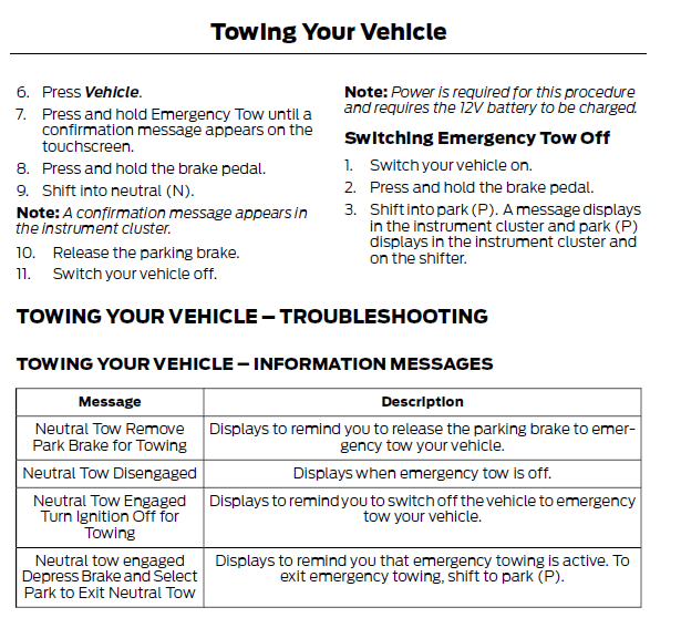

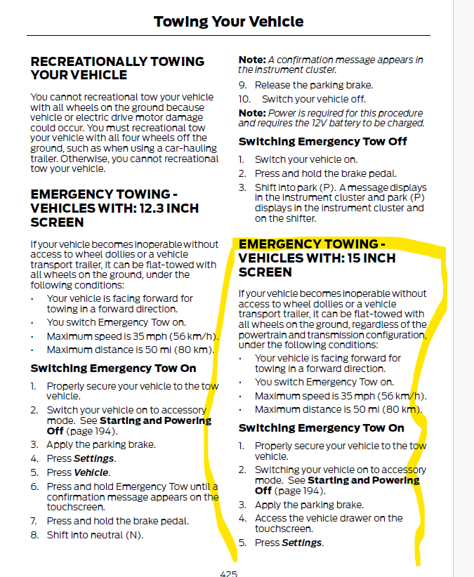

The truck is dead now. Can’t get it into nuetral. Anyone remember how to get it in manually?

If you have a tire iron & a wheel chock
Chock the wheel so it won't roll back further.
Place truck in tow mode
Use tire iron on a lug nut to rotate wheel.
Move a few inches / foot at a time relocate the wheel chock.
Maybe you can muscle the truck yourself into position?
Helpers push you up the hill?
