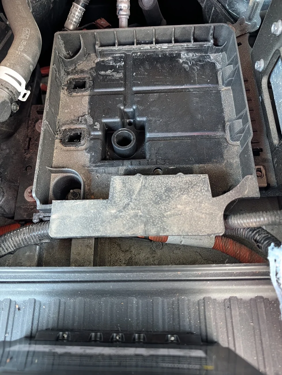

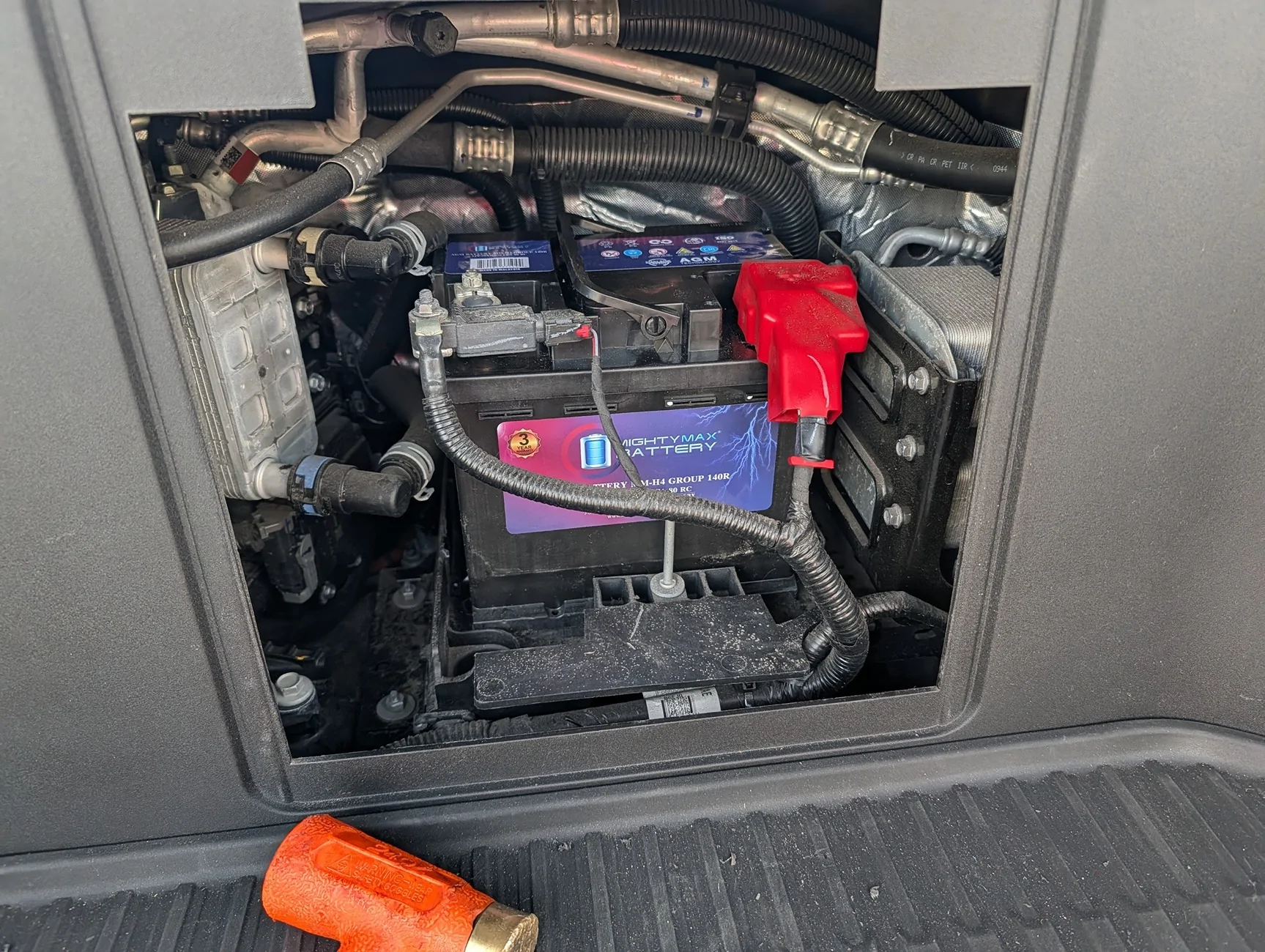

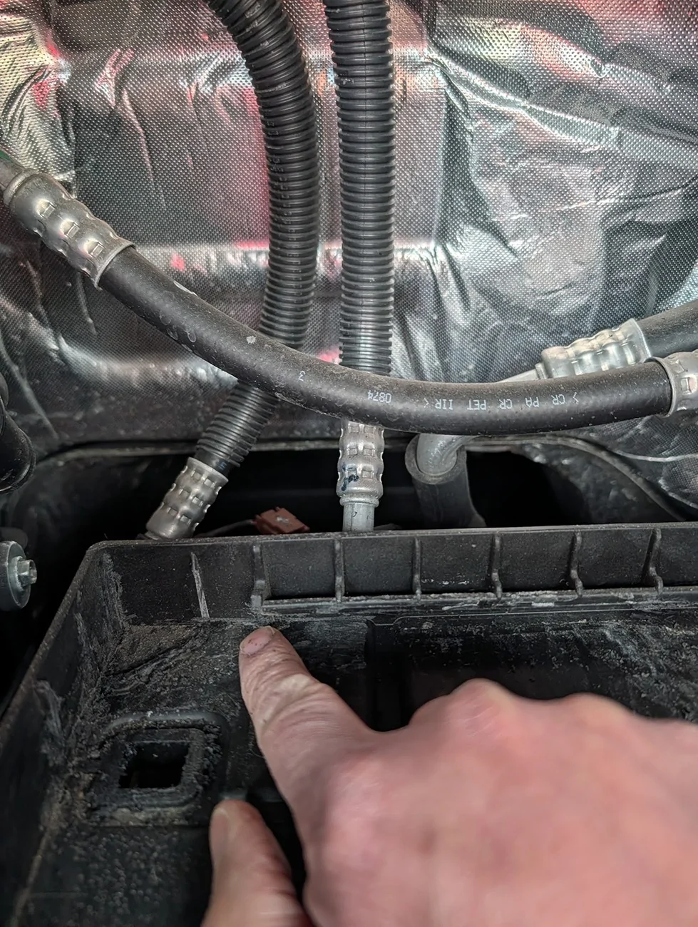

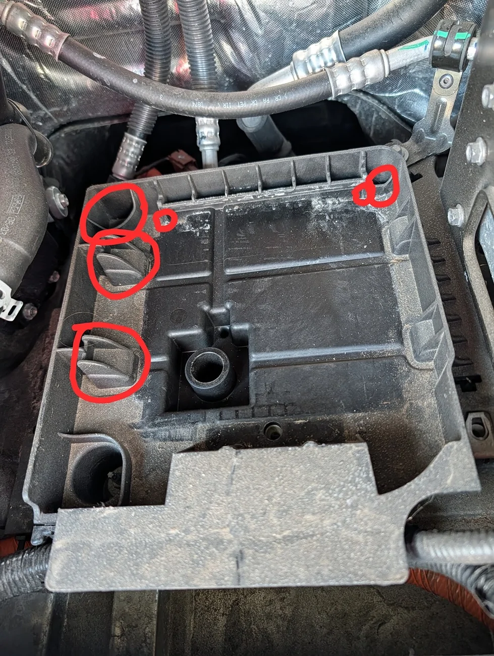

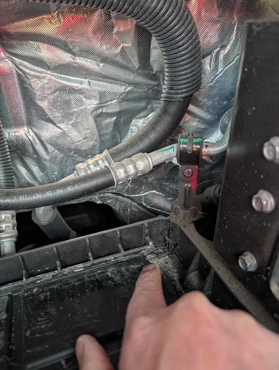

Replaced my 12v battery with an H4 size. Was hoping that this would stop the MyVIew on the IPC from resetting randomly, but it looks like that may be its own issue not related to the LVB. Anyway here are some pics of the battery tray alterations needed to get the H4 to fit.
