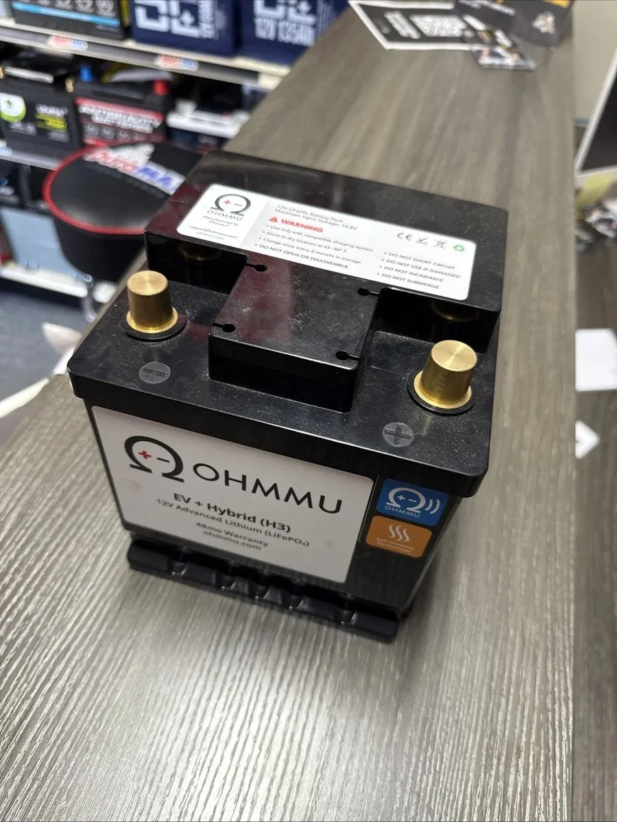

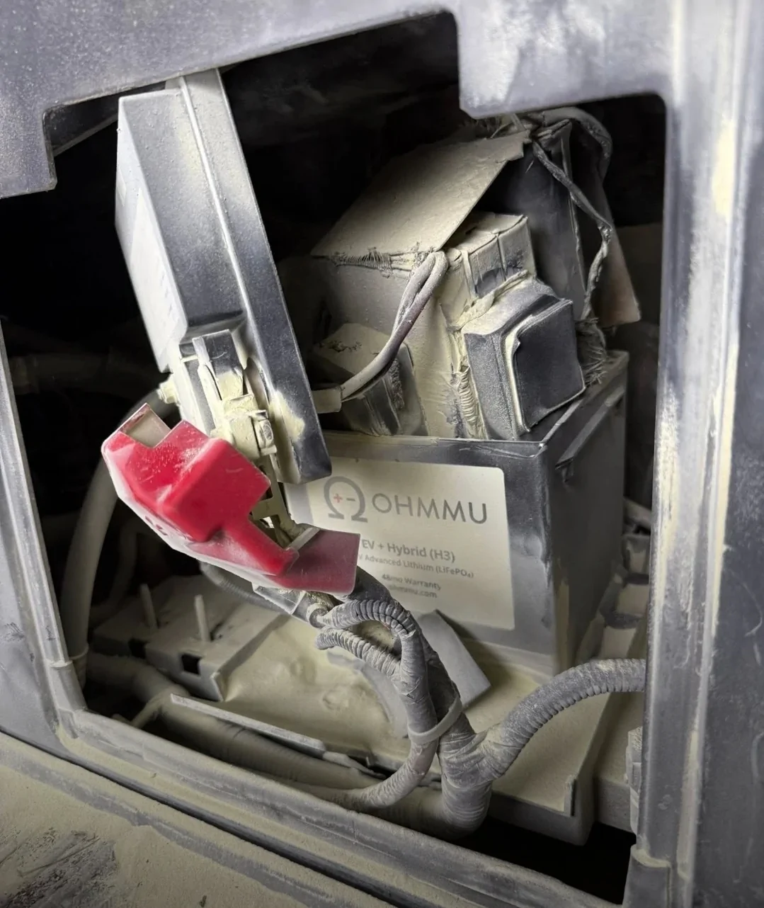

So as per my previous post here I took a good look this past Fall at my 12V battery, noticed it had bulging sides, ordered an OHMMU sodium 12V battery (only choice then available) and popped it in in late November or early December 2025.
I also mounted the optional OHMMU 12V battery monitor Bluetooth dongle at swap time, because why not?
We just got back from a three-week trip to Newfoundland Canada, 14 Dec thru 09 January total trip time. Two blizzards, an early polar cold freeze throughout the trip including on the way up and especially back down when we stayed with family in eastern Massachusetts... multiple times between the two blizzards and after them, it got seriously cold up there on the Rock (the local name for Newfoundland).
The OHMMU handled everything swimmingly throughout, so much so that I quit monitoring the 12V battery monitor halfway through the trip.
Very glad I had made the switch. My truck had about 81 K miles on it when I did, including some hot Arizona & Utah & Nevada driving this Summer which might have (??) contributed to the 12V OEM battery sides bulging.
