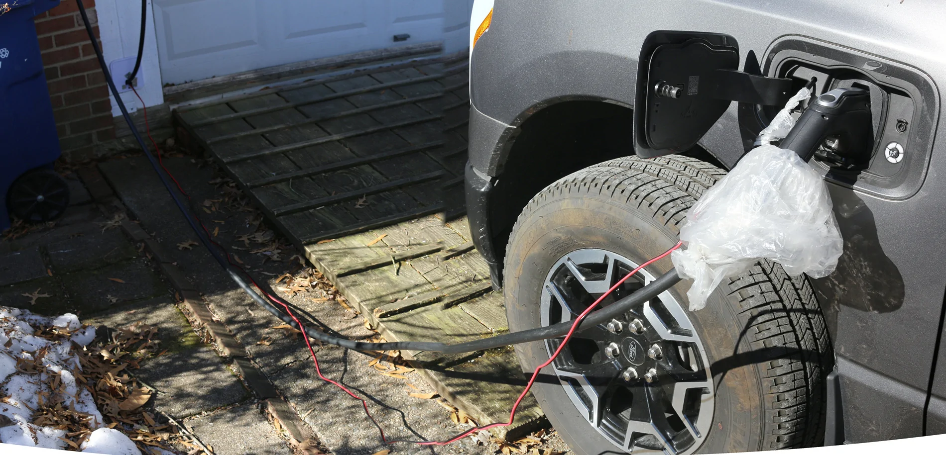

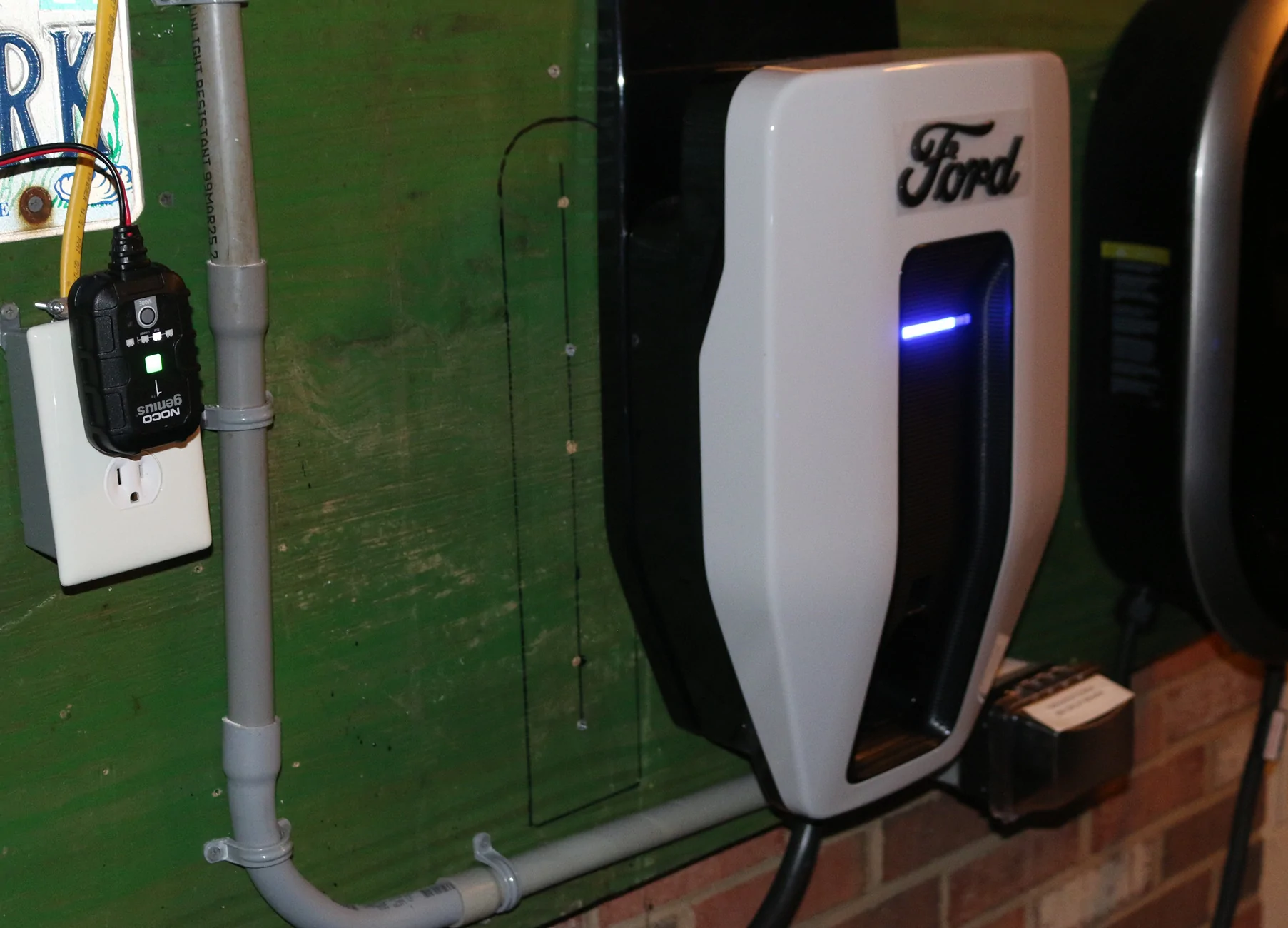

How did you add a battery maintainer? Just plug it in to the frunk outlets? And run the maintainer into the battery compartment?
I did what I saw some others had done an put a small hole in the plastic near the charge port door hinge and ran a wire to the battery compartment, Easy to reach in when the frunk is open to route the SAE charge wire - I had a spare with a built in fuse I used.
I bought a NOCO Genius1 - it has a proprietary charge plug on it so had to also get the adapter for the SAE standard ($15 groan), and I got a 15ft SAE extension cord so I could put it in my garage next to my FCSP EVSE and run the wire next to the CCS1 cable to my driveway.
Here are some pics:
Ford F-150 Lightning 12V Battery replacement with H4 IMG_6004
The port door closes fine with the SAE cord there.
Ford F-150 Lightning 12V Battery replacement with H4 IMG_6049-50 merge-FCSP and Battery cables outsid
I had used a plastic bag and some twist ties to cover the CCS1 and the SAE wire connection when we had a snow and ice storm - kept them dry very well.
Ford F-150 Lightning 12V Battery replacement with H4 IMG_6052-Garage FCSP and Noco Genius
Inside my garage I can plug the NOCO in out of the weather.

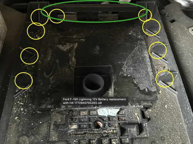

so the battery can slide under the rear seat.
I'm confused by "so the battery can slide under the rear seat". My battery is behind the plastic in the back of the frunk.
Rear seat in the battery tray. It's the bar at the back of the battery tray where the base of the battery slides under to hold it securely.
I feel so silly!
