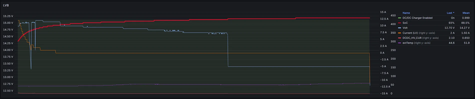

While charging it's typically around 14.5 - 15V, once the battery is almost fully charged (+90% SoC) it goes into the "float" stage and the voltage is reduced to 13.5V.

This is pretty representative of what I see regularly.
That's the proper way to charge an AGM. Mine is pegged at 15v measured at the battery posts. 7-hour HVB charge cycle a few days ago - 15v the whole time. Maybe this is why my Lightning is hard on LVBs.
What do you use to capture the data?
When you get a minute, can you tell me what your Battery Monitor Sensor part number is? I had mine replaced under the CSP, and have ML3T-10C652-BA. Perhaps it is simply a bad one or they replaced it with the wrong one.

That's quite a nice setup. Is your OBD polling set up through the Pi? I'm guessing you only log data while running, or did you solve the problem with OBD polling, activating the modules while OFF?
Thanks !
Yes, I'm logging whenever the truck is on or charging (it's still kind of 'on" at that point so...).
The modules are sleeping when the truck is off so you won't get a reply from them and I've tried them all at this point hoping to find something useful. If you do poll the same module often enough, like 3-10 times within a few seconds (I forget the actual number, but it's something like that) it will actually wake up the modules and you can request data - but - it's not like the truck turned on, so you have no power supply (the DC/DC) so now you start to drain the LVB battery and it drains pretty fast - so in the end it's not really worth it.

@mr.Magoo when you get a minute, can you check what part number is on your Battery Management Sensor? I had the CSP done a while back, but the part number on mine is ML3T-10C652-BA and doesn't match the CSP. I think the part is just a dumb current shunt so it should be ok, but I'm concerned because my voltage at the battery post is high compared to what you are seeing.
Last night, my charge cycle was 2 hours and it held ~15.28v for the full 2 hours. Last weekend, my charge cycle was 7 hours and it started around 15.25 v and ended at 14.99v. Driving today ranged from 15.21-15.23v (on/off for about 2 hours)
Figured I'd verify the voltage, so I started the truck and it read 15.18v on the monitor, but only 15.0-15.05v on the CarScanner. I figured, ok, makes sense because there is probably a minor loss through the wires to the module if they are carrying the current to run the module and my monitor is measuring on the posts. Got the multi-meter out and it matched the monitor (actually read about 0.02v higher than the monitor, which is close enough). SOC was 83% on the ODB reading when I did this.
Interesting dynamics while doing this. Sitting in the seat, the voltage was over 15v frunk open. When I went to the frunk, the voltage dropped to just over 13v. Thought that was weird, so I went back and sat in the seat - it jumped back to 15v. Definitely have some complex algorithms going on here...
