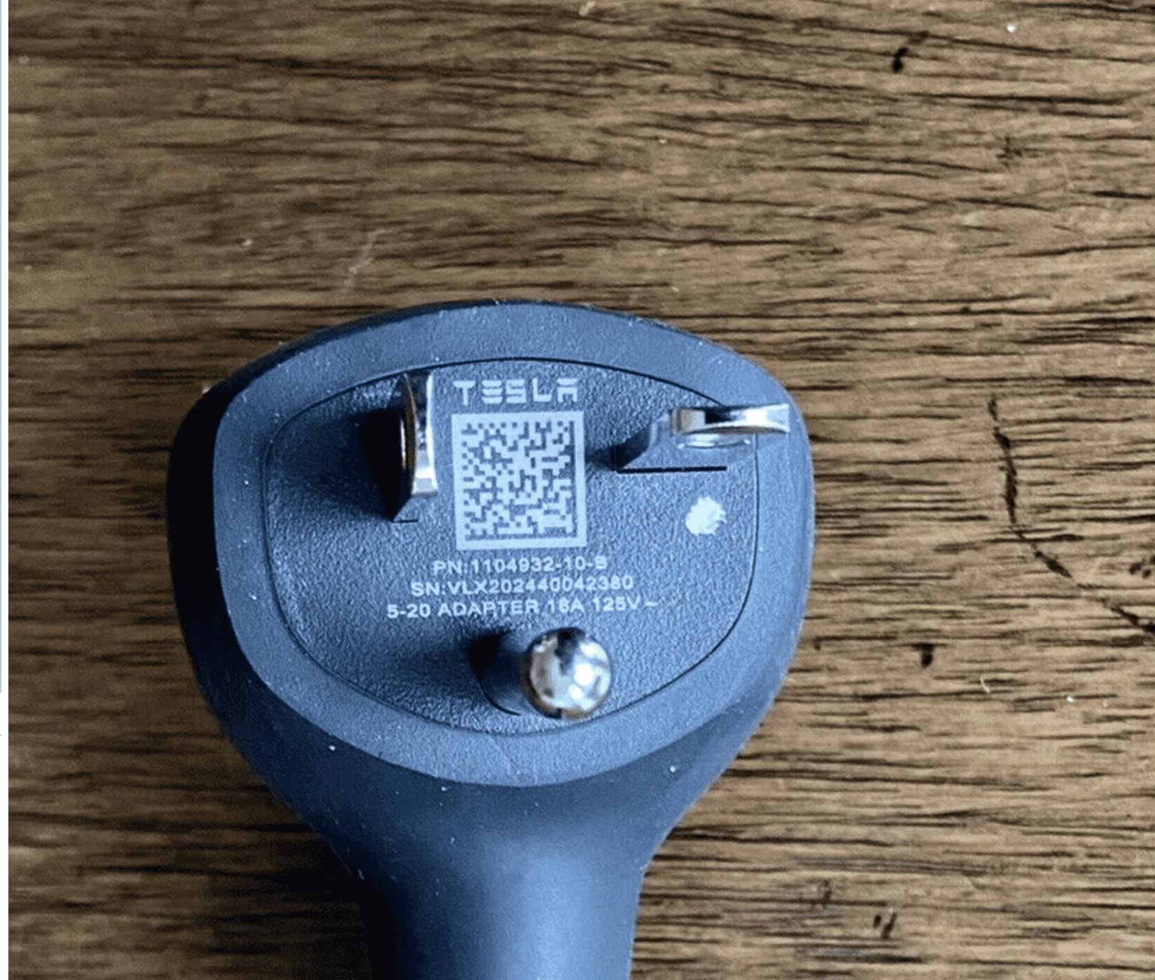

Fake news. 20amp is a different connector than 15amp. You would only be plugging in a 20 amp charger (NEMA 5-20) to a receptacle or extension cord rated for it because the plug wont fit in a standard 15 amp outlet.
Sort of. While I agree with you, it’s supposed to be that way…the plug for the EVSE that we have has a NEMA 5-15 plug, but will allow a draw of up to 16 amps. It claims UL listing…but I have my suspicions about this thing: https://a.co/d/5hlJdBC
Ideally, I’d like Ford to create a NEMA 5-20 plug for the Ford Mobile Charger (they’re already exchangeable) and then allow the 16amp output.
How many NEMA 5-20 outlets are installed in your house? Mine has zero - as I suspect most homes do - which means I'd have to install one to use a 16 amp charger. I could call an electrician to do it or I could watch a YouTube video and do it myself.
Now, I happen to know how to identify a 20 amp circuit and verify proper wiring but does a "reasonable person" know how to do those things? I don't know, but I do know that's going to be the first question on the jury instructions for the consumer protection trial.
I'm not saying a 16 amp charger isn't a reasonable thing to allow on an EV. I'm saying I can see why a giant company who gets sued a lot chose not to allow it.
Just because it is UL listed doesn't mean it's a good product. You shouldn't pull 16 amps continuously through a 15 amp rated receptacle.
I’m aware of the difference between a 15amp receptacle and a 20amp receptacle (although to be sure…plenty of people don’t). The particular outlet that is being utilized is a 20 amp circuit with appropriate outlet, wiring and CB.
You may be aware, but most people aren't. Having a 5-15 plug on that charger could be dangerous to a consumer that doesn't know any better.

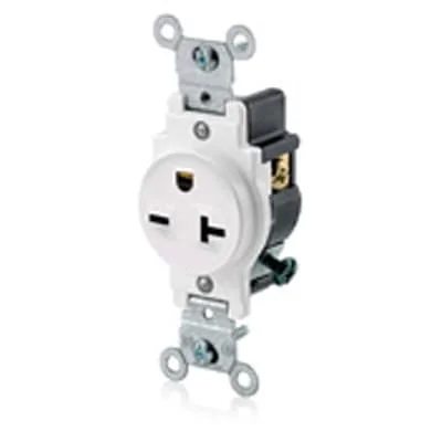

A 6-20P would only fit into a 20A outlet whereas a 5-15P can fit into both 15A and 20A outlets.
As far as I know, Ford is the only EV manufacturer that doesn't allow the user to modify how many amps the vehicle draws during charging. Even the little compliance cars from nearly ten years ago had that software option. Luckily this option can be added in via software in the future if Ford is willing to code it.
If 20A charging instead of 15A charging was the make or break point on using the vehicle, there are options to use two separate outlets, dryer outlets, and other kinds of tricks short of installing a new outlet.
I'm not sure what the employer/employee situation is here, small business, easy access to service panel, co-operative employer, etc. But, someone that knows what they are doing could probably quickly convert that into a 20A 240V circuit for 16A/3.8 kW charging. You'd make sure it is wired in at least 12 ga., install a 20A 240V breaker back at the panel, and a 6-20P where the 5-20P is now.
Bigger organization. Would likely need permission for any changes. I’ll check into that however.

I can confirm that he’s getting 16 amps from the 120V outlet…as this EVSE has a display that shows the output from the EVSE. When I plug in my truck to the same outlet with the same charger it displays 12amps.
Yes, 16A is possible on a 20A circuit.
For L1, I have a Duosida aftermarket travel charger that has a NEMA 5-20 that prevents being plugged into a common household 5-15.
The Duosida does draw 16A and does charge about 40% faster than the 12A version.
I can attest to the faster charge as we used that during the first year of my wife's PHEV.
Half my house has the 20A circuit shown below w/ corresponding 20A breakers:
