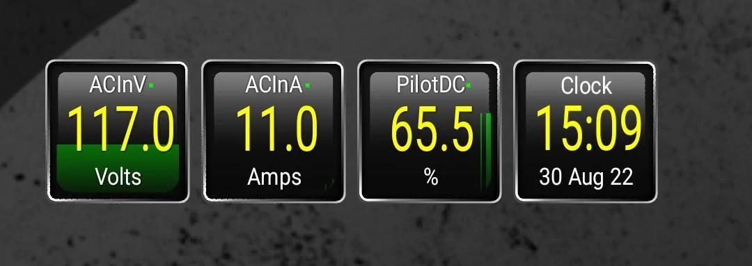

Here is your definitive answer: the truck will pull a maximum of 11 amps when connected to a 120V supply, no matter how much the EVSE advertises.
Note below the J1772 duty cycle is 65.5 pct (actually 65.6, but the car OBD output can only offer half-percent increments). That corresponds to 40A, which is the rating of the portable EVSE I'm using. I wired the 120V hot to a 14-50's A terminal and neutral to the 14-50's B terminal. You see the truck is only drawing 11 amps, single charger.
If I plug the same EVSE into a real 14-50 receptacle, the truck draws 40A.
So yes, it suffers from the same early code problem Tesla did, where it doesn't believe the EVSE if there is only 120V present.
Ford F-150 Lightning Portable EVSE Amps over 110v/120v Screenshot_20220830-150917_Torque
3,857
5,013
A bit disappointing, but not unexpected.

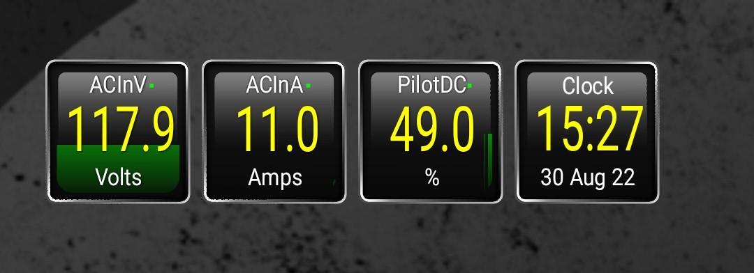

Here is the FMC doing same thing BTW (note 49 pct duty cycle, 49 x 0.6A = 29.4A):
Ford F-150 Lightning Portable EVSE Amps over 110v/120v Screenshot_20220830-152729_Torque
3,857
5,013
Let me clarify a bit... this is what happens if you advertise 30A or 40A to the truck. I don't have the right gear to easily advertise 24A or 16A to the truck, because my original Tesla gear was lost in an accident. It may allow higher current if you advertise 16A or 24A, but at 30A and higher, it stops at 11A.
Based on your findings, plus what @DiveMan911 experienced, it’s likely limited to 11A in all cases.

FlasherZ
Mar 10, 2022
915
1,025
St. Louis Metro
I think they're being quite literal with the J1772 spec on current. 120V isn't included in level 2, and the specification notes maximum 120V charging (level 1) at 12A or 16A, and looks like Ford just decided 11 was ok for everyone. Some manufacturers (including Tesla, in my experience) extended their support to pay attention to level 2 signals even when on 120V, but Ford has not.
