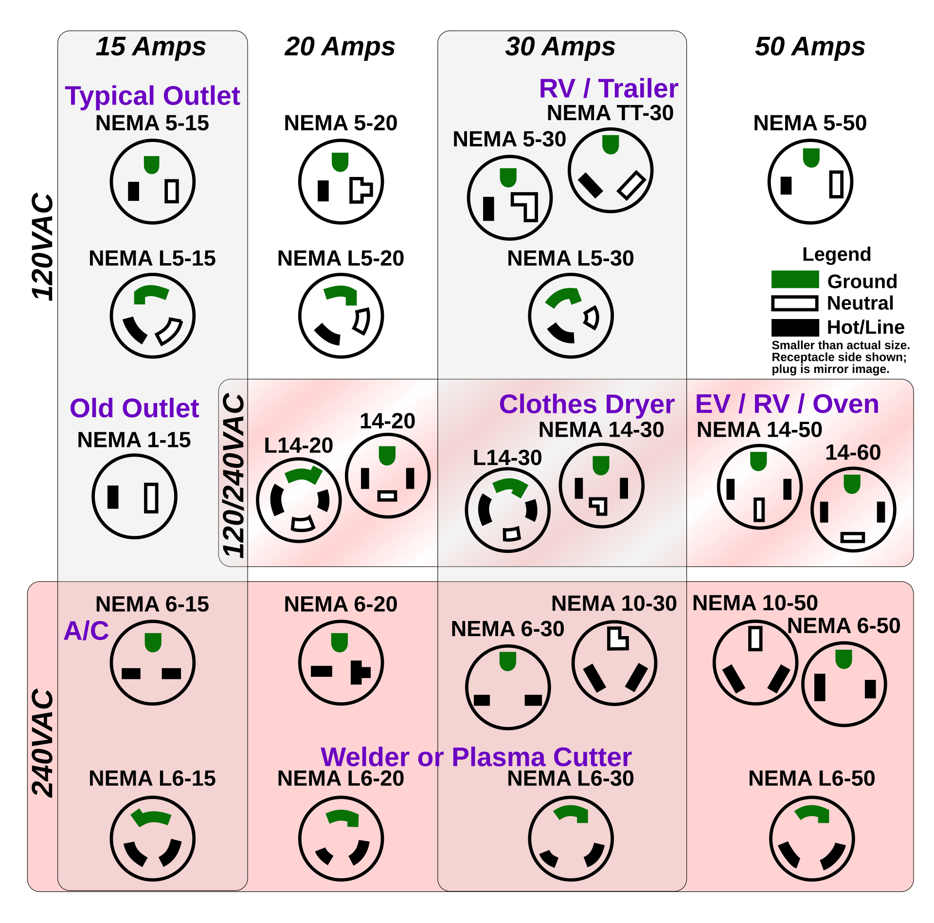

Which would work for a 120v connect. @ minimum they would need 10-3 for a 240v connect. 2 lines, neutral and a ground.
Most hard-wired EVSEs do not require a neutral. You can use 10-2 to connect those.
There are also several 240v NEMA outlets that do not require a neutral and could be installed with 10-2, such as NEMA 6-30 and NEMA 10-30.
There are also several NEMA outlets that do not require a neutral and could be installed with 10-2, such as NEMA 6-30 and NEMA 10-30.
