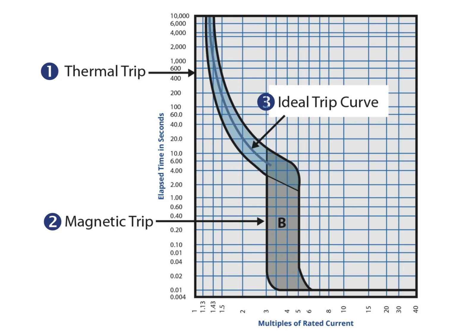

I suppose, but in reality that situation is just going to cause a breaker to trip (as long as the wiring is code), right? If that is Ford's official response that they won't change it at some point I will be disappointed.
Not instantly. Excess current could flow long enough to cause excessive heating especially if the wiring is older or an extension cord is used. It’s code to install 15A receptacles on a 20A circuit, and a breaker will carry 25% over current for a long time.

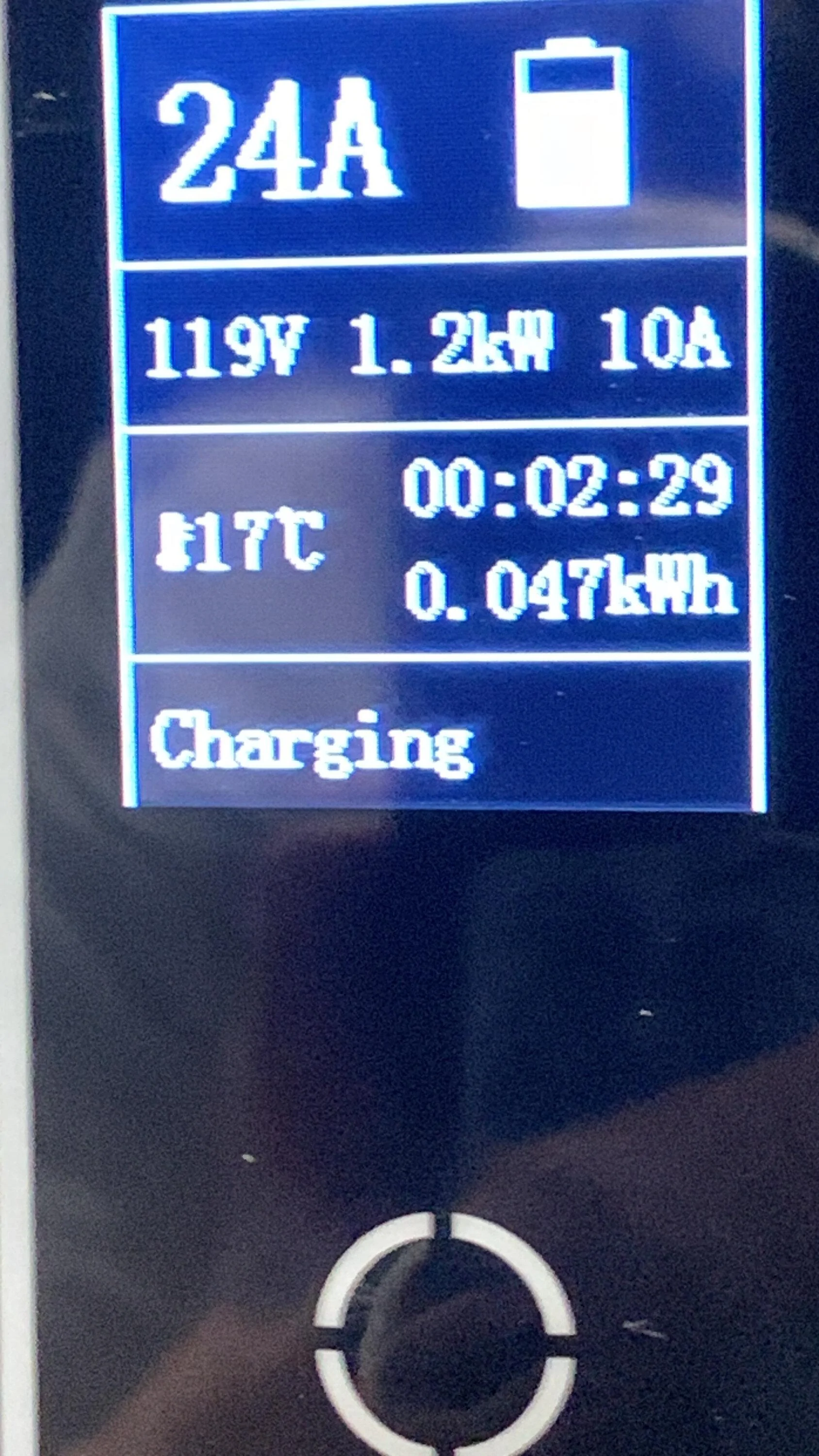

This is what I see on my adjustable EVSE on 120V, no matter what I set it to.
Add me to the list of people who would like to see a firmware update to the on-board charger to allow for higher current 120V charging. I hope to never need it, but I bought an adjustable EVSE and built the adapters to allow for it as a potential use-case.
Yep, this was well documented/posted by other members of the Forum just after the first deliveries this summer. ~1.2 kWh is best your going to get on a 120V circuit regardless of amperage…it stopped me from upgrading from my FMC until @Ford Motor Company changes the firmware….if it’s not a hardware restriction….?
