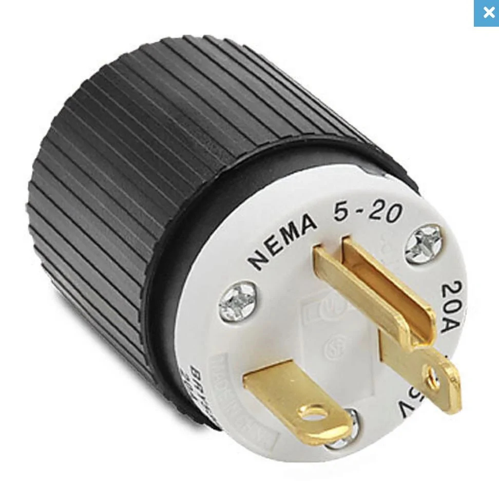

What plug does your EVSE have? In order to be (properly) rated to deliver 16A on a 20A circuit, it needs to have a 20A plug.
NEMA 5-15 plug, not a NEMA 5-20.
I’m feeling a little sheepish…I honestly didn’t know about the 5-20 plug.
So, that begs the following:
Would a 5-20 plug allow that extra amperage? (To be clear, it doesn’t seem like a smart idea…nor do I intend to do this…I’m speaking hypothetically)
Does the truck limit the amperage (at 120v)?
And/or is this charger offering something it can’t (or shouldn’t) do?

No. Nothing about the circuit feeding the EVSE (breaker, wire size, receptacle, plug, etc) can limit the charge current. I don’t know if the Lightning limits 120V charging to 12A or not. It’s possible.
You didn’t mention make/model of your EVSE, so I can’t speculate on your last question.
