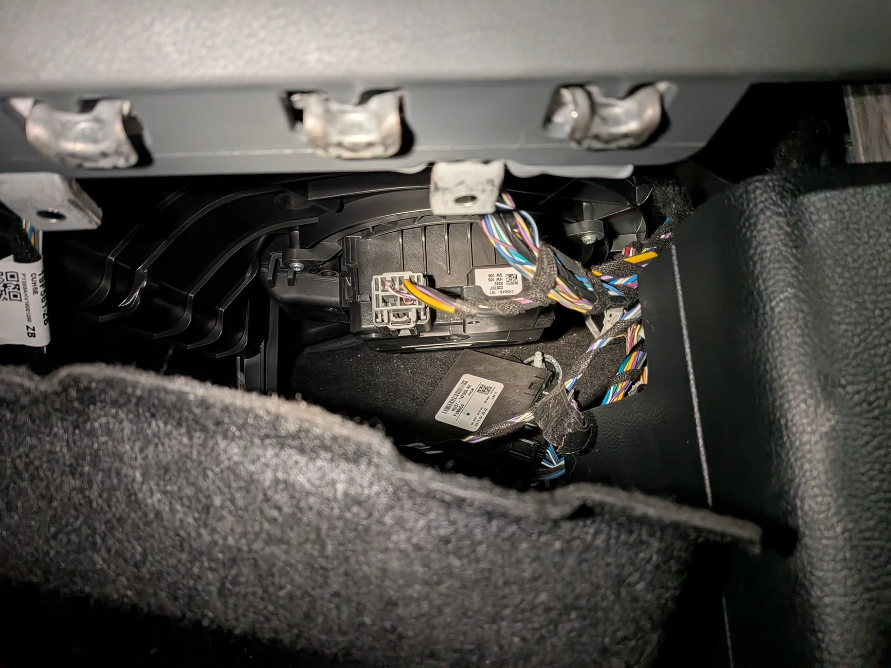

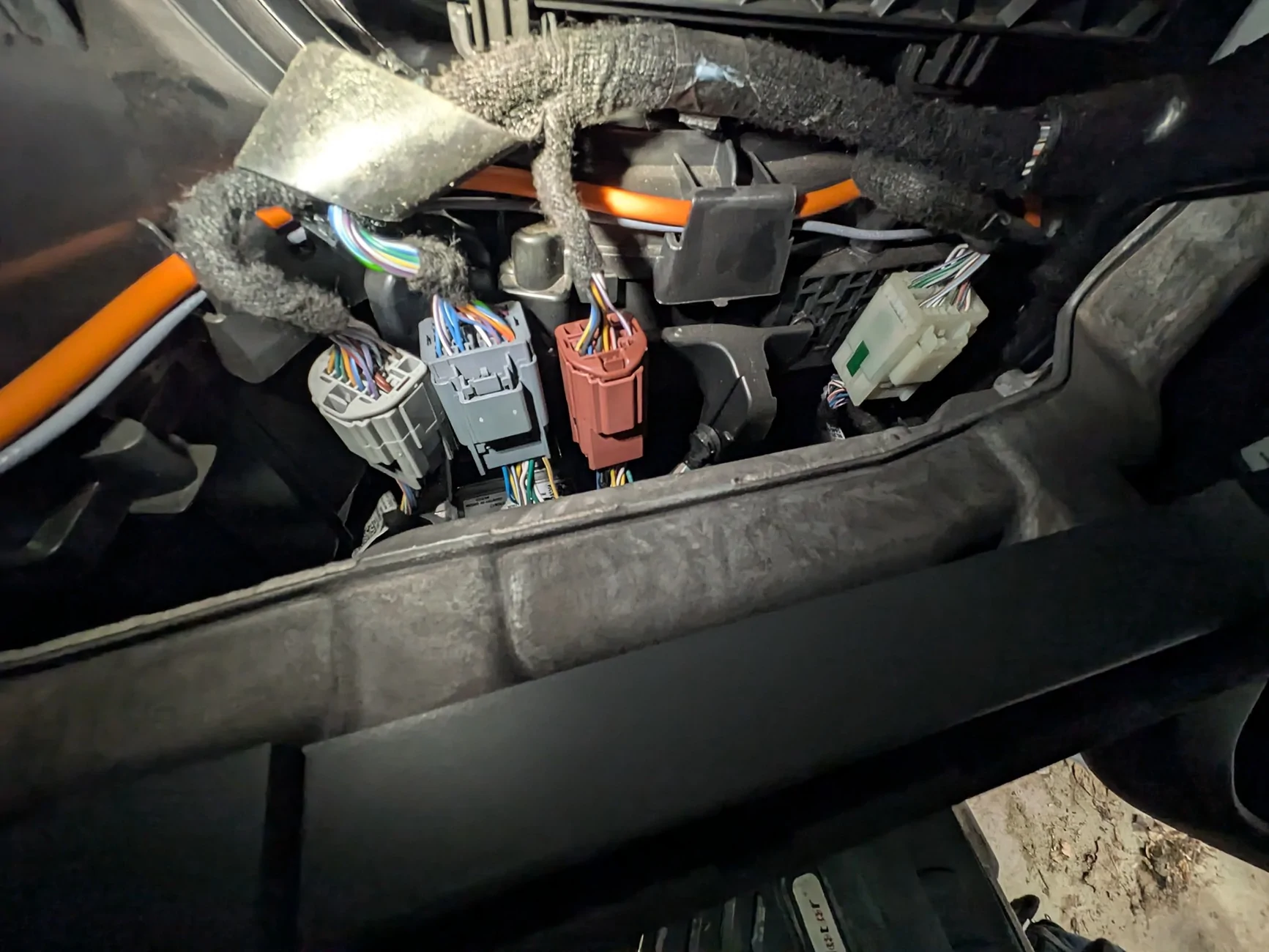

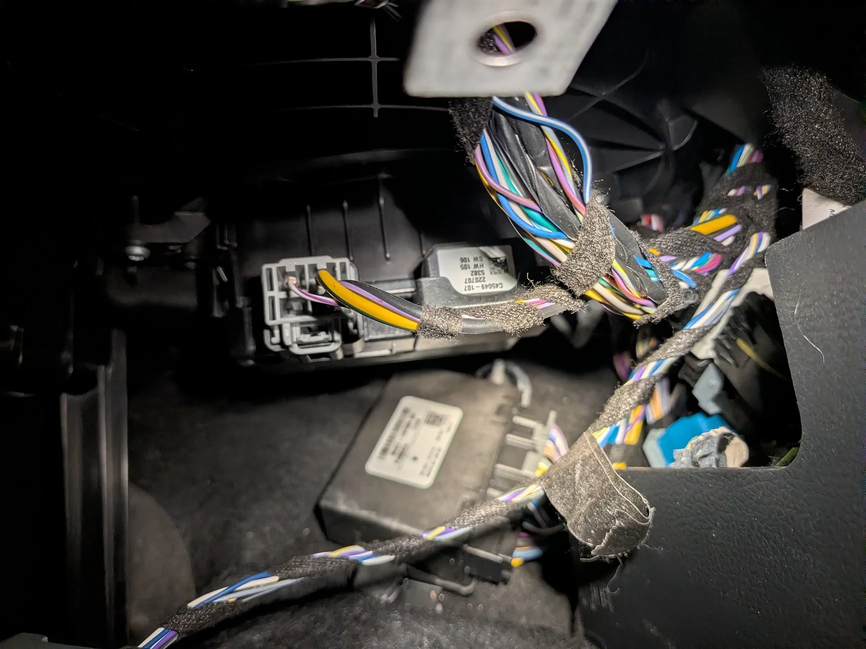

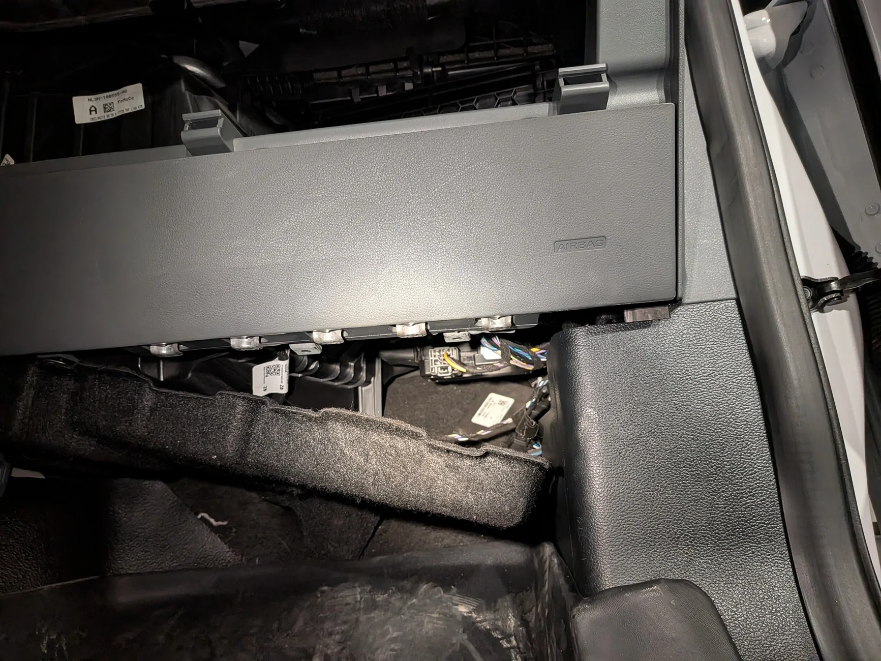

Sorry it's taken a while for an update. I've been pointedly ignoring the truck since I got it back. I've driven it exactly once... To go look at a potential replacement vehicle...
The bill in the end was around $2,700. Much less than the total paid by others prior to my ownership. Ford explicitly told me that side is almost all "diagnostics" they wouldn't have covered anything even if I was still bumper to bumper. The dealership told me the real story is I don't have a high enough customer loyalty score for them to justify covering the cost. Either answer is pretty gross for a clear manufacturing defect.

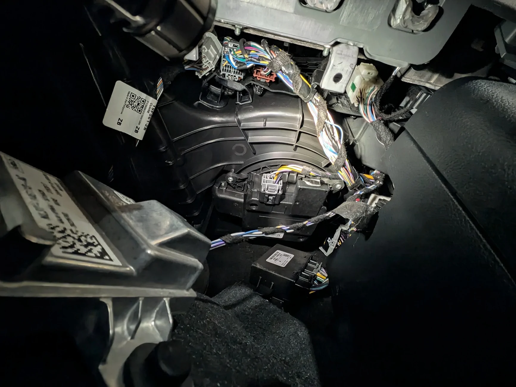

For future owners, dealers, and mechanics, I'll try to detail where I *think* the repair was made. I didn't dig deeply, but find what appears to be a repair with electrical tape (shrink tube would have been better, but whatever). It's under the glove box, towards the door. Access is through the carpet kick panel below the glove box. You can orient yourself by removing the glovebox first and finding the bank of 3 + 1 connectors. It's immediately below that. Just remove the carpet panel (three push in trim fasteners) and look up. It would be pretty easy to zip tie away or add an insulting material if it's rubbing. I'll try to add photos.
Ford F-150 Lightning 2022 Pro ER System Shutdown While Driving: Pending fix #48 PXL_20260203_032704214
Ford F-150 Lightning 2022 Pro ER System Shutdown While Driving: Pending fix #48 PXL_20260203_032449283.MP
Ford F-150 Lightning 2022 Pro ER System Shutdown While Driving: Pending fix #48 PXL_20260203_032458493
Ford F-150 Lightning 2022 Pro ER System Shutdown While Driving: Pending fix #48 PXL_20260203_032504323
Ford F-150 Lightning 2022 Pro ER System Shutdown While Driving: Pending fix #48 PXL_20260203_032536575

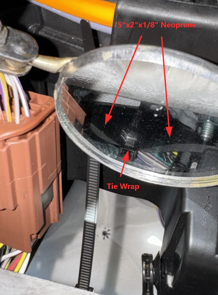

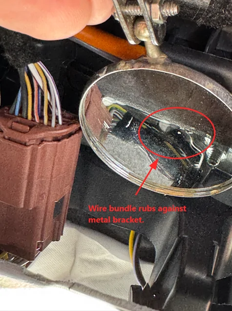

Here is some additional information on this wire rub issue. After removing the glove box today, I found a wire rub on the wiring bundle with the brown connector about 2" to 3" below the connector. The rub is located between the connector and the dropped down carpet kick panel. I could not see the rub, but I could feel it with my hand by following the wiring bundle down below the brown connector. The wiring bundle is pressed hard against a metal bracket. There are also 2 bolts left and right of the rub point that are very close to this same wiring bundle. I installed a 5" x 2" x 1/8" piece of neoprene rubber between the wiring bundle and the metal bracket at the rub point. I placed the 5" length horizontally along the wiring bundle to also cover the 2 protruding bolts of concern. I then installed a tie wrap snugly around the neoprene to keep it in place on the wiring bundle. I have attached 2 photographs to show the approximate location of the wiring bundle rub, and the placement of the neoprene isolator. Note that the photos are reflected views in an inspection mirror.
@Ford Motor Company, you need to expeditiously investigate and remedy this issue since it is likely present on many of our vehicles. It would be much better to implement a preventive measure, versus stranding owners and passengers on the roadways.
I am also filing a NHTSA Safety Complaint since the OP reported "(traction/stability control, cross traffic alert, blind spot alert, powertrain malfunction, etc) with total power cut".
Ford F-150 Lightning 2022 Pro ER System Shutdown While Driving: Pending fix #48 Wire Bundle Rub Point
Ford F-150 Lightning 2022 Pro ER System Shutdown While Driving: Pending fix #48 Wire Bundle Neoprene Isolator

Very good addition to this thread. Thank you and I'm glad you were able to catch it early.

My task for tomorrow!
Thanks for the pictures - bummer about what it cost for the repair - that's some expensive electrical tape!

Regarding electrical tape ... 2 or 3 pieces of loose electrical tape about 2" long fell off the top of the kick panel when I removed it. @Ford Motor Company, I sure hope they were used for temporary installation purposes.
