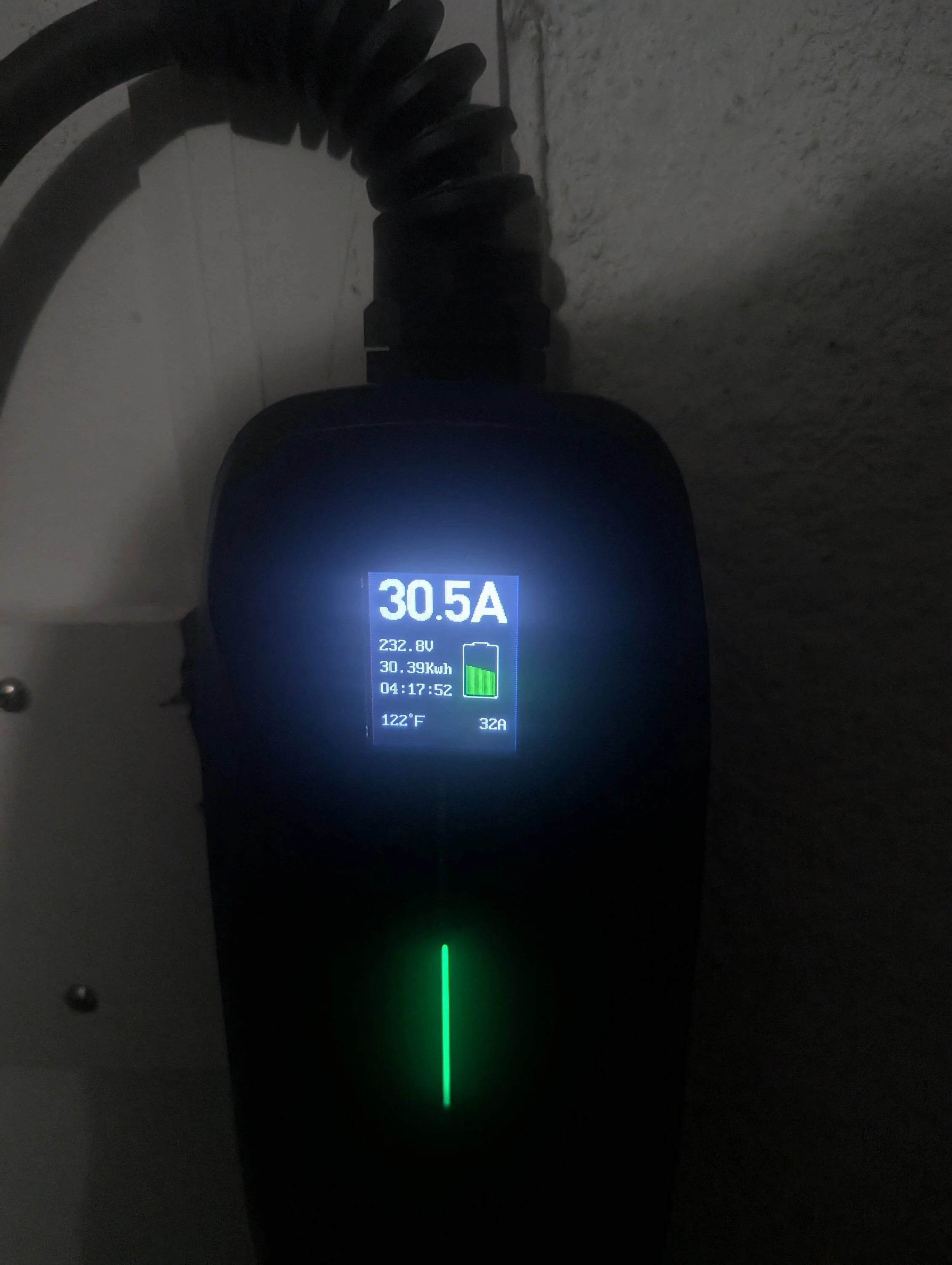

thanks Brons2. my EVSE (in the pic) was also a Amazon cheapie bought in 2020 for our PHEV Pacifica. The cheapie HD 14-50R outlet lasted 3 years before melting.
With the Lightning needing longer charging and up to the max 32A the EVSE is able to provide, I changed the cheapie outlet for the Bryant, but I guess I need to replace the romex as well and maybe the breaker - here in Florida its hot and humid, the circuit breaker panel inside the garage is showing signs of corrosion on the bus bars (where the breaker connection is seated. Perhaps I need to turn off the main and lightly sand the bus bars prior to installing a new breaker and wiring - but I must be getting old it was tough running the wire into the receptacle box and connecting the Bryant 14-50R and then getting the receptacle into the box once connected.
Sanding could/would create pitting which is a bad thing for electrical connections.
There is contact cleaner you can use if needed.
However, you should use a weather tight panel in your area of high humidity.
BTW, overheating can be mistaken for corrosion, both can caused a 'brown' discoloration of plastic parts in outlets in my experience. Of course corrosion can cause hot spots and overheating.
