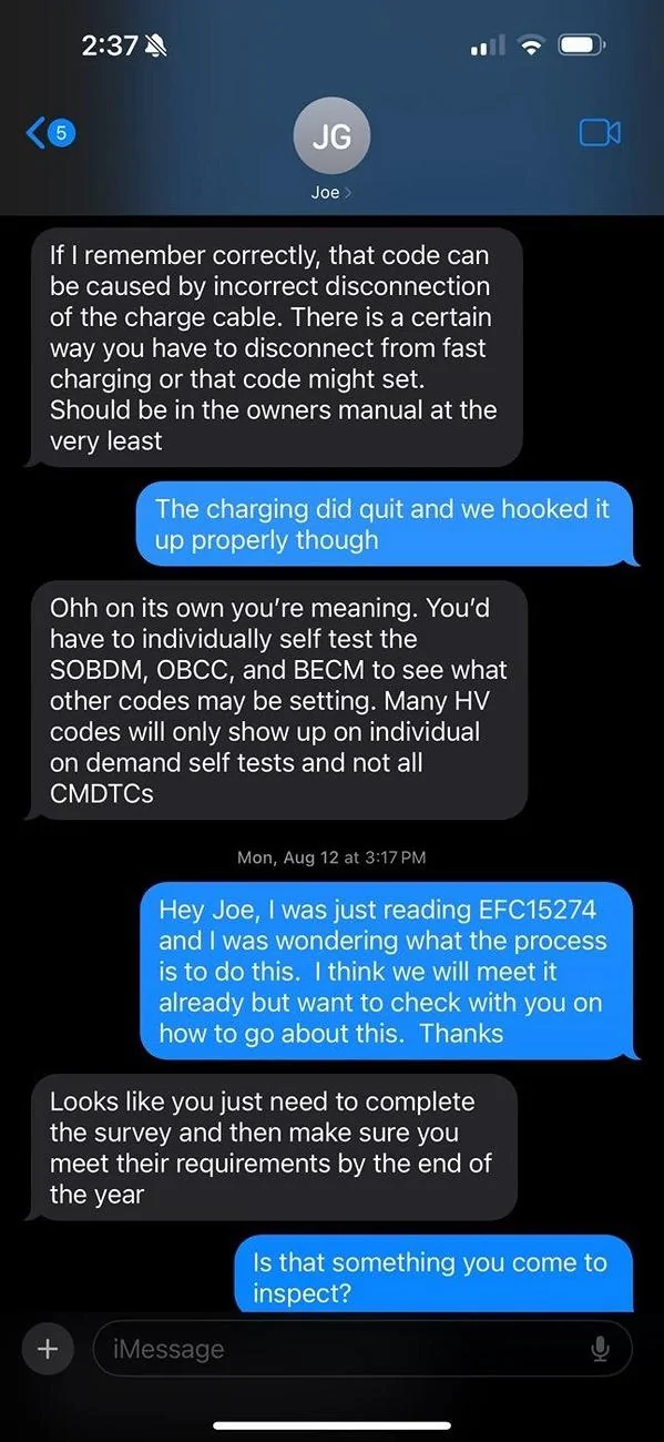

We are the new owner of the 24 Flash that he is referring to above that cannot DC fast charge. Some context: We install EV chargers, solar and battery backup off-grid systems for clients and this is our 6th EV so we are not new to EVs or chargers.
We were on a trip down to southern Wisconsin and on our way back home needed a bit of electrons to get us back to our shop. Tried 3 DC fast chargers at different locations and each one tripped out within 5 min. Thankfully we were able to get enough to get home in those 3 attempts. We have tested 8 other charging stations in different locations to rule out the chargers. Each charger if over 74kw will eventually within 2 - 10 minutes fault the charger stating the truck is overheating. The cable gets extremely hot and then faults out the charger.
Level 2 charging works just fine along with the rest of the truck.
Called Ford directly and they said they have a TSB out on our truck so I scheduled the truck to go in 2 weeks ago. The truck faulted out for the service tech and on the dealership charger. Ford told the tech they don't have a fix and they will get back to them. Tech told me they would call me in a couple of days to see what the engineers at Ford say. I did not hear back so I have been calling them every few days with no response until today finally.
The dealership sent the attached screenshot. We have an appointment for next Tuesday to have them read out the modules listed in the text.
Just looking for insight if anyone else is having a similar or the same issue.
