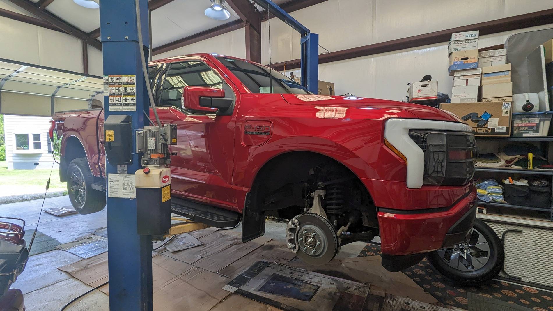

I have had mine up on my lift for tire rotation. I pull forward so the lift arms can reach the arrows on the frame designated as lift points. Attached is a pic that will give you an idea.
-Jeff
