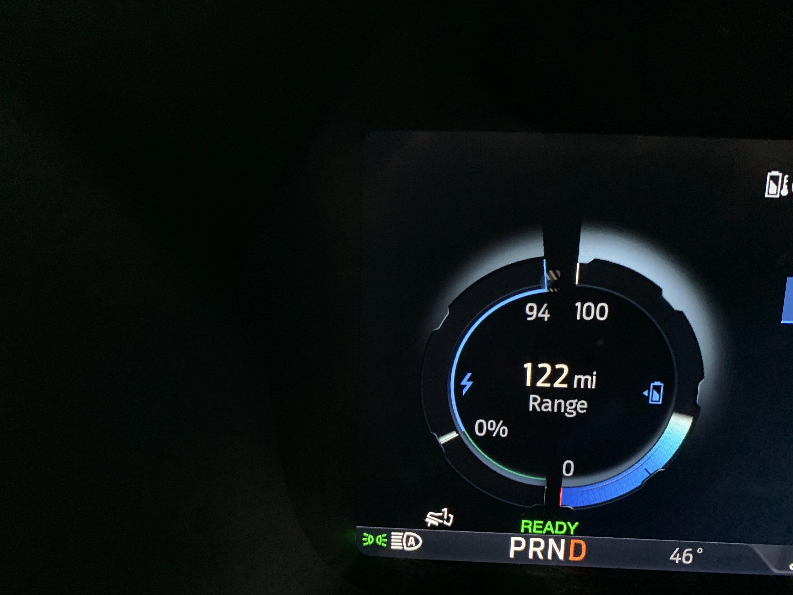

Battery level shows 94% what does this mean? Does it mean that my battery has degraded to 94%.

That is available motor power, not battery percentage.
Think of it this way, if flooring your accelerator is 100%, currently you can only get 94% of your power if you floor it. The truck typically does this when there are temperature issues. If you have a more severe degradation (below 60%) and it never goes back up, then you may have a battery/motor issue.

As said above this is common in cool conditions, your trucks current SOC is showing under 50%
