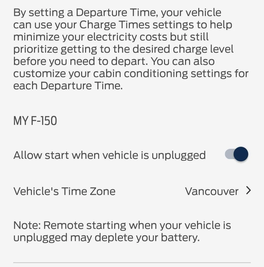

Mine is working. Haven't tried with heat or cooling yet.
Did you try with setting to allow if unplugged?

Working! I went through the setting again and just toggled them off and on again. I did not see any errors in the settings though. I only changed the allow the remote start button to "on".
I ended up not plugged-in last night and lo and behold, my truck was pre-warmed. Really not sure what happened. Tonight, I'll be "plugged in" and I'll see if it works that way too, as it should. :unsure:
