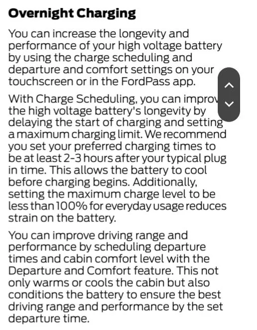

I would think that 'pre conditioning' has nothing to do with whether the vehicle is plugged in or not... pre conditioning is to turn on either heat or air conditioning, etc., to get it ready for you to use, comfortably, but not so much for the 'battery' conditioning... and should work just the same to 'pre condition' the cab for when you leave work, etc., when the truck would not be plugged in.
I think Tesla uses 'pre-conditioning' for the BATTERY when it knows you are close to arriving at a SUPERCHARGER, for better battery charging... which might be confused with 'cab' pre conditioning.
From the owners manual.

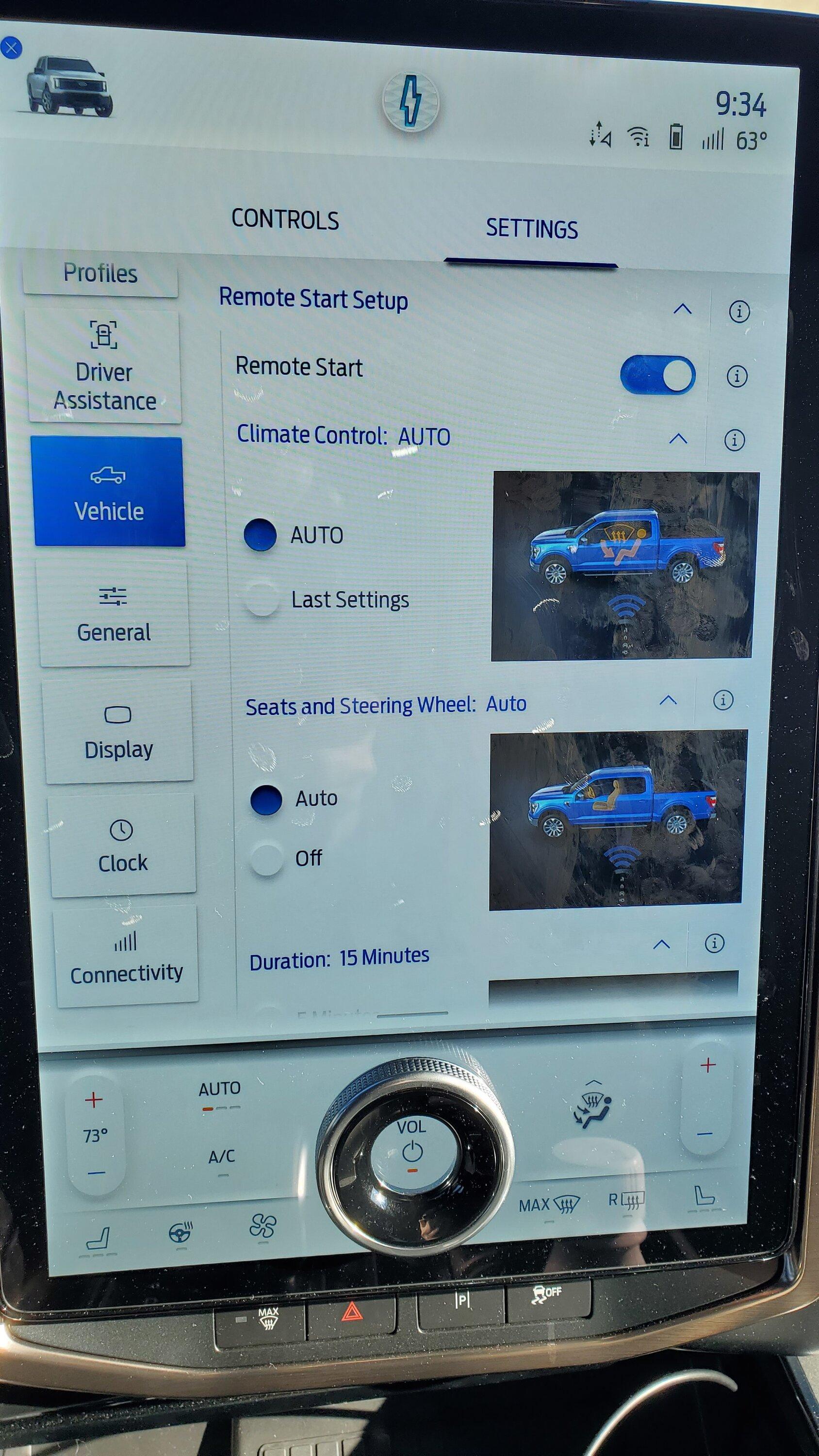

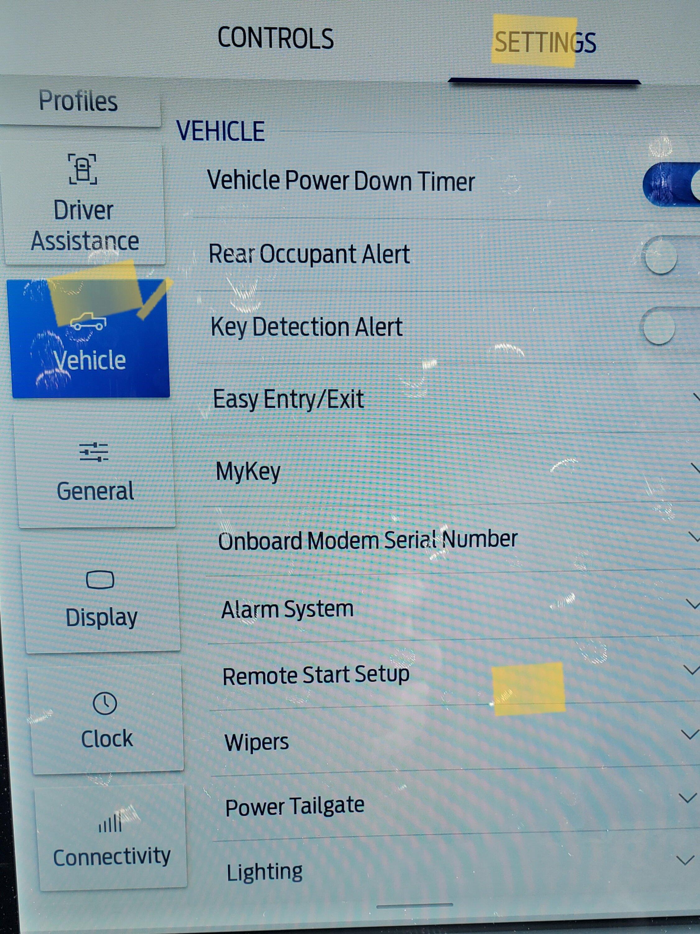

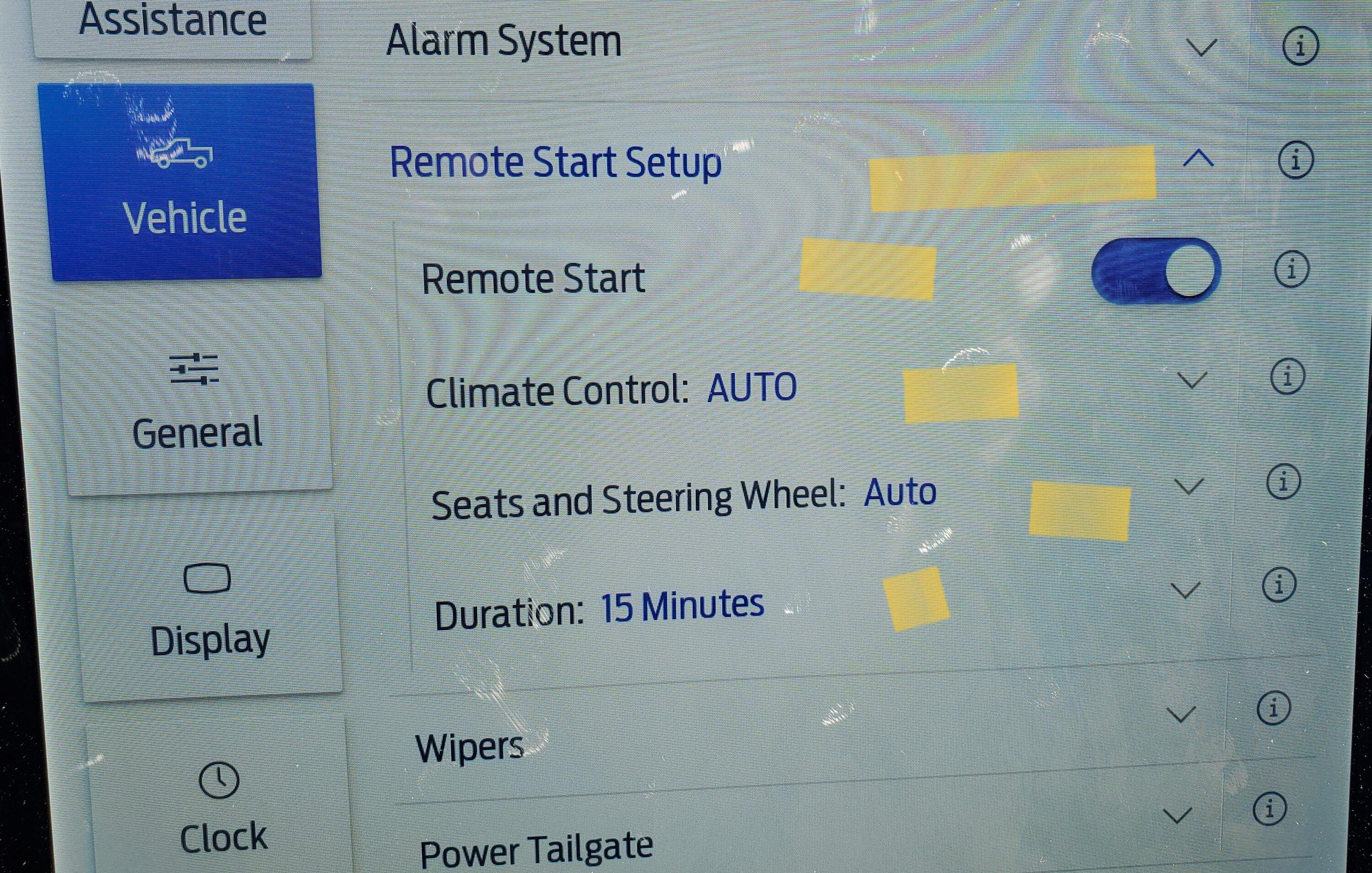

While setting up departure times make sure you selected cool, medium or warm features, if that doesn't work try, going to settings, remote start, adjust these selections to on and auto. & 15 minutes, maybe remote start and departure use same settings.

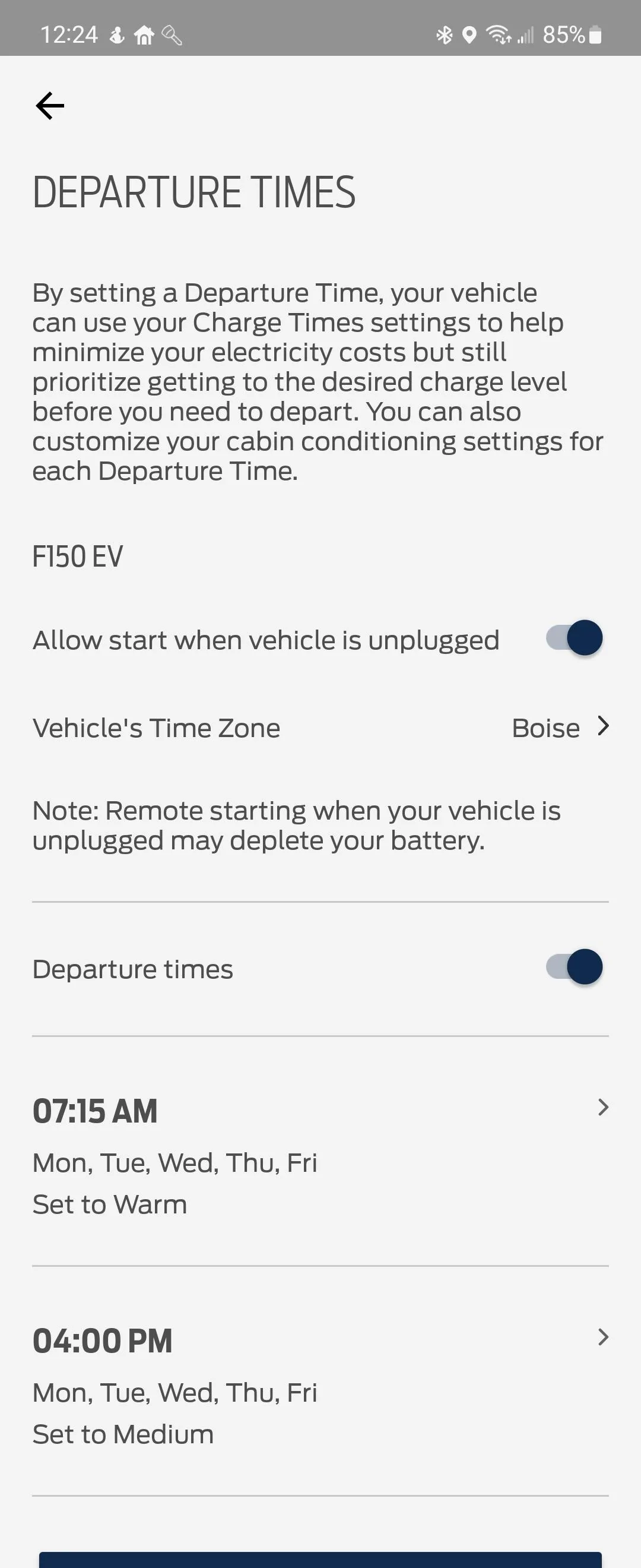

Is the truck plugged in, I think it needs to be for that?
There is a setting that allows pre-conditioning even if the truck is not plugged in. I use it every day.
Can you point me to that setting? Mine was unplugged this morning and I was surprised it didn't warm the cabin. Maybe I missed that!
On phone app. under "charge settings" See below...
