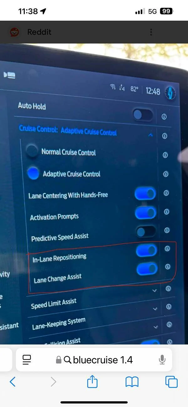

I was looking for a way see if BC 1.4 was installed on my truck and found this picture; it looks BC 1.4 adds the In Lane Repositioning and the Lane Change Assist options. My settings menu still doesn’t have these options.
For some reason...I don't know why...they sent an OTA out that updated the IPMA/PSCM with the necessary software to provide the BC 1.4 functionality, but have yet to send an APIM update out that adds those toggles you see in that picture. Maybe the APIM update will show up next week or the week after.
It is likely that whoever took that picture used FORSCAN to add the toggles to the menu. I have done that myself.

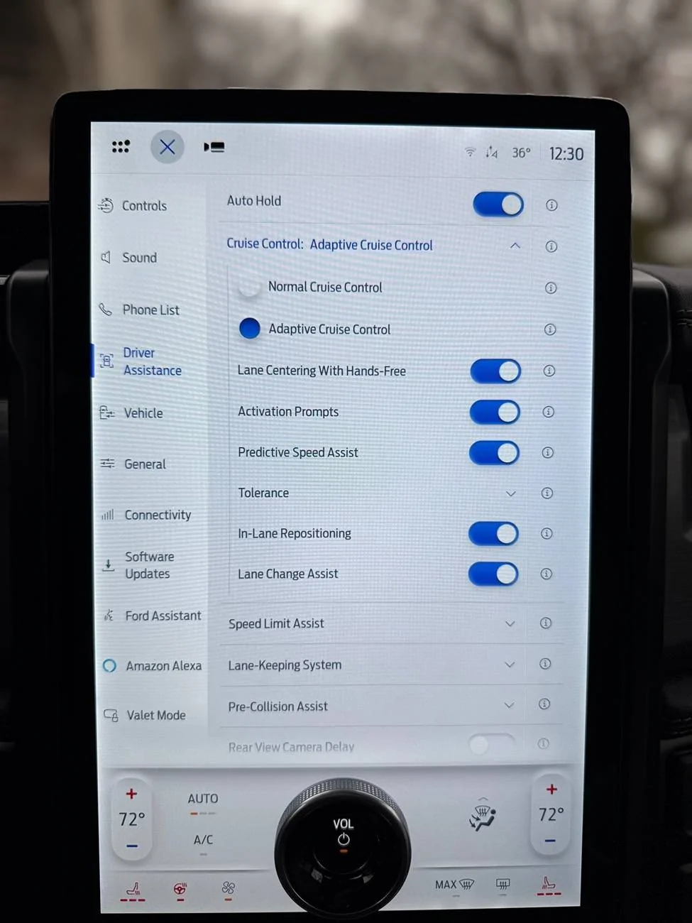

I just leased a 2024 Flash at the end of November. I haven't had any OTA software updates as of today and haven't done anything to modify my truck, but I have both of those settings (In-Lane Repositioning and Lane Change Assist). Does that mean mine came with BC 1.4? I wish there was a easier way to tell...

Do you have the lane change animation..or just a text announcement when it happens?
Nah, Ford needs to release a new IPC updates for the 21-23 trucks to get the pretty animations the Mach E has.

Anyone that got this OTA can turn buttons on by making the following FORScan changes:
7D0-09-05
xxxx xxEx 2x--
7D0-10-02
xxxx xxxx 1x--
Note: This will NOT enable the features themselves. This will ONLY work if you got the 1.4 OTA update.
