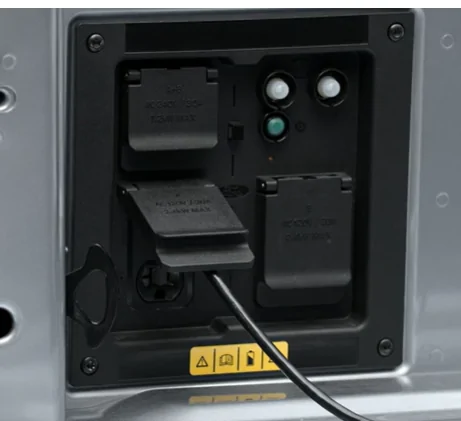

Look at the port in the bed, look for a 240v outlet, then you'll know that unit has the full 9.6kw system the bed has 7.2kw and the Frunk/cabin are 2.4kw.
If all you see is four 120v outlets' then the truck only has 2.4kw system

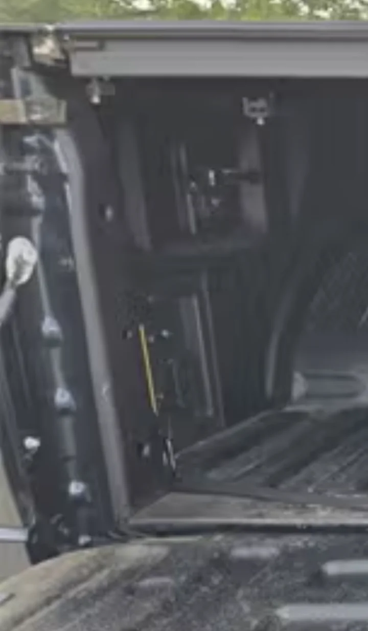

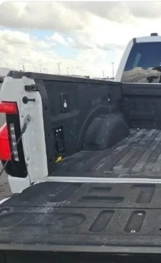

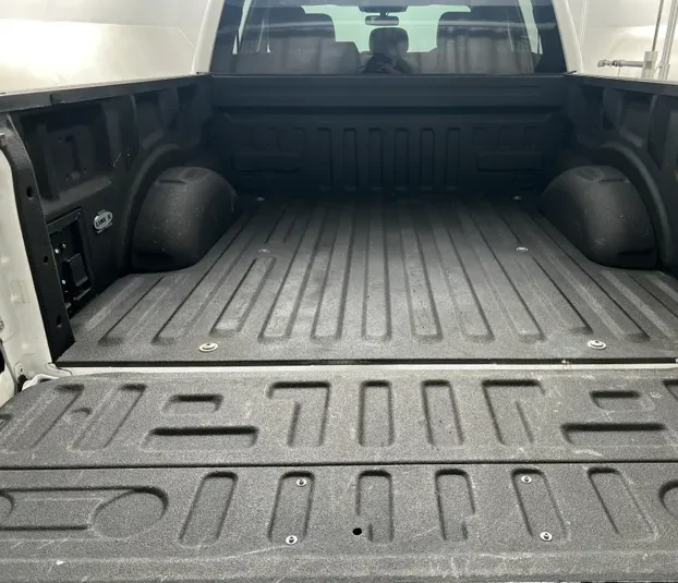

3 trucks so far. First 2 are listed as Pros 3rd one is not. Well. It is a thing.

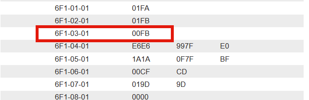

Here is something you can try that may work for you. It only seems to work for 2023 and newer. Go to the Motorcraft As-built site and enter the VIN. On the results, scroll down a few lines to 6F1-03-01.
Ford F-150 Lightning Buying used- How to ID Pro power? 1763342231138-6
This is the DC-AC Inverter module section. You will see one of two values:
00FB - has 9.6 kW PPOB
01FC - does not have 9.6 kW PPOB
I tested this on my sample of 100 VINS and it held up except for 2022 where all trucks show 00FB.
Verify with dealer or picture before buying.

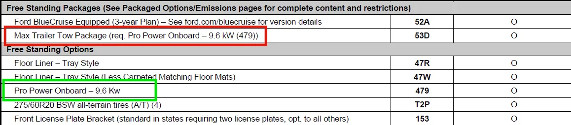

HUKAQ is the sales code for twin inverter.
I believe in 24 to have the 9.6 you had to get the Max tow package. I could be off on the but its what I remember
2,805
3,986
Close! It's actually the opposite - MaxTow requires 9.6.
You can get 9.6 by itself.
