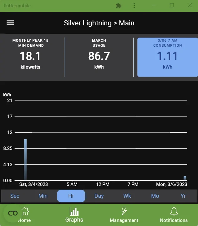

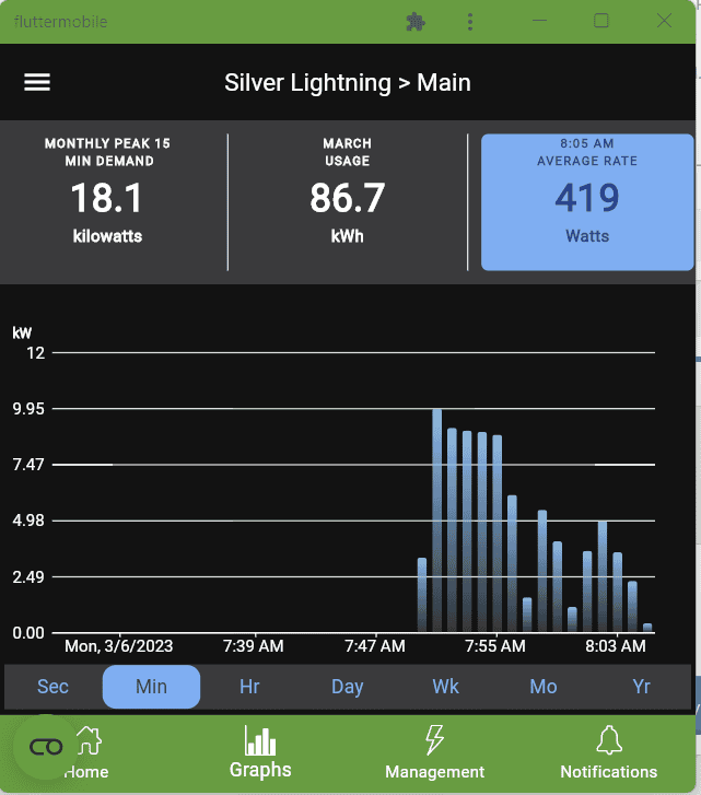

The PTC draws upwards of 10KW then tapers based on battery and cabin conditions
Ford F-150 Lightning Can you precondition on Chargepoint, Flo or Emporia or only on Ford Charge Station Pro? 1678245188468
This was a Remote start session only to warm the cabin, the profile for battery warming in colder conditions peaks longer at the start then tapers, it then spikes later ~15 minutes prior to actual departure time, then tapers and modulates for another 15 minutes after departure time.
Ford F-150 Lightning Can you precondition on Chargepoint, Flo or Emporia or only on Ford Charge Station Pro? 1678245401327
Cumulative energy consumed to warm the cabin was 1.1 kWh or in my market 27 cents of shore power or 1.9 miles of lost range had I pre-warmed the truck without shore power @ [1.7 mpk]
